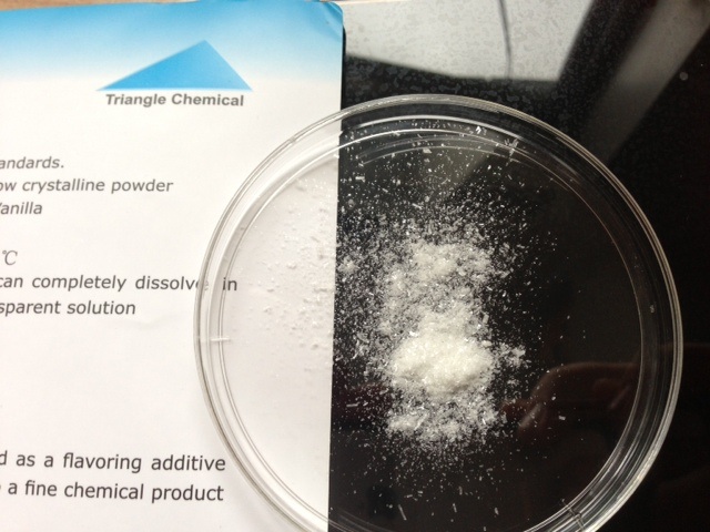

Thanks for that, it's obvious at this point that I was screwed ( not intentionally) by this seller. What a pity that I left good feedback before doing experiments with it. This stuff makes a yellow solution in alcohol, does not dissolve completely and the yellow portion is cloudy. I didn't even bother to take a MP with this dumb stuff.... I'm currently trying to figure out how to resolve this with the seller. They offered to have me send it back and then determine a refund amount but for the amount I paid, it seems rather ridiculous to go through all that trouble. I really didn't feel like buying it through my usual supplier since it is very expensive (buying through work = Aldrich pricing...100g is about 60$)

Well, after threatening to open a dispute with eBay as they were not providing me with the composition of the said "vanillin" they refunded the purchase and let me keep it. I threw it away... Not going to start using it for cooking if I don't even know what's in it! Finally managed to get my hands on some proper vanillin, tested by MP, from an eBay seller called Triangle Chemical.
image.jpg - 101kB

I am glad you straightened that out with the seller in a way. At least now he will recognize that the last shipment "vanillin" wont pass with all his costumers, and it has cost him a bit of money already, so I am sure they will be more thorough in the future about quality and proper labeling.
Glad you got what you where after too. I know it is a bummer to order something, wait and wait excitedly for it, only to have it be a disappointment. I have ordered on different occasions, and from different suppliers 2 30cm Graham condensers, and both times the inner coil was cracked or broken off, rendering it useless. I got a replacement in one instance, and a refund in the other. Both after sending pictures and jumping through hoops. Grrr.
