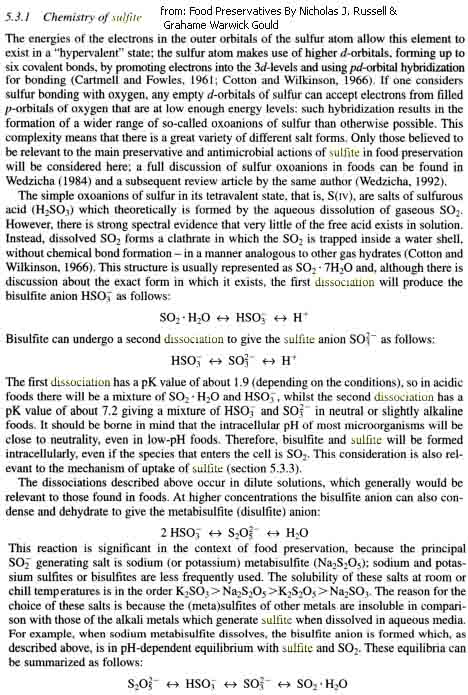

Does sodium/potassium metabisulfite degrade over time (say, 2-3 years), releasing SO2 and leaving behind the sulfite? I have a bank of K2S2O5 that has gotten quite lumpy and hard to dissolve in water.
Also, S2O5 + H2O -> 2HSO3 in solutions. Does any other anion, other than the bisulfite, exist in aqueous solution? I'll be buying new metabisulfite, but I wonder if it's also worthwhile to get what is sold as bisulfite (how can it be a dry powder?).

at Nickdul
dissoc_2.jpg - 89kB
