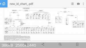

Can anyone tell me,
What is a quick reliable easy method to differentiate between hdpe and PTFE ?
(I have no fluorine compounds, but many common solvents)

[*] posted on 16-11-2017 at 10:11
Based on their densities, I imagine PTFE would sink in water while HDPE floats.

[*] posted on 16-11-2017 at 10:12
Shave a small sliver of the plastic off, hold it in a lighter flame. HDPE will easily melt and then burns like parafin with a smell like a wax candle.
PTFE does not burn in air, it will just degrade and smells quite different. Don't sniff too deeply or often of overheated Teflon.

Thanks for the quick responses,
Today a workmate gave me a 1" 24" x24" slab of white plastic that he thought may be ptfe,
I just tested it and unfortunately it burns nicely with a blue flame, dripping screaming blobs of molten plastic :(
Almost certainly hdpe/uhmwpe, which is still useful.
EDIT: Sorry Bert, this post was before yours, but I tried to edit it and messed up so posted it again, by which time you posted the above ... .
I use hdpe quite a lot for stupid-high-voltage stuff, almost perfect - until it melts.
