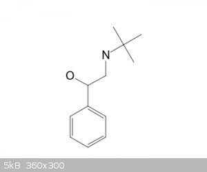

[*] posted on 18-8-2022 at 05:39
i want to nitrate this compound....being that the group is large and its an o,p directional i will get the p position.....my concern is if there will be any reaction with my side chain exposed to the sulfuric and nitric acid used to place the nitro group....i.e esterification of the alcohol function ...and it might affect the direction of the nitro placement...?........solo
3LSx1Um4KrK.png - 5kB
Posts: 2900
[*] posted on 18-8-2022 at 09:14
I guess you will eliminate water forming an alkene before forming an ester. I wouldn't worry about forming an ester as it would probably not effect direction of the nitration too much and it would be reversible.
[Edited on 18-8-2022 by Tsjerk]

[*] posted on 18-8-2022 at 10:14
......thanks i though of making the nitronium ion first with sulfuric acid and nitric acid then add to my compound with some cooling...solo
