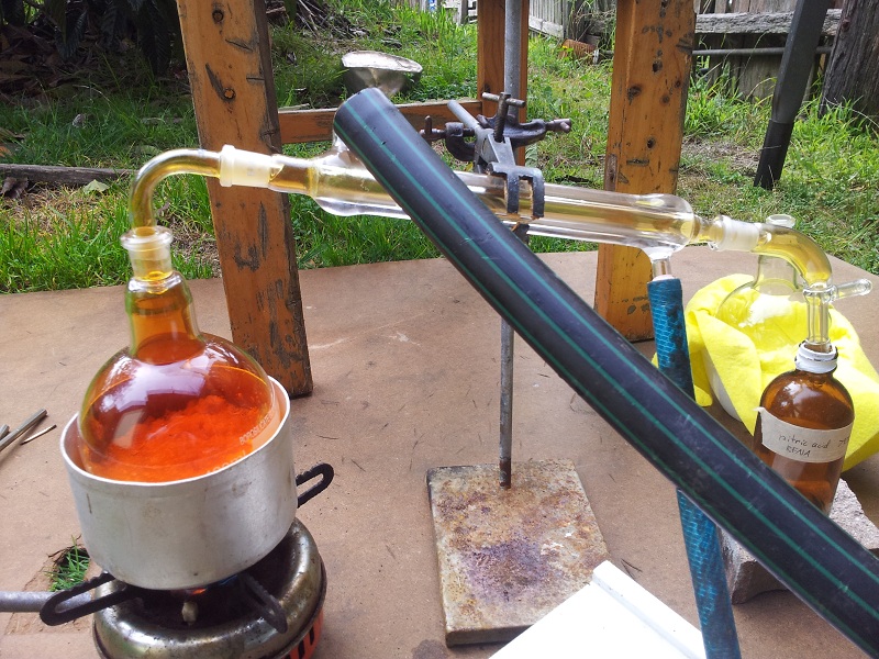

Oscilllator
Posts: 659
Registered: 8-10-2012
Location: The aqueous layer
[*] posted on 20-7-2013 at 02:21
Quote: Originally posted by weiming1998
With an excess of sulfuric acid, (almost) water-free nitric acid can be made (See http://lulelaboratory.blogspot.tw/2013/01/preparation-of-anh...). However, nitric acid made and distilled without a vacuum will always contain a significant amount of nitrogen oxides dissolved in it. Thus, white fuming nitric acid (anhydrous nitric acid containing very small amounts of dissolved nitrogen oxides) can only be produced by vacuum distillation.
It is important not to crank the heat up too much during distillation, as more nitric acid will decompose, producing nitrogen dioxide and water, which dilutes down your product.
I have actually observed results that contradict this. If I carry out the distillation at lower temperatures, then NO2 is very visible, but if it is carried out at higher temperatures there is barely any NO2 contamination. I have previously made a thread on this , but I don't recall receiving a satisfactory explanation fo this phenomena.
The distillation was done with KNO3 and clear drain cleaner labelled as 98% H2SO4. The acid obtained was yellow and formed a passivation layer with copper, indicating it is very concentrated. I have yet to do a titration on the acid, but its on my to-do list :).
The picture that on the right is a picture that was taken early on in the reaction, before it got going. The other one is from about 10 minutes later and as you can see there is minimal NO2 contamination.
IMG_20130714_132245.jpg - 214kB IMG_20130714_131634.jpg - 233kB
[Edited on 20-7-2013 by Oscilllator]
Pulverulescent
Posts: 793
Registered: 31-1-2008
Mood: Torn between two monikers ─ "hissingnoise" and the present incarnation!
[*] posted on 20-7-2013 at 03:17
This is because NO2 is swept from the flask, on forming, by increased HNO3 vapour production!
"I know not with what weapons World War III will be fought, but World War IV will be fought with sticks and stones"
A Einstein

perhaps make tiny holes in the bottom of the hose, and stopper the end so you get a stream of micro bubbles?
finished product also needs to be absolutely dry before it will do anything interesting; store away from light / UV, speeds decomposition up alot
