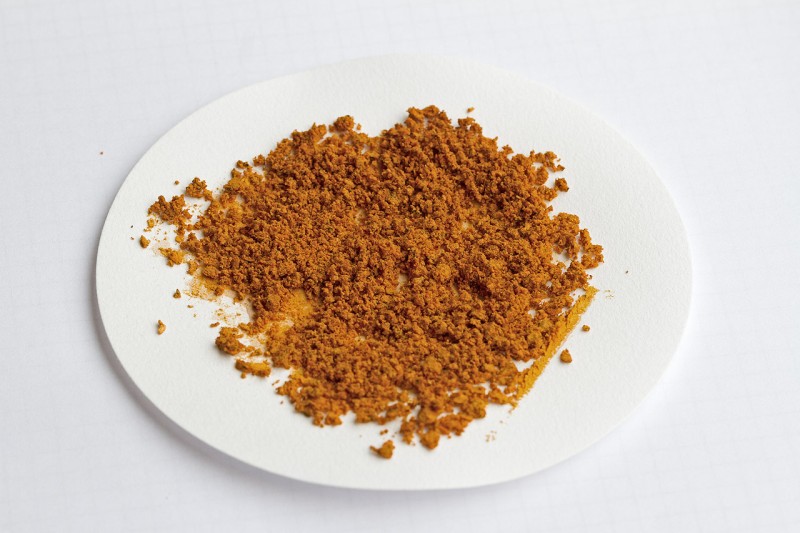

I have attempted the synthesis of a cobalt analogue of the Nickel ethylene diamine(en) perchlorate as below :-
1. Dissolve cobalt in Nitric acid (50:50 conc/water) - use excess cobalt.
2. Take an aliquot and add en until no further colour change is observed.
3. Add 100 vol H2O2 to the cold or warm(not hot) liquit to complete oxidation to Co(III). It will froth.
4. Heat and add concentrated hot Ammonium perchlorate.
5. Allow to cool.
6. Yellow-brown crystals will precipitate out of the solution.
7. Filter and wash sparingly with water.
Notes
The cobalt solutions are very dark so colour changes are difficult to observe.
I have no idea of the formula of the precipitate which looks impure (It has darker, almost black specks in)
I have added a picture of the damp material and will look at its reaction when heated once it has dried.
Next stop copper.
Fred.jpg - 101kB

I have now had a look at the dry Cobalt salt. It deflagrates in a similar manner to the Nickel salt when heated. I have also prepared some dark blue crystals of a copper analogue ?? in low yield which I will show when they are dry. Video of the cobalt salt attached.

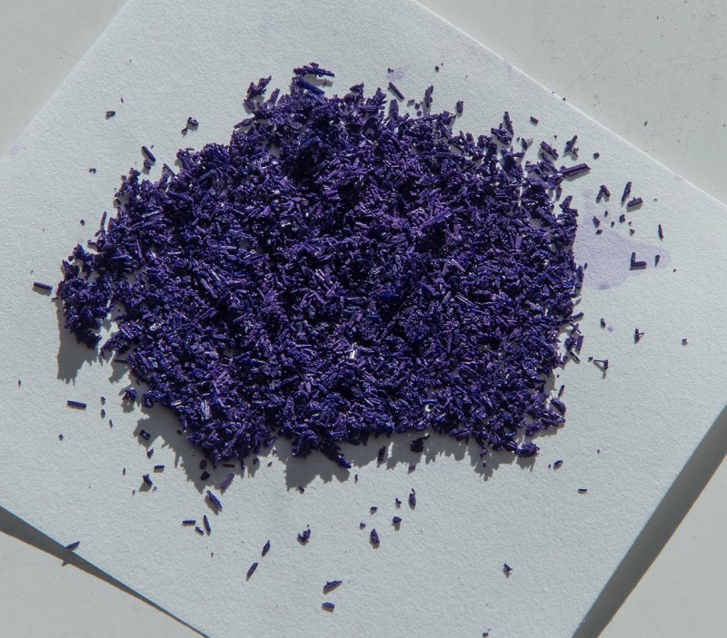

Finally pictures and a video of the copper complex. Lovely blue flashes and a green coloured flame.
copper.jpg - 202kB
Attachment: CopperVGA.mp4 (1.3MB)
This file has been downloaded 1021 times

Hi Woelen. The method for copper is the same as for nickel. Concentrated solutions have to be used and the precipitate is quite soluble so the yield is not very high. I cooled the solution in an ice bath for an hour or so and got the crystals pictured.

I tried the experiment with copper. This is not as easy as the preparation of the nickel complex. I have the impression that I do not get any crystals from the solution, while it is quite concentrated.
I used CuO and 30% HClO4. I dissolved a slight excess amount of CuO in 30% HClO4. This requires quite some heating to get the last amount of HClO4 reacted. The final product is a turbid dark blue solution. When one or two drops of HClO4 are added to the turbid solution, then it becomes clear and deep blue, but then it also contains excess HClO4, which is not what I want.
To this turbid blue solution, I added some pure ethylene diamine. This reaction is more exothermic than I expected. The result is a deep blue liquid, which after standing for a while becomes turbid and on heating, it does not become clear again, but light blue solid material deposits on the bottom. This most likely is Cu(OH)2 or some basic copper perchlorate. So, I added quite a lot more ethylene diamine. When this is done, then the solution turns more purple/blue instead of deep royal blue. This purple solution remains clear, also on heating to boiling.
I now have the blue/purple solution standing and hope to see formation of crystals from this solution. This solution is a little viscous and it sticks to the glass.
One day later: A large amount of crystalline solid has settled at the bottom, I am really amazed to see how much solid separates from the liquid. The liquid apparently can be hugely oversaturated.
I put the liquid in a freezer for some time, such that its temperature drops to well below 0 C, but not so cold that the dark blue liquid freezes. When this is done, then even more crystalline solid separates.
I decanted the ice cold purple/blue liquid from the crystal mass and put the material on a filter paper, which in turn is put on a pile of paper tissue. I firmly pressed the material in the filter paper between the paper tissue. By repeating this two times with fresh paper tissue, I obtained a fairly dry crystal mass (crystal size in the order of magnitude of 1 mm). The damp crystals were put in a warm dry place and after a few hours they were perfectly dry.
Properties of the material:
- dark blue/purple crystals
- dissolves in water with some difficulty (e.g. like KClO3)
- the solution is clear and has a very deep purple/blue color
- non-hygroscopic
On heating in a flame, the crystals pop and crackle with a beautiful blue flash. If the material is put on a small spatula, and the spatula is heated from below, then when the temperature reaches a sufficiently high value, the material explodes, giving only a weak blue flash, but an impressively loud and full report.
Compared to the nickel-complex I have the impression that this material is more explosive. It ignites more easily and the audible effect is stronger.
Pictures and video will follow soon.

Thanks for your comments. If I read your comments, then I have the impression that the hydrazine-based complexes are much more risky than the (en)-based complexes. Hydrazine is much more endothermic than (en). I did quite some mishandling of the perchlorate salts of the (en)-complexes and the only thing which can have them explode is heating them in a flame and having them react all at once. Strongly crunching the solid material with a rough metal spatula does not cause ignition.
I now did the experiment with zinc as well. This gives a white crystalline compound, which is approximately as energetic as the nickel-complex. The procedure is as follows:
Prepare a concentrated solution of ZnCl2 in distilled water. Use appr. 1 part of ZnCl2 with 2 parts of water. When the ZnCl2 is dissolved in that amount of water, then the solution becomes quite warm.
Prepare a solution of appr. 1 part of (en) in 4 parts of water. Make around 10 ml of this solution. Slowly add this solution to the solution of ZnCl2. You get a white precipitate. When more of the solution of (en) is added, then the white precipitate redissolves again. Add so much solution of (en) that all white precipitate redissolves again. This requires quite some excess of (en), the liquid has a clearly noticeable smell of (en) when it is totally clear again.
In a separate test tube dissolve roughly 2 times as much of NH4ClO4 as ZnCl2 (not measured, just estimated on eye) in a small amount of water. Use heat to get such a concentrated solution of NH4ClO4.
Pour the boiling hot solution of NH4ClO4 and the (en)/ZnCl2 solution in a small erlenmeyer. When this is done, a white powdery precipitate is formed. Heat the liquid, until it becomes entirely clear again and boil for a while.
Finally, put the hot liquid aside in a dust-free and quiet place. Let stand overnight. After one night there are large needle-like white crystals. Place the liquid in a fridge and allow to cool to around 0 C to have a little more crystals.
Pour the ice cold liquid from the crystals and then put the wet solid on a piece of filter paper, which in turn is put on a pile of paper tissues. Fold the filter and the paper tissue and press firmly to have most adhering water absorbed by the paper tissue. Repeat this procedure two times with fresh dry paper tissue.
Finally, unfold the filter paper and allow the crystalline (damp) material to dry for a day in a warm place. Crunch the crystals somewhat and stir them up every few hours, to get all of them perfectly dry.
[Edited on 26-10-13 by woelen]

The reason why I prefer to use NH4ClO4 in many cases is that I do not want to use up my HClO4 quickly. NH4ClO4 is much easier for me to come by than HClO4. If I were in a lab with supply of chemical without restrictions, then I would use the metal oxide or carbonate in all cases and would dissolve that in aqueous HClO4.
With copper, however, I used HClO4 in which I dissolved CuO. This was because it was written that the copper complex is very soluble and less easily crystallized and in such cases it is best not to have foreign ions in solution as well.
My next one will be the cobalt(III) complex and maybe the silver(I) complex, although I am somewhat reluctant to make the latter. Silver(I) with ammonia is a dangerous combination on standing for a longer time and I can imagine that silver(I) with (en) also is dangerous, regardless of the anion. So, if I try the silver complex, I will try it on a very small scale.
I already tried chromium(III), iron(II), iron(III) and vanadium(IV) and all of these form a slimy/flocculent precipitate with (en), which does not lead to formation of clear solutions and easily crystallizable compounds.
[Edited on 29-10-13 by woelen]
