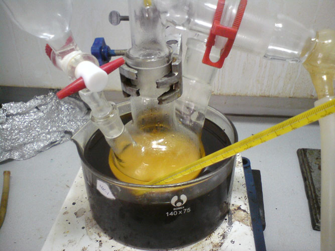

[*] posted on 13-1-2014 at 08:39
I tried to make sodium ethoxide by reaction of anhydrous ethanol with Sodium hydroxide.
I distilled mixture for bring out the Ethanol that make azetrope with water and added more anhydrous ethanol for pushing this reaction to right side.
NaOH + EtOH <==>NaOEt + H2O
I used 40gr(1 mole) NaOH and 92gr EtOH(2mole) also added 400 cc excess Ethanol for making azetrope with water but it seems no Ethoxide formed.
I checked density of distilled ethanol and that was 0.793(near dry ethanol)and also i added calcium oxide to it but temp didnt increase.
somebody has experience on this reaction?

Posts: 10553
[*] posted on 13-1-2014 at 13:19
Waffles:
Have you tried the procedure that uses acetone as an anti-solvent to precipitate the NaOEt? See top of this page for patent and links. That appears to work well for short chain alkoxides.

[*] posted on 14-1-2014 at 10:18
The difference of bp between the azeotrope and pure ethanol is less than half Kelvin. There is no way you could quantitatively remove water with a distillation employing such an insignificant difference, not even if you used a distillation column. You would need to add toluene to make a ternary azeotrope with some significant bp difference and still you would need to apply a distillation column.

[*] posted on 14-1-2014 at 22:07
How much toluene is needed?can you send picture of your suggested system?just i add distillation column?
Waffles:
I tried it before.
I reflux 1mole KOH with 2 mole EtOH for 3 hours and then i added anhydrous acetone but i got no precipitate

[*] posted on 15-1-2014 at 08:25
You don't need to reflux; just make sure all the KOH dissolves. I would suggest making a saturated solution.

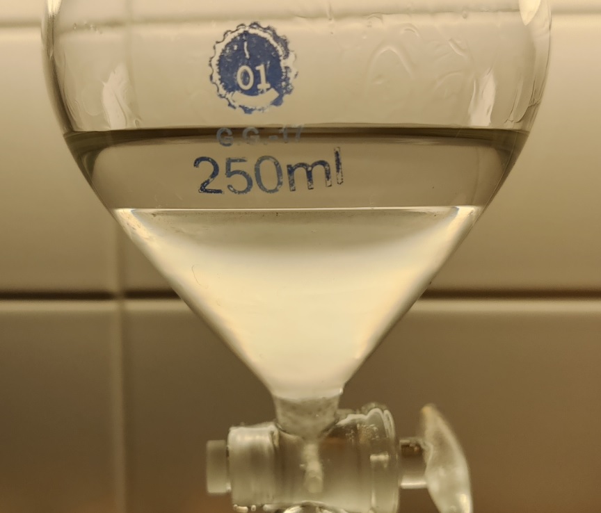

[*] posted on 18-3-2021 at 13:24
Quote: Originally posted by Organikum
A sep-funnel or anything else with an outlet (faucet) at the bottom is filled to 1/3rd with NaOH pellets and filled full with EtOH of 92% or of higher concentration (preferred). This sits for at least half an hour and then about 1/4th of the liquid at the bottom is withdraw very slowly. Then the rest is withdraw. This rest consists of EtOH which contains sodium ethoxide. Distilled to yield anhydrous EtOH, sodium ethoxide is left back which can be used to dry more EtOH so desired.
If the alcohol is pre-dried with anhydrous CuSO4 which was dehydrated at 300°C+ much less NaOH is needed. This pre-drying takes time though, the longer the better in special if no stirring is applied.
If the ethoxide is whats desired the alcohol should be left in the vessel for longer time, if bigger amounts are wanted it is favorable to withdraw alcohol/ethoxide from top and water/NaOH/alc from bottom and to refill alcohol. This is an almost continous process then.
Tried and true.
I used some NaOH to distill my wiper fluid ethanol, which was +80C to start with, and it appeared to me that it came over pretty much anhydrous. Apparently, NaOH/Ethoxide is able to hold a lot of water behind.
Supposedly, pre-drying the ethanol with MgSO4 would reduce the need.
Last time I stripped some fluid, I measured it was about 90% with ABV meter. I did this without NaOH, as I thought it might not be necessary and to save some expensive NaOH. It seems that if I want less watery EtOH, I'll need to use it anyway.

But, to the topic. I couldn't wait for my lab and did some rudimentary tests with my own boka-fractionated, polished and diluted 40ABV vodka and NaOH.
I first added a small amount of vodka, and added NaOH pellets and stirred, until separate layers were formed.
funnel1.jpg - 86kB
Then I added more, between 200-250mL, and added more NaOH and stirred, and the liquid heated up a lot, but not too much to handle the funnel. I kept adding NaOH little by little, until layers were separated. They formed bubbles and the boundary closed in just as in any biphasic extraction. The activated carbon residue used to polish the distillate can be clearly seen at the boundary.
funnel2.jpg - 91kB
The extracted upper layer was at first attempted to drain into a tube for ABV meter, but it had a pinhole, which caused a little leak. Actual measuring cylinder was dug through the rubble, and the ABV measurement and volumetric measurement were conducted. The ABV reported pretty much exactly 0ABV, but I hardly believe the alcohol layer would have been the bottom layer, as the upper layer had a very burning alcoholic odor, but the ABV meter is very sensitive and the most likely explanation is dissolved NaOH, ethoxide and other stuff. The total collected volume was 86.5mL as seen, which checks in the ballpark with the input alcohol, at 40ABV by rough calculation and dilution.
The amount of NaOH required is a lot, but not hefty, and obviously as this was 40ABV, the required amount would be inherently larger than when separating azeotropic product.
It should be distilled and remeasured to see if the resulting product is closer to anhydrous ethanol, but at least the very clear layer separation caught my curiosity if ethanol can be salted out from water with NaOH to make actual close-anhydrous ethanol.
Btw, the OP's funnel concept works for the part that it does form a layer close to the edge of the NaOH pellet mass - but the NaOH will completely clog the funnel and form a cone-shaped conglomerate that is very hard to break down and will prevent draining any liquid, even when poked with piano wire from the drainhead. Instead, just adding ethanol to funnel and adding NaOH pellets and shaking until layer separation occurs could be a more viable option. I have currently a batch of azeo EtOH stirring over MgSO4/CaSO4, and I'll probably strip a sample to see if any desiccation has been occured, and if not, I will do a full-scale treat on the batch and see what the resulting product will be. It is likely I'll do it anyway, because I'm running out of ethanol and simply treating the wiper fluid directly with mass of NaOH will both destroy MEK, detergents and additives and keep the residual water, so pretty decent ethanol should be able to be stripped directly off it.
