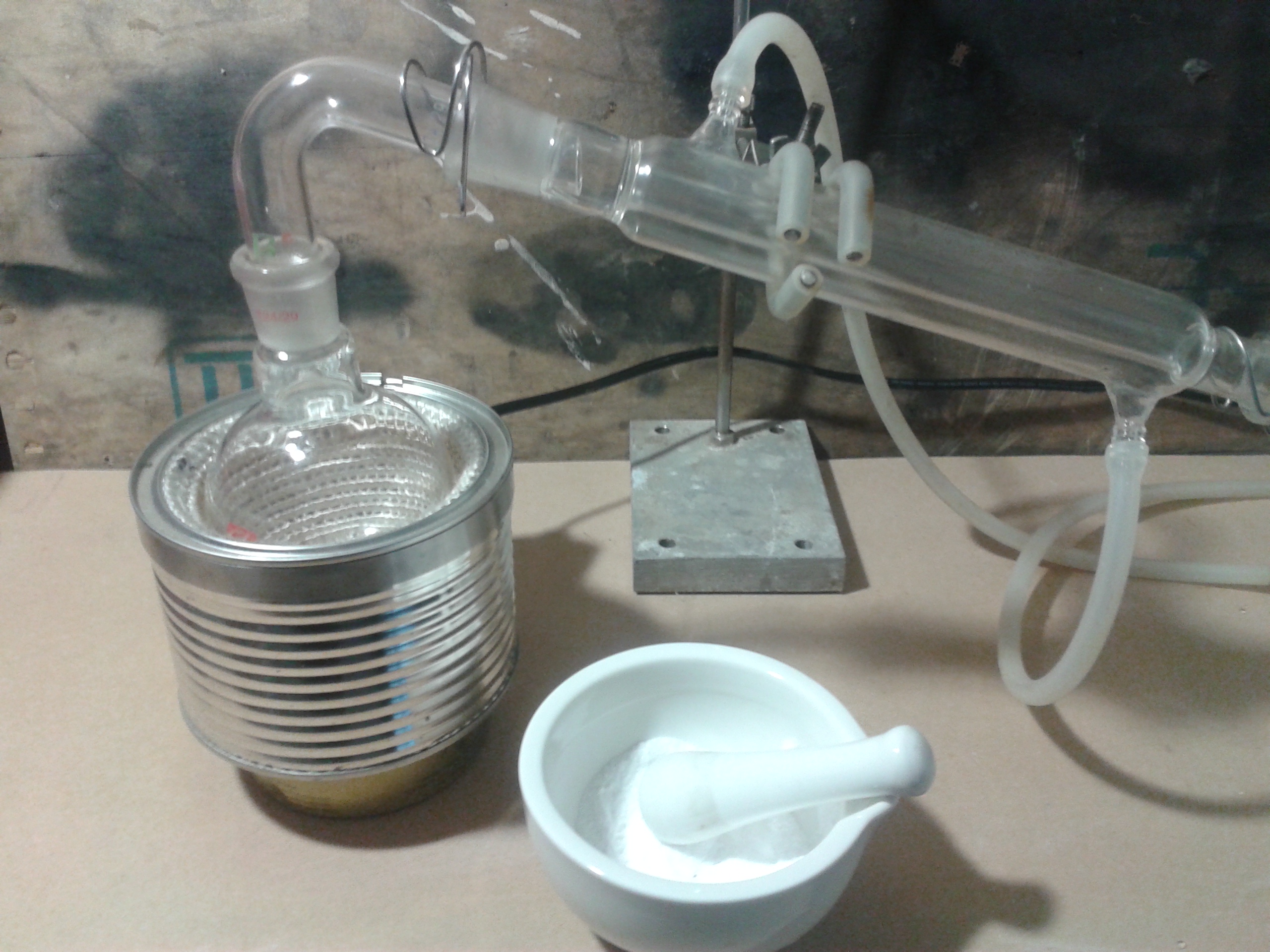

I just gave the synthesis a go but on a small scale i used equal molar amounts of reactents..
20160827_125850.jpg - 1.2MB
Then ran my new heating mantle flat out the first droplets formed in 10 minutes .

It looks like this method works but not wanting to heat my flask with a flame i dont know if yields would be higher with more heat.
Cheers nux
