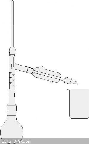

Not too hard. The set up looks like the one in the picture. Collect the fraction from about 118 degrees C to 124 degrees C. This is your azeotropic nitric acid. I think you could also do a simple distillation here if you go slowly.
noname01.jpg - 10kB
Thank you for responding. :D
Have you done this before?
Sorry to abuse your good will, but what are the approximate yield?
I'm asking because azeotropic nitric acid got very hard to get here where I live, but for some reason the 53 % concentration is very, very cheap and sold OTC with no limit for how much you can buy.
I'm not going to buy gallons of it, but instead I want to make it more economically viable to experiment since I work at a shitty job and most of my money goes to pay my college bills.
Realistically, much much 68% nitric acid would be obtained from a 5 liters bottle of the 53 % one? I'm not talking about theoretical yields though.

Do you have access to 98% Sulfuric acid?
If so you could use the same distillation setup with a water-cooled liebig condenser and a 2:1 ratio of H2SO4/HNO3 in the distilling flask.
The sulphuric acid will hold the water and around 90% red fuming nitric acid will distill over.
You can then dilute this to 70% or whatever concentration you want by addition of water.
I haven't done it yet as I don't need to in order to get nitric acid, but the procedure was taken from NileRed's video on making azeotropic nitric acid (https://www.youtube.com/watch?v=KBeo8nww21g&t=312s). More specifically, from the purification step at 5:25. You'd theoretically get about 3.68 liters of acid after distillation.
This method has the disadvantage of producing nitric acid of less accurate concentration though.
I thought about that. Honestly it isn't very economically efficient since 98% h2so4 isn't cheap.
I'm also kind of scare of the fuming nitric acid. Its very corrosive and almost everything it touches catches on fire instantly, including my cheap gloves that are rated for common acids.

I watched the video before posting the question.
Are you certain that I'll get 68% nitric at the end flask?
Thinking long term, its better for me to buy good quality glassware that will allow me to concentrate the acid instead of buying directly.
As I said, 30 USD for 5 liters of 53% that will yield somewhat on the 3 liter range would be very good since 1 L 68% NA costs about 40 USD alone here, and you also go to a watchlist. I don't like watchlists.

I agree with the fact that it's better to buy good quality glassware rather than buying the nitric acid directly. I suggest looking at the seller deschem on eBay if you're interested in buying glassware. Since NileRed's acid was even more dilute than your acid and he did get 68% nitric acid in the receiving flask, you should also get 68%. If you want some proof it is at that concentration, do as NileRed did and measure its density.

I was just about to write that you can get a fairly accurate idea of the concentration using the density. :)
Heres a calculator which takes into account ambient temperature as well:
http://www.handymath.com/cgi-bin/nitrictble2.cgi?submit=Entr...
