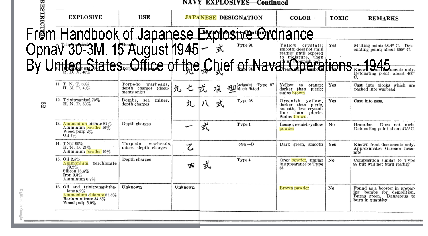

[*] posted on 14-7-2023 at 04:27
I recognise the sounds of the birds chirriping in the background
Regarding ammonium chlorate. It turnes up in a us navy book of wwI explosives
It was used as a booster mixed with something else. It must be an error. Will post table later.
Called brown powder used by the japanese .
Yob
[Edited on 14-7-2023 by yobbo II]
jap_exp.gif - 205kB
