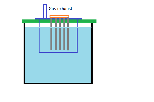

Why ordinary plastic cover doesnt work? Also, you could install a submerging tube around the electrodes if problematic gases are formed. It will collect the gases within the liquid gas layer airtight and you just install tube to it and lead the gases safely out. Like this:
simple cell.png - 5kB
PVC plastic will hold well against all chlorine compounds, including elemental.
Wood will just simply suck all the moisture and rot away sooner or later. You could apply layers of lacquer or paint for it, but at that cost you can get cheap plastic covers from anywhere, secondly, you can use soldering iron to cut the plastic if you live in a place where power tools are too lousy to use.
