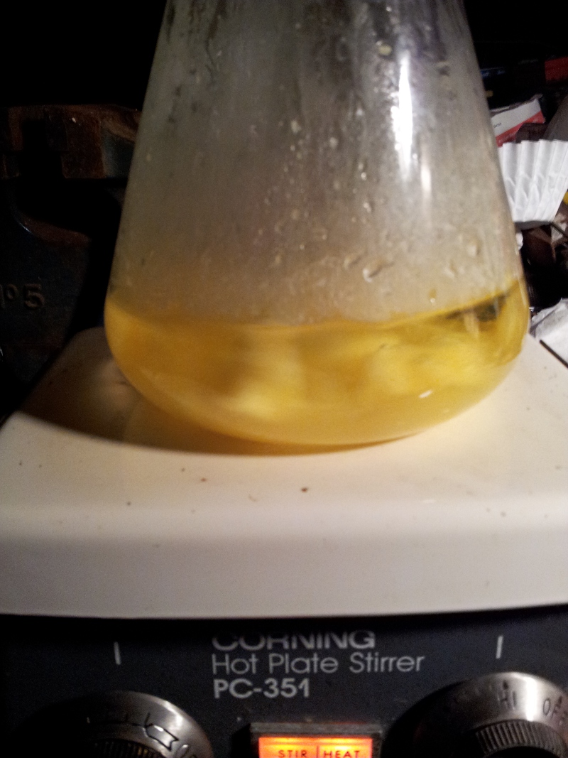

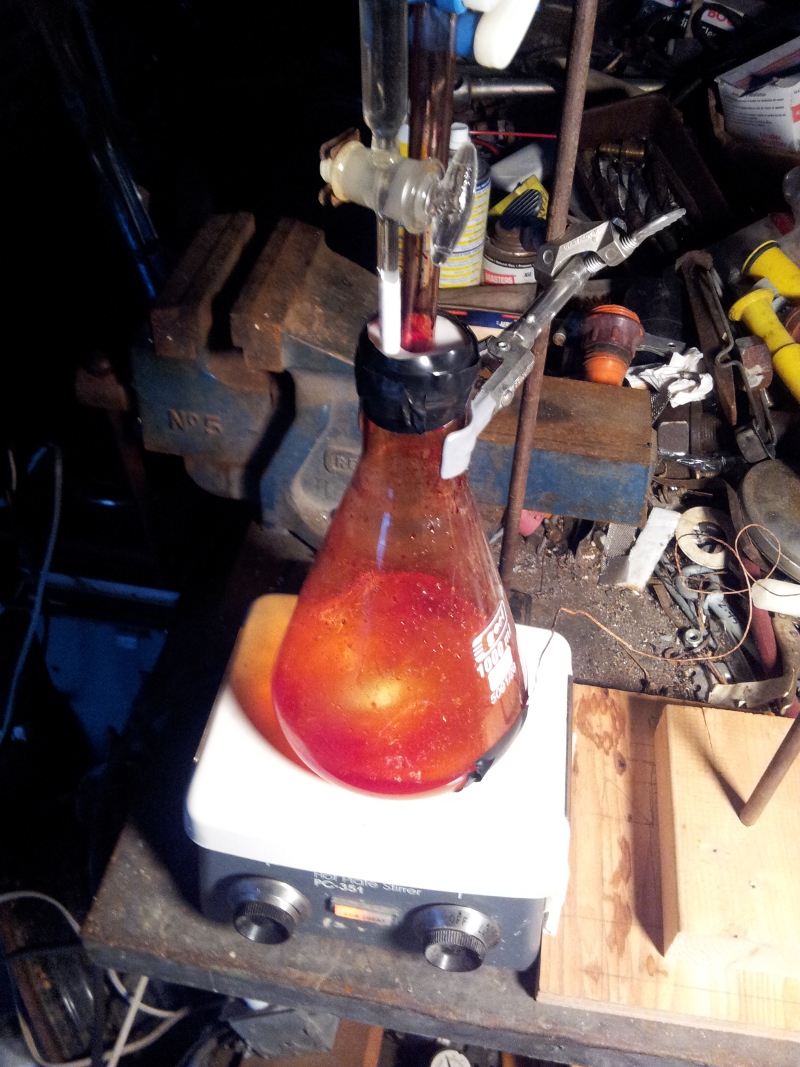

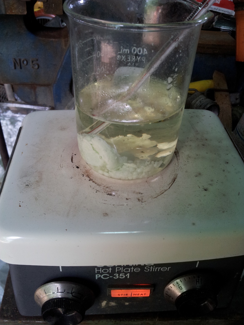

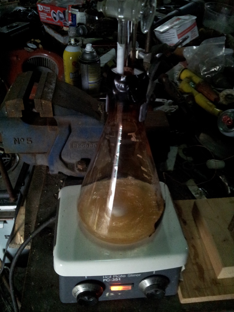

I spent the last few days making some TNT and taking a lot of pictures along the way. The nitration was performed in two steps; toluene was nitrated to DNT in one step and then DNT was nitrated to TNT in a second step. I will first report on the DNT portion of the experiment, since I have a lot of pictures for each section. I had sixty or more pictures for the DNT step alone, which I pruned down to twenty five.
Some time was spent reading through COPAE and Urbanski and the nitration mixture used was based on numbers from an old Italian method described in Urbanski Volume 1, pg 363.
From toluene to DNT
Nitration Mixture:
HNO3....28%
H2SO4...60%
H2O......12%
In order to make a nitration mixture approximating these numbers, ammonium nitrate and 91% sulfuric acid was used. The reaction between the nitrate and sulfuric acid was assumed to be ideal and represented by the following chemical equation.
NH4NO3 + H2SO4 ---> HNO3 + NH4HSO4
A 10% excess of HNO3 was used (though I might increase it to 20% next time around)
For 1g of toluene:
1g / 92.14g/mol = 0.01085 mols toluene
T ---> DNT takes two moles of nitric acid (ideally), used 10% excess
2 * 0.01085 * 1.1 = 0.024 moles of HNO3
therefore need 0.024 moles NH4NO3 & 0.024 moles H2SO4 to form the HNO3
mass of NH4NO3 needed = 0.024 moles * (80.052 g/mol) = 1.92g
mass of H2SO4 needed = 0.024 moles * (98.079 g/mol) = 2.35g
mass of HNO3 produced 0.024 moles * (63.01 g/mol) = 1.51g
Using the percentages from Urbanski for the nitration mixture:
mass of H2SO4 needed for nitration mixture = 1.51g / 28 *60 = 3.24g
mass of H2O specified for nitration mixture = 1.51g / 28 * 12 = 0.65g
Experimental:
For 50g of toluene used:
96g NH4NO3 (recrystallized and oven dried fertilizer grade nitrate)
(117.5 + 162g) / 0.91 = 307.1 g, 91% H2SO4 (or ca. 169mL at 1.82 g/mL)
H2O added with H2SO4 (NH4NO3 was oven dried and assumed perfectly dry):
0.09 * 307.1 g = 27.64 g
The numbers (neglecting NH4HSO4):
75.5g HNO3
162g H2SO4
27.6 H2O
Total mass = 265.1g
Percent water = 27.6g / 265.1g * 100% = 10.4% (less than the 12% specified by the Italian numbers)
Procedure:
The NH4NO3 was dissolved in the sulfuric acid the night before the nitration was to be performed. The 50g of toluene was weighed out and added to a 1L Erlenmeyer flask which was equipped with an improvised air cooled reflux condenser. Addition of the nitration acid took about 3 hours and was done with a 25mL burette. The temperature started out at about 30C, but was raised all the way to 80C by the end of the 3 hours and then was held at 80C for an additional 2 hours once all the nitration acid had been added. It is clear from the pictures that as the nitration progressed the color of the mixture darkened to a maroon color and gradually lightened again to a light yellow color. Strong magnetic stirring was used throughout.
The mason jar in the first picture holds about 1/4 of the nitration acid made from NH4NO3 and 91% H2SO4. I forgot to take a picture of it at the start. The second picture shows the 50g of toluene in the flask just before the nitration was started.
Nitration Acid Mixture.jpg - 433kB 50g of Toluene.jpg - 411kB Apparatus.jpg - 477kB 1.jpg - 377kB 2.jpg - 366kB 3.jpg - 375kB 4.jpg - 373kB 5.jpg - 428kB 6.jpg - 353kB 7.jpg - 379kB

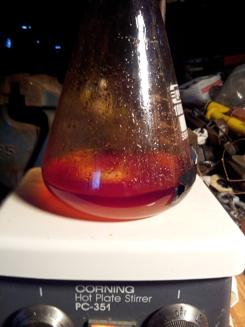

Continuation of Nitration and Color Change
8.jpg - 338kB 9.jpg - 388kB 10.jpg - 280kB 11.jpg - 298kB 12.jpg - 296kB 13.jpg - 331kB 14.jpg - 324kB 15.jpg - 310kB 16.jpg - 328kB 17.jpg - 423kB

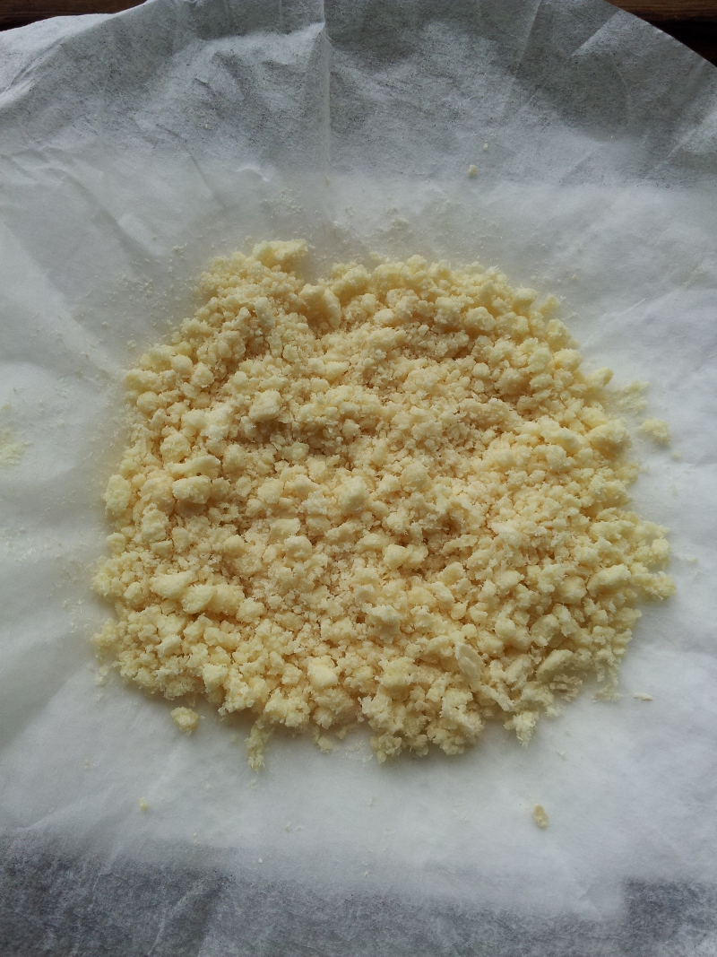

After the three hour addition time, and two hour heating at 80C, the stirring was continued but the mixture was allowed to cool. The stirring was stopped once the temperature had dropped to about 60C and the DNT was allowed to rise to the surface and collect. Solidification did not happen until about 50C. Once the reaction mixture had cooled to 20-30C the DNT cake was broken up with a large, stainless steel, flat head screw driver and scooped out with a spoon. Diluting the spent acid mixture precipitated another small amount.
The collected, and water washed, DNT was put back in the flask with about 250mL of clean water and heated to above the melting point of the DNT. Vigorous stirring was applied for 15-20 minutes to help dissolve water soluble impurities. The flask was then allowed to cool to room temperature, at which point the water was drained off and the DNT cake was washed a couple of times with small quantities of cold water. The cake was then broken up with a bamboo skewer and dumped from the flask. The chunks of cake were then allowed to dry and then weighed.
