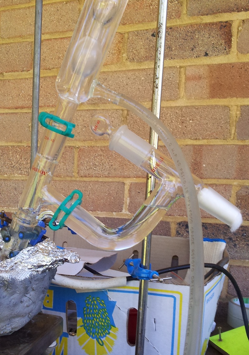

You can improvise a dean-stark trap (as shown in the picture). It worked quite well for my synth of p-toluenesulphonic acid.
IMG_20140221_150501.jpg - 393kB
subsecret
Posts: 424
Registered: 8-6-2013
Location: NW SC, USA
[*] posted on 8-3-2014 at 18:19
That's an interesting apparatus to replace a Dean-Stark trap, Oscillatior. I've thought about making a similar one, but using a two-necked flask and a reflux condenser in place of the "stillhead."
Brilliant idea thank you. It never occurred to me to use my claisen adapter as a dean stark.

For me, buying a dean stark trap costs 5 dollars more than a claisen adapter, so I am going to buy a dean stark trap.
