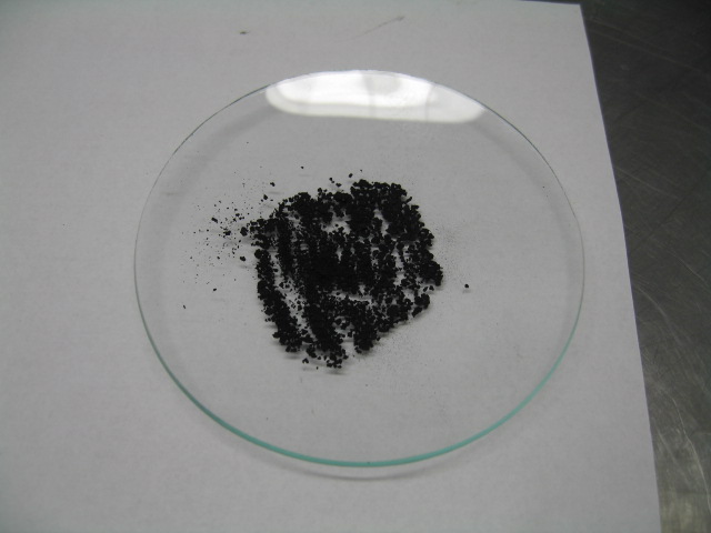

I then Buchner filtered the product keeping only the residue. This was water washed, dried, then washed with petroleum ether. After drying it looked like this:
mauvein residue following pet ether wash.jpg - 63kB
The directions for the extraction of mauve from this dried residue in the Scaccia paper are very confusing. So, instead I merely extracted the residue with methanol then filtered the extract. This captured the mauve. However, for some reason it has more red in it, looking just like concord grape juice.

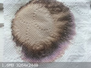

Yesterday I tried the procedure posted by Magpie from "Caveman Chemistry". Instead of making up the "aniline oil" due to lack of o-toluidine an attempt was made using only aniline, the aniline is dark red, purchased from a laboratory supplier.
A dark brown/red almost black solution was produced. After sitting all day I soaked the entire vial into a wad of cotton and left it to dry in a petri dish on top of tissue papers. This morning to my surprise there are definite purple/mauve colors on the tissue paper that worked as a crude, unintentional chromatography paper. The result is pretty and I will re attempt this today using Chromatography paper at different times during the reaction to monitor the progress.
image.jpg - 1.6MB
Cutting the purple areas from as much tissue as possible, then rinsing them in methanol gave this solution:
image.jpg - 1MBimage.jpg - 183kB

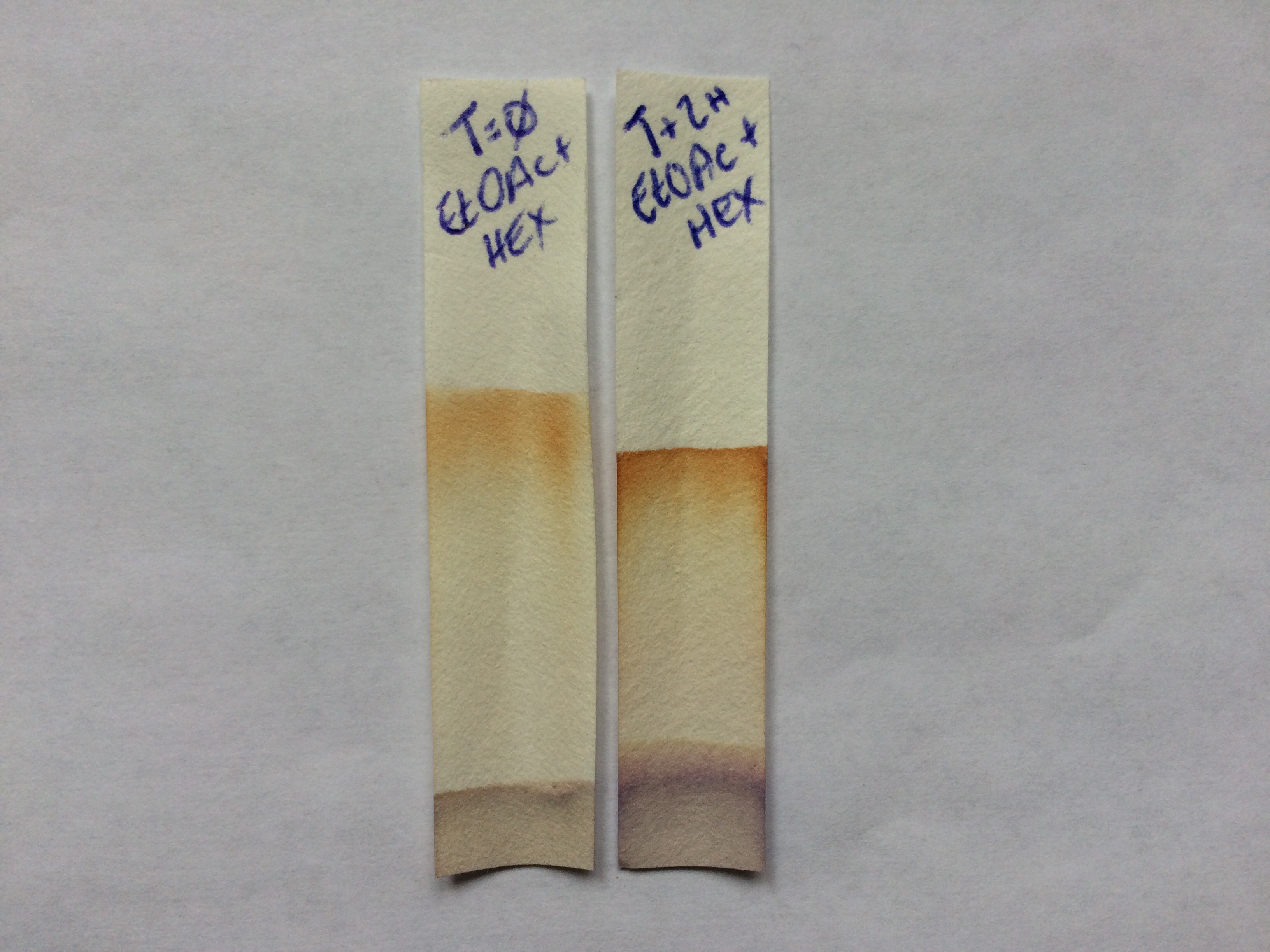

Here are two strips of chromatography paper, for today's attempt. The first was done at the start of the reaction. The second 2 hours later:
image.jpg - 1.3MB

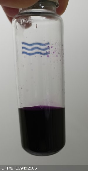

I tried this method with great success! My first attempt was a failure. I was using ordinary denaturated ethanol. After adding bleach, ethanol turned immediately brown. And things didn't get better after addition to the aniline oil in 10% acetic acid. Today I tried using MEK free denaturated ethanol. And this time the reaction works exactly like in that article cited by Magpie. This time ethanol didn't turn brown. Mixing of the two solutions result in dark blue solution. After one hour I returned to reaction mixture and it was very intensely dark purple - very similar to permanganate solution. After dilution in MeOH it still look like dilute permanganate. Nice and easy preparation of mauveine.
[Edited on 26-1-2024 by Bedlasky]
IMG_20240126_181147.jpg - 1.1MBIMG_20240126_181200.jpg - 1.7MBIMG_20240126_181216.jpg - 1.4MB

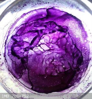

Very interesting post, i am just wondering if it is indeed mauve and not safranine you made in your first pictures, from my personal experience i know that reactio is quite tricky and generate both. I personally would rince the "tar" using xylene to remove that safranine and dissolve what is left in ethanol
After some tries this was the solid i obtained at the end following ethanol evaporation
IMG_20210808_162711.png - 1MB
