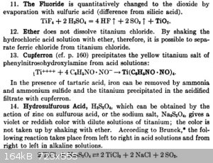

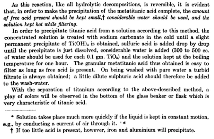

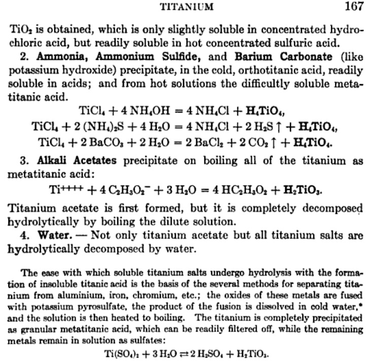

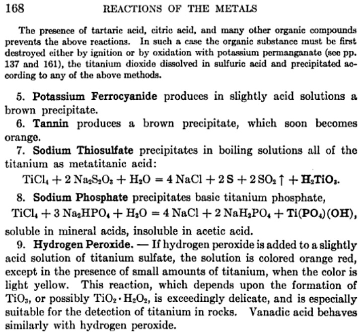

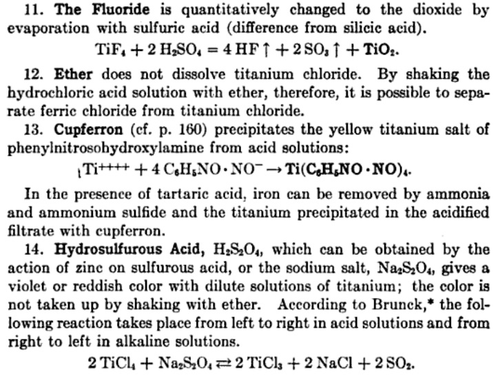

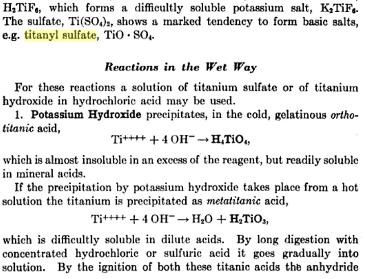

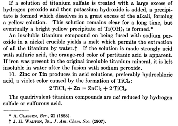

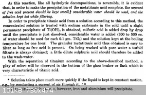

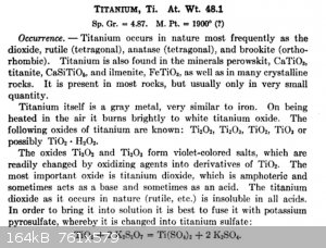

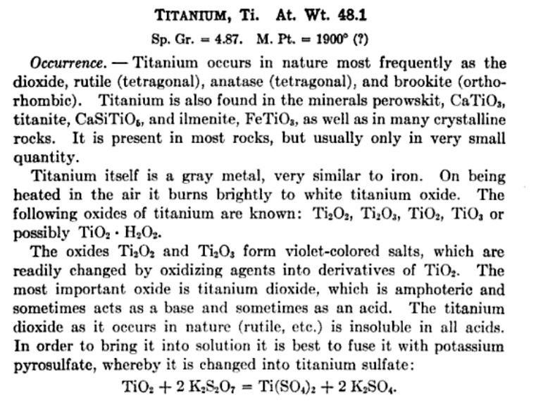

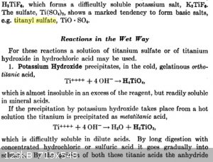

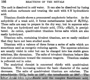

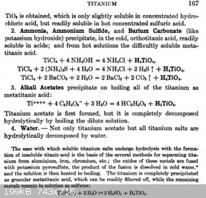

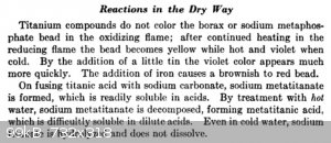

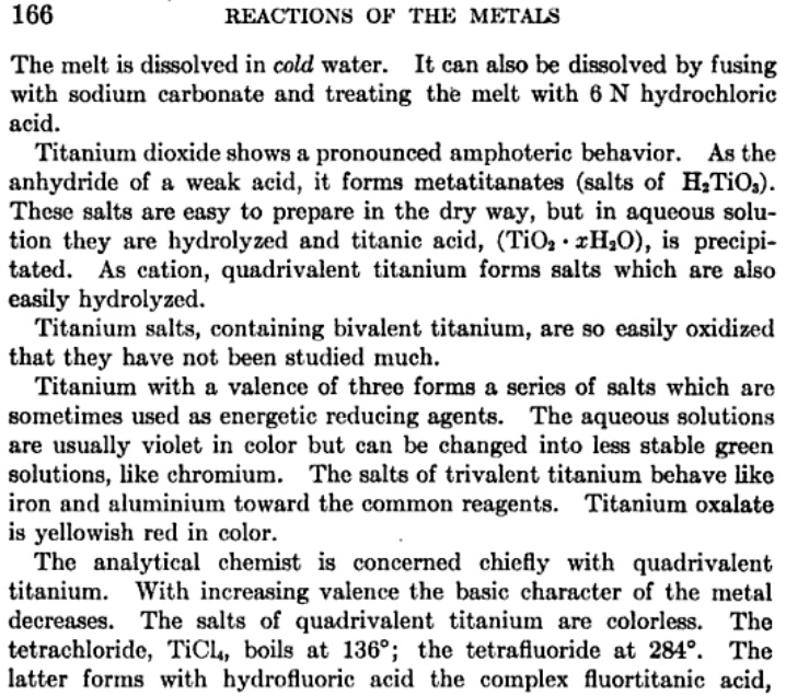

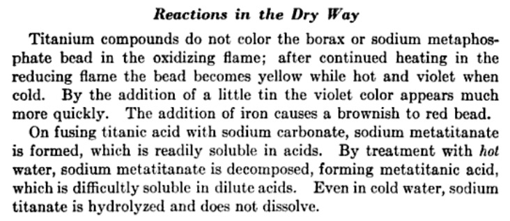

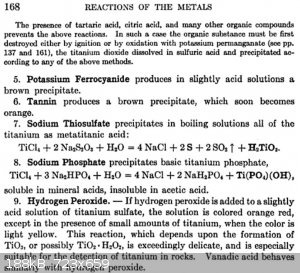

Papaya, this should answer your questions:
Analytical chemistry, Volume 1, Frederick Pearson Treadwell, William Thomas Hall - J. Wiley & sons, inc., 1921
Ti_1.jpg - 164kB Ti_2.jpg - 195kB Ti_3.jpg - 129kB Ti_4.jpg - 199kB Ti_5.jpg - 151kB Ti_6.jpg - 188kB Ti_7.jpg - 154kB Ti_8.jpg - 164kB Ti_9.jpg - 99kB
papaya
Posts: 594
Registered: 4-4-2013
Mood: reactive
[*] posted on 26-6-2014 at 14:26
Thanks WGTR, quite informative. So it appears that after fusion one gets titanium sulfate, but then
https://www.sciencemadness.org/whisper/files.php?pid=335947&...
it's transformed inti titanyl in solution?

It seems the Ti(IV) salts can only exist in solution as titanyl salts (solutions of). Pure TiCl<sub>4</sub> is a covalent, liquid (STP) compound, not an ionic solid.
Ti(III) salts like TiCl<sub>3</sub> and Ti<sub>2</sub>(SO<sub>4</sub>;)<sub>3</sub> do appear to exist as salts of [Ti(H<sub>2</sub>O)<sub>6</sub>]<sup>3+</sup>. Some can be isolated, or so I've read. The (III) sulphate forms alums with Cs and Rb, possibly with NH4.

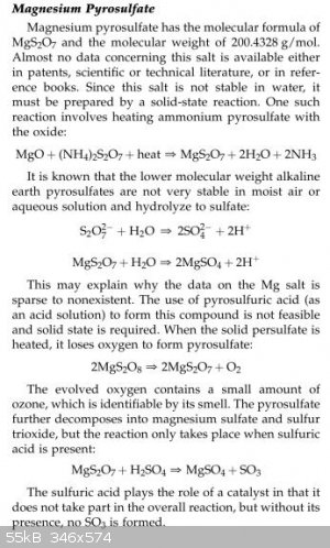

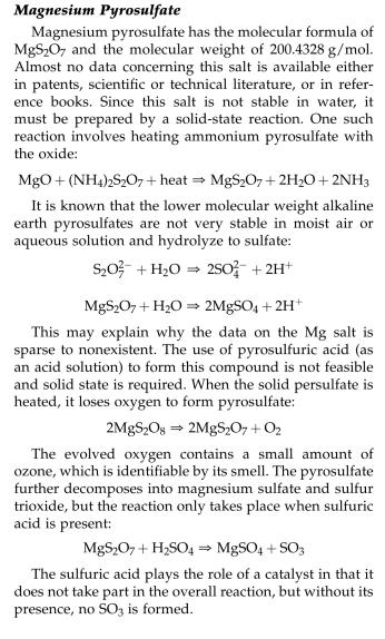

I couldn't find the same sort of information on titania, but here is what happens when magnesia is reacted with molten
ammonium pyrosulfate (which is what you have when you heat up your ammonium bisulfate ). Note that ammonia is given off:
ammonium_pyrosulfate.jpg - 55kB
Encyclopedia of the Alkaline Earth Compounds,
Richard C. Ropp
Newnes, Dec 31, 2012
Potassium pyrosulfate (or bisulfate) is recommended over sodium pyrosulfate, as it appears that the sodium salt gives off
SO3 more readily on overheating. However, either one can be used it care is taken when heating. I used the
sodium salt when fusing TiO2 in a test tube, and it worked fine. Sodium bisulfate is used to lower pH in pools, and
can be found in practically every hardware or pool supply store. It dehydrates to sodium pyrosulfate after fusion.
Attachment: Vries69thermal.pdf (259kB)
