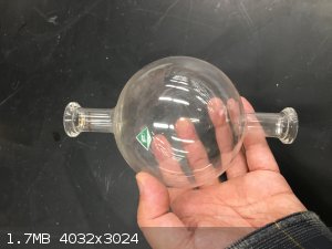

These pieces and others like it were donated to my classroom. I've never seen glassware that connects together this way, and I'm hoping someone can
tell me what this connection style is called so I can research it.
[Edited on 5-1-2021 by electrokinetic]

Posts: 2423
Electokinetic,
They appear to be reservoirs for chromatography columns to me. You can screw them to the top of a colum to hold solvent, then either use gravity or
air pressure to move the solvent through the column.
