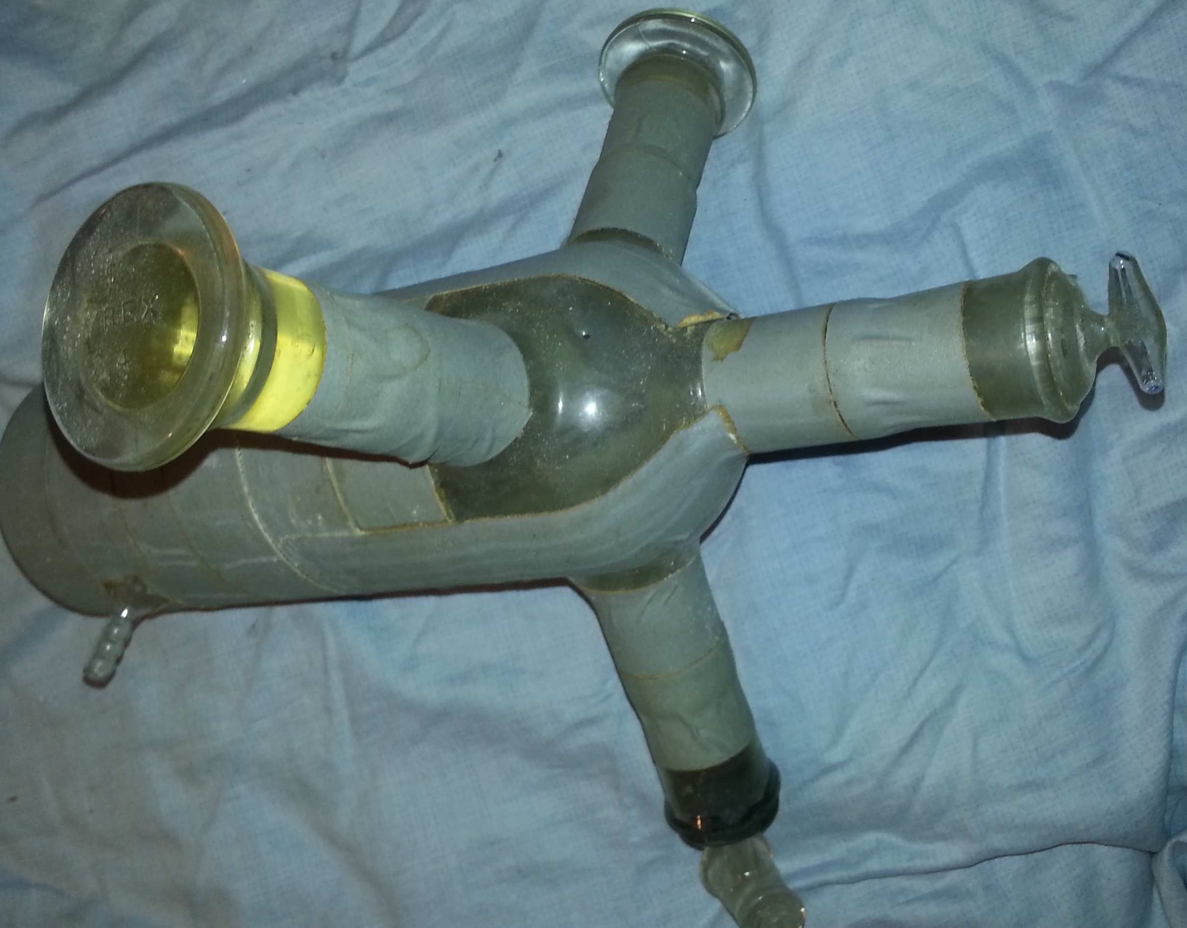

[*] posted on 5-1-2018 at 02:55
Unknown glasware
Maybe somebody know something about this..
30122014102.JPG - 2.2MB 30122014106.JPG - 1.9MB 30122014111.JPG - 2.1MB
Posts: 6171
Location: Unmoved
Mood: It's chromium time.
[*] posted on 5-1-2018 at 03:14
1 is some kind of jacketed reaction vessel.
3 is a bit like a Davies condenser -- it is a double surfacfe in the same fashion. But instead of Graham-style coils like a regular davies, it has the bulbs of an allihn. I think there comes a point where a condenser is a condenser and there is not always a huge benefit in making the design more complex.
2 also appears to be a condenser arrangement but looks like it has been put together for a specific purpose I can't realy imagine what it might be. The pear shaped vessel where condensation occurs looks to be rather inefficient. I am not sure why there is the unusual fitting at the end. Looks like it is for a rather large flask.
My guesses anyway.
There is a theread specifically for glassware questions. Perhaps a mod will be kind enough to merge this with it.
Radium212
Posts: 85
Registered: 26-6-2017
Mood: Pyrophoric.
[*] posted on 5-1-2018 at 05:04
The outer jacket in 1 may be a vacuum, so perhaps it was a vessel for a reaction where the temperature had to be kept constant?

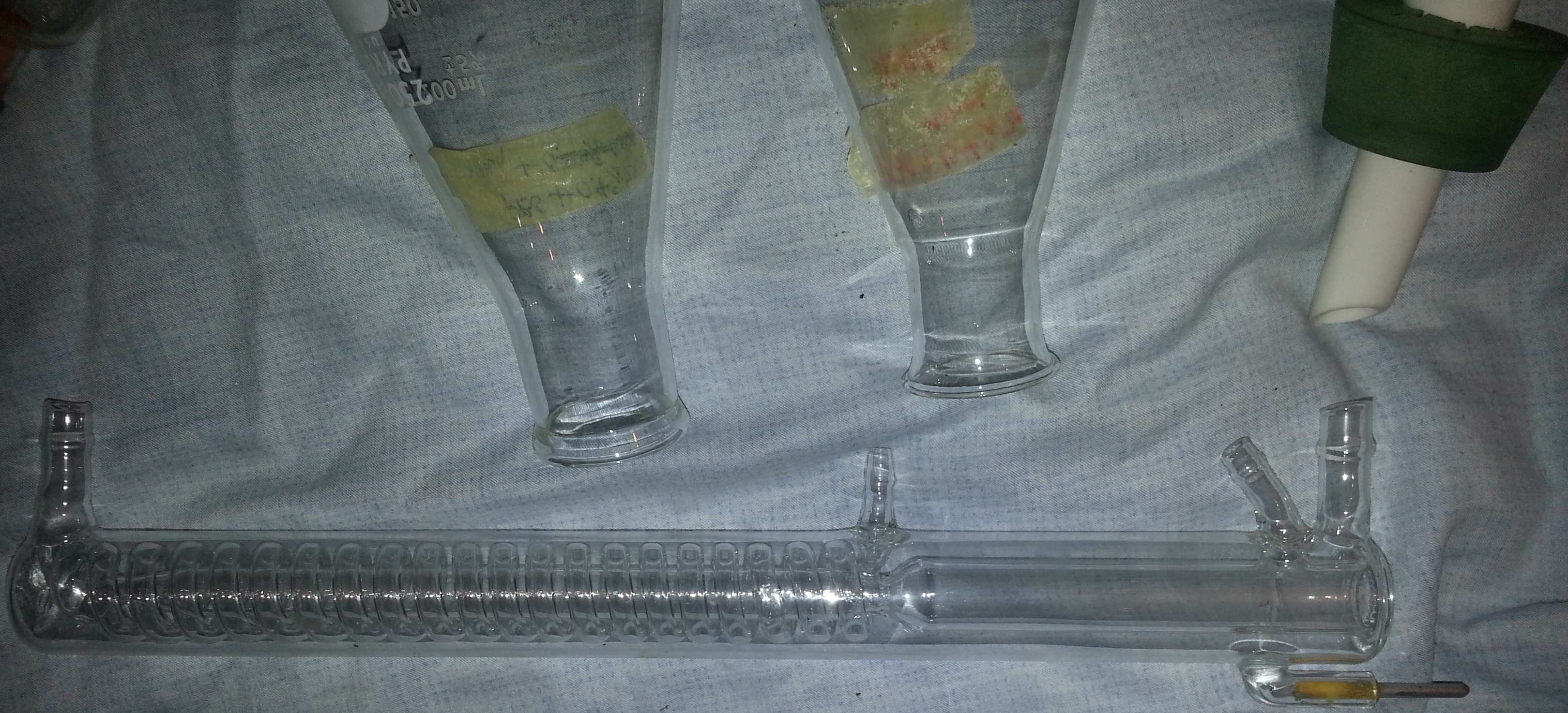

[*] posted on 7-1-2018 at 21:27

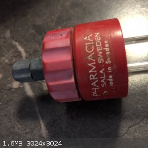

Today I happened to come across a box of glass in a second hand charity store, eyeing the contents I was thrilled to find several Burettes, Pipet tea, flasks, a Mari-jet water aspirator, loads of borosilicate tubing and solid rods. Got it at a good price 40$. One burette alone is that much so a bargain. There was one thing that stood out as unusual. It is a long glass tube 1m long with removable adapters at each end one side has hose barbs and the other was an adjustable spray nozzle. The whole box was donated by a retired chemist so it must have some kind of use in chemistry. Not sure what though.
A54A47A1-3CAF-4D47-8932-A2DFDBD68E9E.jpeg - 1.6MB C6EA4FF2-73DB-477F-AD53-34DF884D43A0.jpeg - 1.6MB 125AE425-E0A9-40DE-A238-5440EA80A401.jpeg - 1.2MB

FCC82F34-848C-433F-93FF-263D2FE3D490.jpeg - 1.7MB

Harristotle
Posts: 138
Registered: 30-10-2011
Location: Tinkerville
Mood: I tink therefore I am
[*] posted on 8-1-2018 at 00:04
It is a chromatography column, made by Pharmacia
Often filled with Sephadex/Sephacryl size exclusion or ion exchange resins.
Biochemists love them !

dan.vlad
Posts: 31
Registered: 5-11-2017
[*] posted on 19-1-2018 at 06:21
Kinda looks like a UV reactor, but not quite. (One on the left)
Do those 3 necks all access the same chamber, or do they access both the inside and the jacket adjacent?
Those 3 necks all acces the same chamber !
This is only one chamber ,with 2 jacket

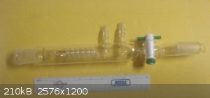

Here is an odd thing that I have, not sure what it for, it is a non-equilibrated addition funnel with a water coil going through it. Not sure if intended as a way to heat or cool something being added to a flask, or maybe a weird condenser that could be used as part of a Dean Stark type trap or what. It is also in 29/42 both ends.
If anyone can tell me what it is for for, they can buy it cheap. :-)

[*] posted on 23-1-2018 at 23:37
Maybe an addition funnel for something like phenol with a melting point in the slightly-above-room-temperature zone? At least that's what I would use it for.
Does not seem like a dumb idea to me.

[*] posted on 24-1-2018 at 20:09
It was...a custom piece for someone who couldn't afford to buy a dimroth and another addition funnel...!
It looks like it's 29/42 or 29/ something - if it were a 24/ piece I'd look into buying it...

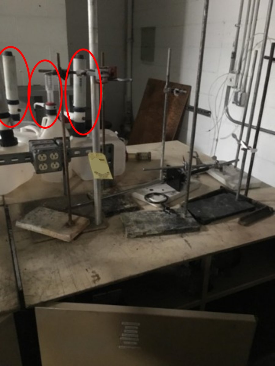

[*] posted on 24-2-2018 at 04:44
Some odd glassware in an auction lot with bidding soon to be expired
So I am looking at an auction lot and, as usually, the images look like they were taken with a 1992 cell phone, inside a sock as a filter. I just can't understand how about 70%+ of these major liquidation auctions (selling stuff to pay creditors) can't get clear pictures but they'll take 10 blurry pics of the same item when one clear pic would be better than the entire 10!
The original resolution of these pics is 480 x 320! IDK if a lower resolution is possible...
So I'm trying to identify what is in these pictures and some are pretty easy to identify but some are a little more ambiguous especially the last 2 pictures.
Top shelf looks like mostly erlenmeyer flasks, some with vacuum take-offs and some beakers. Bottom is volumetric flasks, grad cylinders, dessicant chamber, test tube rack & more flasks
a.jpg - 377kB
top shelf: More erlenmeyer flasks (250ml or maybe 400 or 500ml??)
Bottom shelf. Curious what is in the cardboard! some crystalization dishes, small beakers and flasks, a large beaker in the back (probably 2 - 3L and some nice parafilm. What is to the right of the cardboard boxes, they look like rullers but IDK why those would be there - is there something that is similar to this in chem equipment?
b.jpg - 405kB
The top shelf has a lot of long glassware which I'm not sure what it is at all, maybe volumetric pipettes? Suggestions here are greatly appreciated!
On the bottom shelf, the wrapped item in the back is impossible to distinguish but towards the left in the very back (not in circle) there looks to be a glass tube, maybe more pipettes. Then the device in the circle on the bottom.
c.jpg - 395kB
lots of lab stands and accessories and possibly some measured pumping dispensers. I have no experience with these and an wondering what value these have.
d.jpg - 306kB
Posts: 6171
Location: Unmoved
[*] posted on 24-2-2018 at 05:39
I think you have identified everything pretty well.
Photo three might be a power supply or magnetic stirrer or something analytical. Hard to tell from a grey box. That might be a ceramic mat or perhaps lab jack to the left of it.
Last photo looks like it might be something for automated titrations.
Vacuum desiccator alone is worth a bundle. If you can get tbis lot for a good price then grab it.

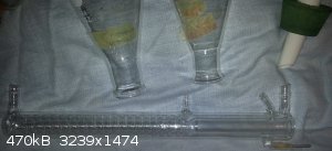

I just got a few pieces in a lot that I'm not sure what they are.
IDK what the thing is on the bottom, I think it is a condenser of some kind. The part on the right (in pic) is the top and it is open so that maybe something can drip into it, fall to the bottom, then the liquid would flow up the curled tubing and out the side middle but it also has a port/connection (2nd from right in pic) that would allow to feed with tube or over-flow - maybe there needs to be a cap/lid then the coil would be sealed. The outer jacket has 3 ports the top two on each side and one on the bottom.
condensor like thing.jpg - 470kB

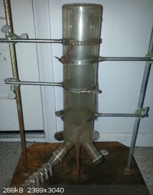

Have no clue. Was told it might be a "freeze dryer" it is very thick, has an inverted cone on the inside (could be used to fill with water liquid for cooling?) then the 4 female joints on the bottom and the bottom male joint bottom dead center.
dryer - large - 1.jpg - 288kB
dryer - large - 0.jpg - 208kB

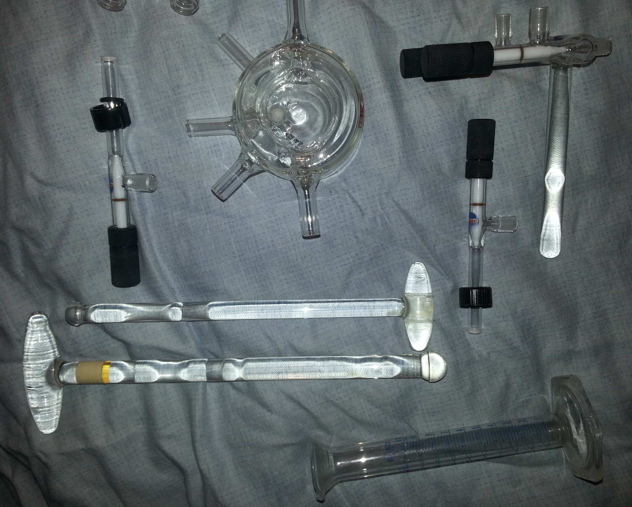

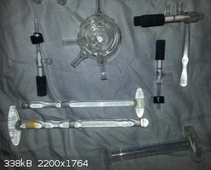

Bunch of odd pieces of glassware, most have many joints for liquid or vacuum.
glass thingies.jpg - 466kB
glass thingies 2.jpg - 338kB

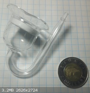

[*] posted on 10-4-2018 at 14:58
Any ideas?
It's a a glass frit, but doesn't seem like a filter... maybe it's for filtering gases or something?
20180410_090227.jpg - 3.2MB
20180410_090030.jpg - 3.1MB
Thanks.
