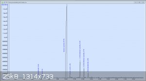

That's interesting. I have 20 grams of phenylalanine, but I was kind of planning on using it to try to make phenylacetaldehyde by hypochlorite oxidation and was unaware that any benzyl cyanide might be produced... do you have a literature reference for this?
JJay, I tried the same thing hoping to get phenylacetaldehyde; I just treated a solution of phenylalanine in water with a large excess of concentrated bleach with periodic cooling, and based on the resulting product and its odor, assumed it was the aldehyde. Until I shot in on the GC-MS at work and discovered the following chromatogram:
Benzyl cyanide from phenylalanine_Amos.PNG - 25kB
