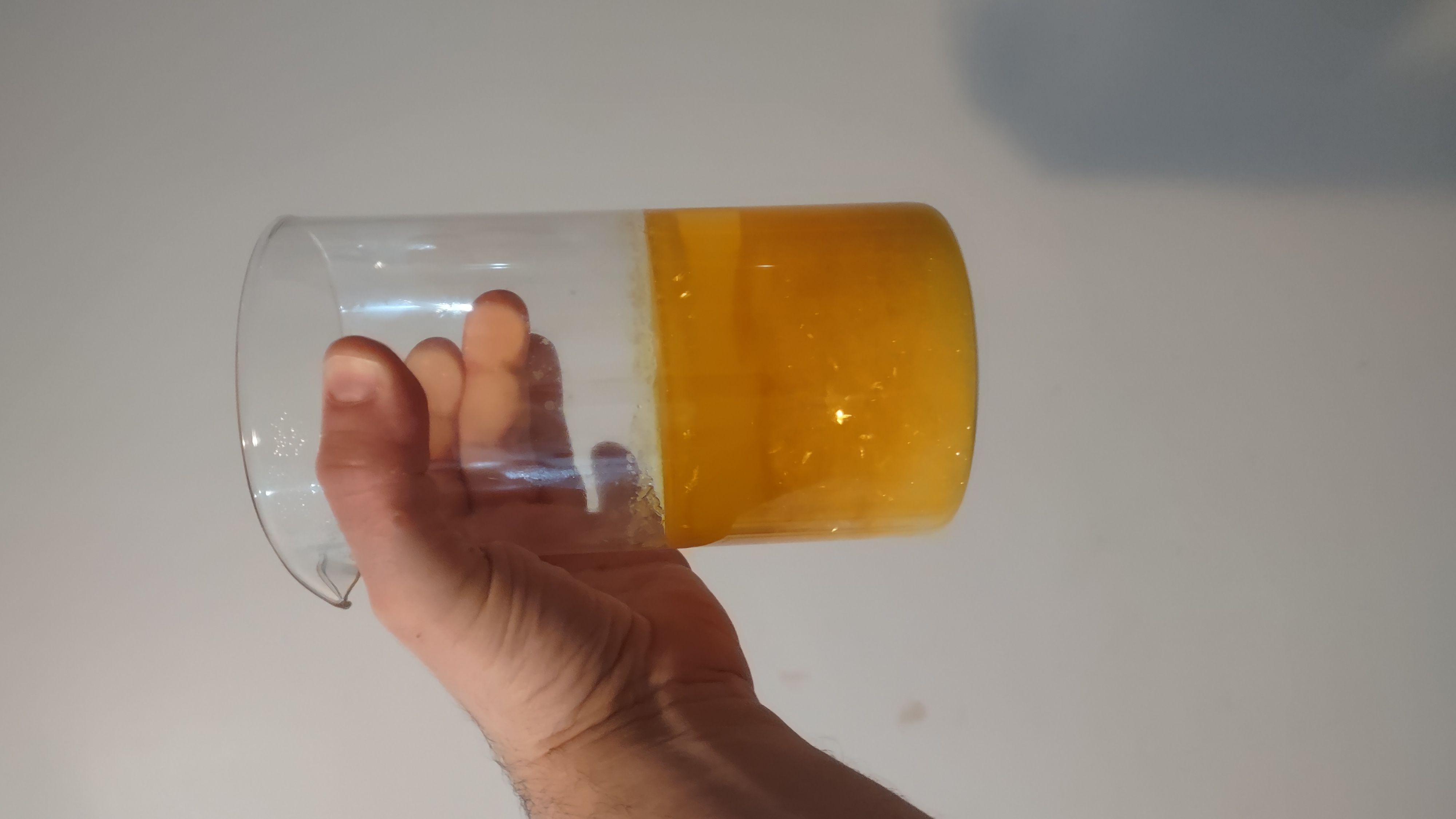

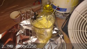

[*] posted on 21-1-2023 at 22:27
OK so I recrystalized the final batch I did last December (before my 2 liter beaker broke) and I realized that sulfuric acid can be 'cleared' in a way with changing paper towels frequently. Granted that is a very slow and laborious way of doing things so I won't be repeating it. The paper was mostly clear once I dumped the picric acid into my new 2 liter beaker for recrystalization. It was made from 50 starting ASA, but I poured in 1800ml of water and boiled it down to around 475 or 500ml of water before decanting it. I saw the VERY red blob at the bottom that I was careful to leave behind.
I still see some redness in the picric. Is that a problem when I recrystalize or no? I'm legit curious here.
For the remaining liquid, since I am confident that there is going to be some H2SO4 still left in there, I will only boil down the recrystalization liquid slightly before seeing if there is any viable picric acid crystals I can save. Otherwise it will be discarded. The solution was still very hot when I took these photos so there is going to be a lot of coming out once it cools.

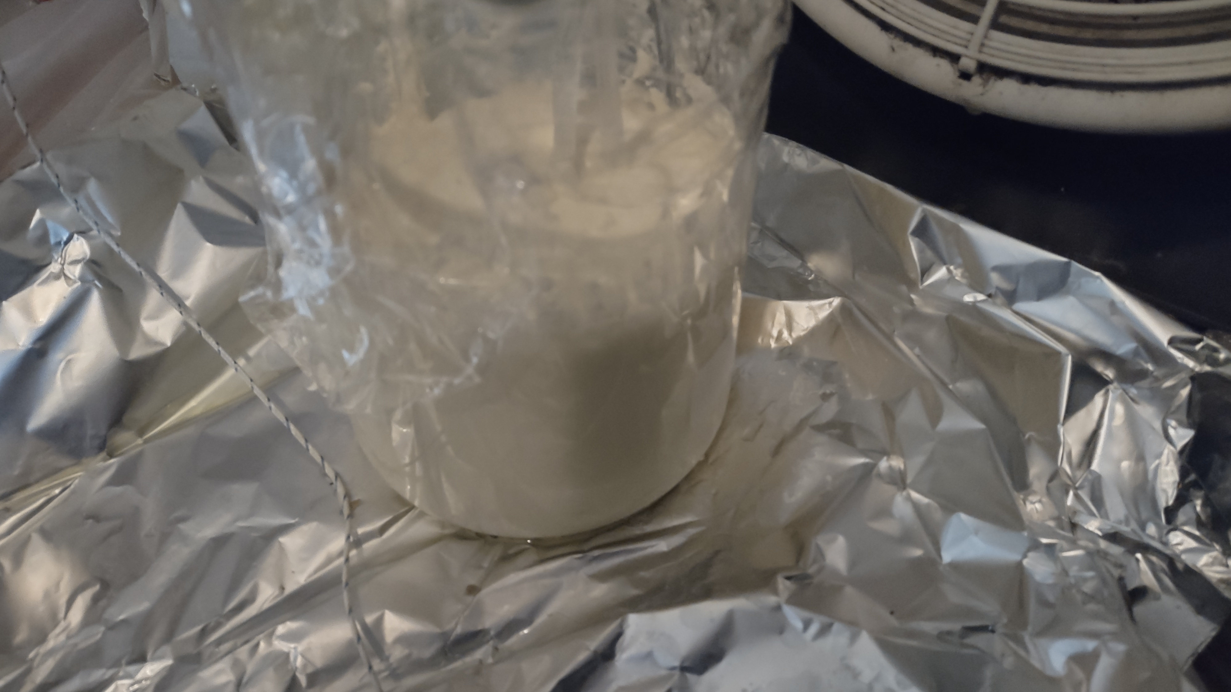

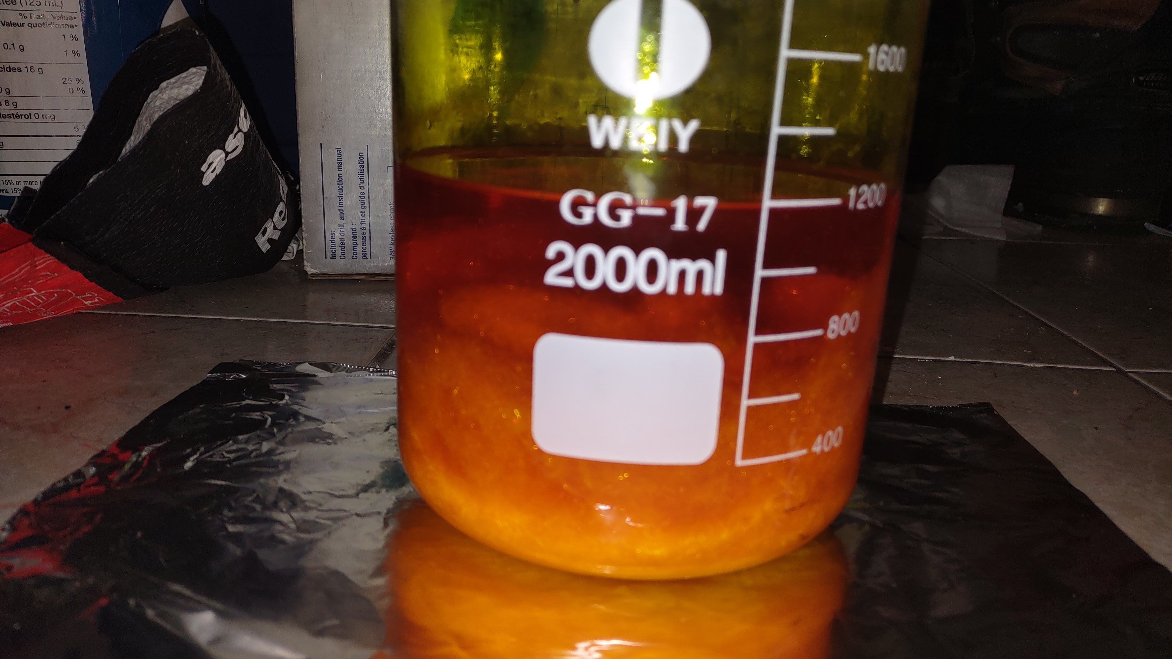

[*] posted on 13-2-2023 at 12:41
So I am back to making picric acid, this time my biggest synthesis. I originally just wanted to do 4 more 75 grams synthesis, but I decided it would be a waste of time and I could do 150 grams at a time.
I started using salcylic acid and I think it is MUCH better than ASA as I have done previously. I can't describe it, but it seemed to really work much better than ASA. More nitrates were needed, but that is not an issue I find.
So I had my gas mask on and maybe some of the fumes overwhelmed the filter and I ended up having some minor inhalation, but nowhere near as bad as the previous times. I fear that my filter is bust. I will be ordering a replacement in the future, but for now I will need to rely on it but also do what I did previously and maintain as much ventillation as possible, including doing as much of the nitration outside as possible as I did previously (NO2 inhalation was never an issue with my old system).
The main thing is that I learned really hard that the temperature MUST be kept up! While adding nitrates is an exothermic reaction. I noticed that it is not an exothermic reaction after 50% or so of the nitrate salts are added and the temperature will continue to drop. The result of this is that I had to put the beaker back on heating to get the temperature up to 95+C again. I also noticed that keeping the heating up does some good in keeping picric acid's well known foaming issue at bay. It does not eliminate it, but it does keep it more under control. I will need to do this for the future with my 2nd and final 150 gram synth as I nearly had a foam overflow. Reducing the amount of nitrate addition at a time will also do that. I do not like overflows!
I am committed on doing it a 2nd it even if the yield I seem to have here is very high. Like I was completely not expecting this kind of stuff. It must be salicylic acid since the nitrate salts I am using is from the previous batches. The sulfuric acid is obviously just the regular I've been using.
All in all I am VERY happy with all this. I will make another update next week after filtration and the 2nd batch is done. After that I will dry them and recrystalize them piecemeal since I cannot recrystalize this much picric acid at one time (my largest container is a 2 liter beaker. So 75 grams of picric is the most I can recrystalize at any one time).

[*] posted on 13-2-2023 at 13:40
Do it outside if possible.
NOx filters are not cheap, hard to find and dont last long. Prolong it's life by getting a more generic filter for your "every day use".
I remember you said you used one of Roscoe's synthesis. Apparently a short version (that works of course).
I think you would enjoy doing it in three steps "the slow way" at least once. That's just a personnal vibe I get from reading you. Plus, you'd be able to control foaming a lot more after that.
About adding nitrate and decomposition: of course you want to add a little at a time. Some of the NOx are unavoidable in this synthesis, but say you add too much nitrate in one go and you'll lose it as NOx too.
Nitric acid's boiling point is 83c, so if you're heating your nitration mixture at 95 some will get lost not matter what.
Good luck with recrystallization. I wouldnt want to be in your shoes, that's gonna be long ;)

[*] posted on 13-2-2023 at 15:46
Yeah it is going to be long. I just started adding water to the whole thing. I calculated that there is around 1100ml in volume, so I will need 770ml of water to break everything up. It'll take a while to add everything since I need to do it piece meal and put it back in the fridge to cool down (I did see some warming after adding 100ml or so). I won't be having any of that flash boiling!
As for doing it outdoors. I want to and I will do it, but it is COLD. So I hope for a day that isn't too cold and I can do the entire thing out side. But I will also have to consider that I will need to heat it up. I am aware that heat degrades the nitrates, but one thing I am very much afraid of is that if I add the nitrates when they're cold, I will have a major runaway when I need to heat it up even a little. This actually happened to me once.

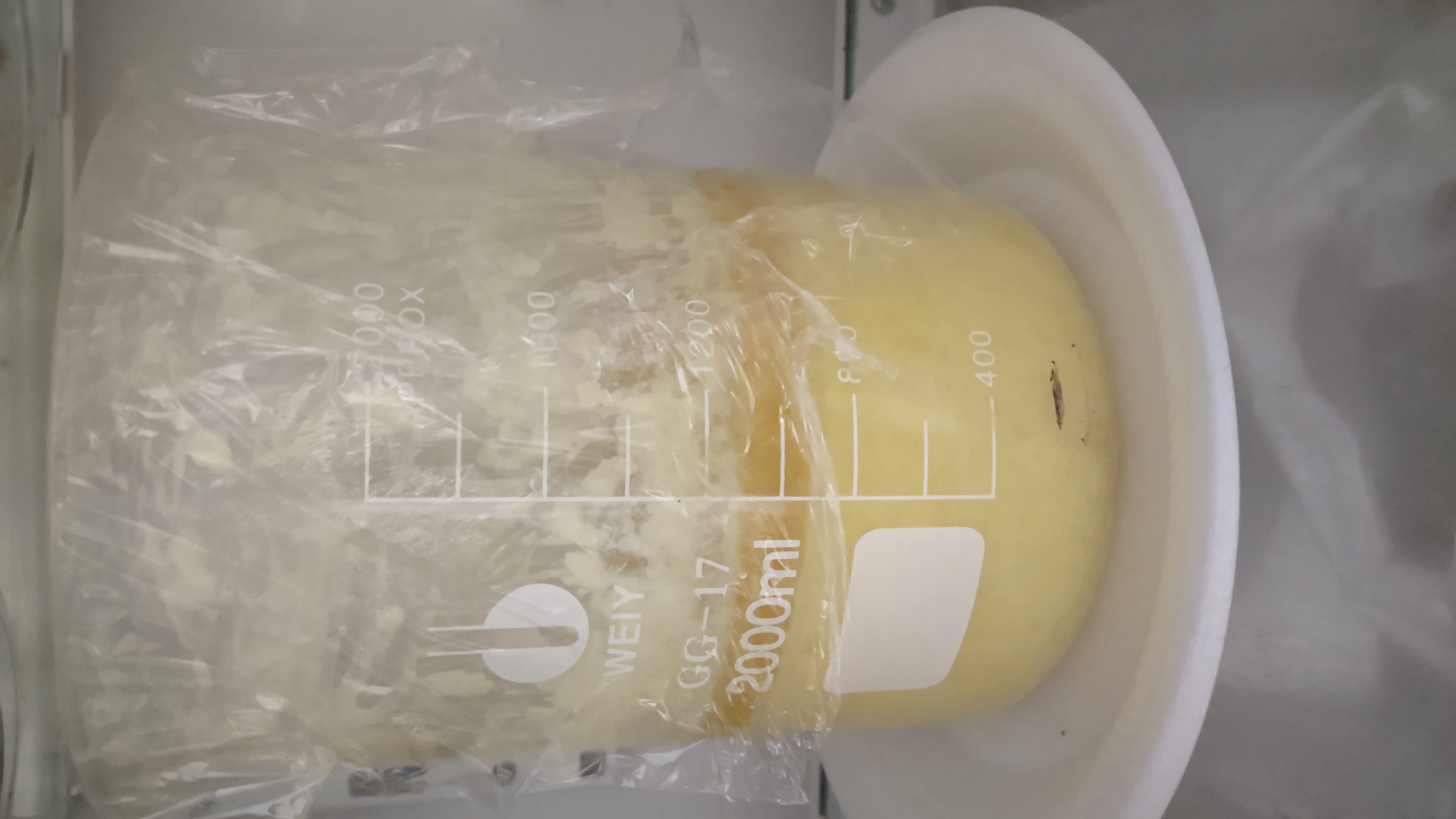

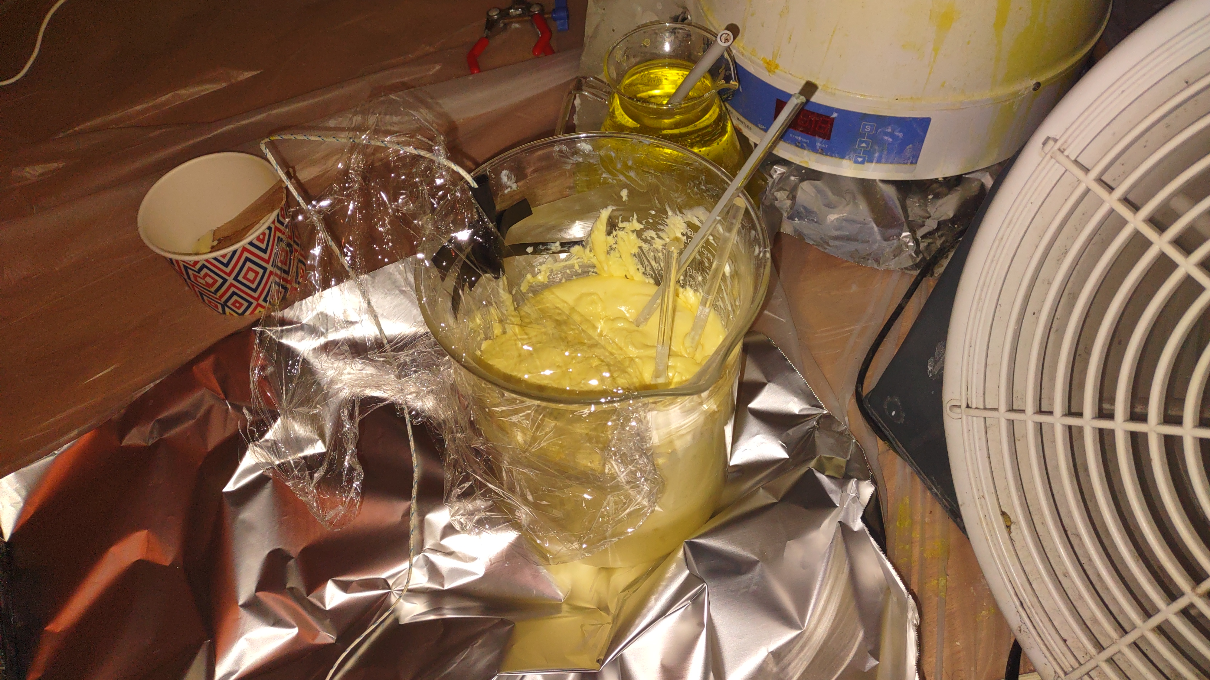

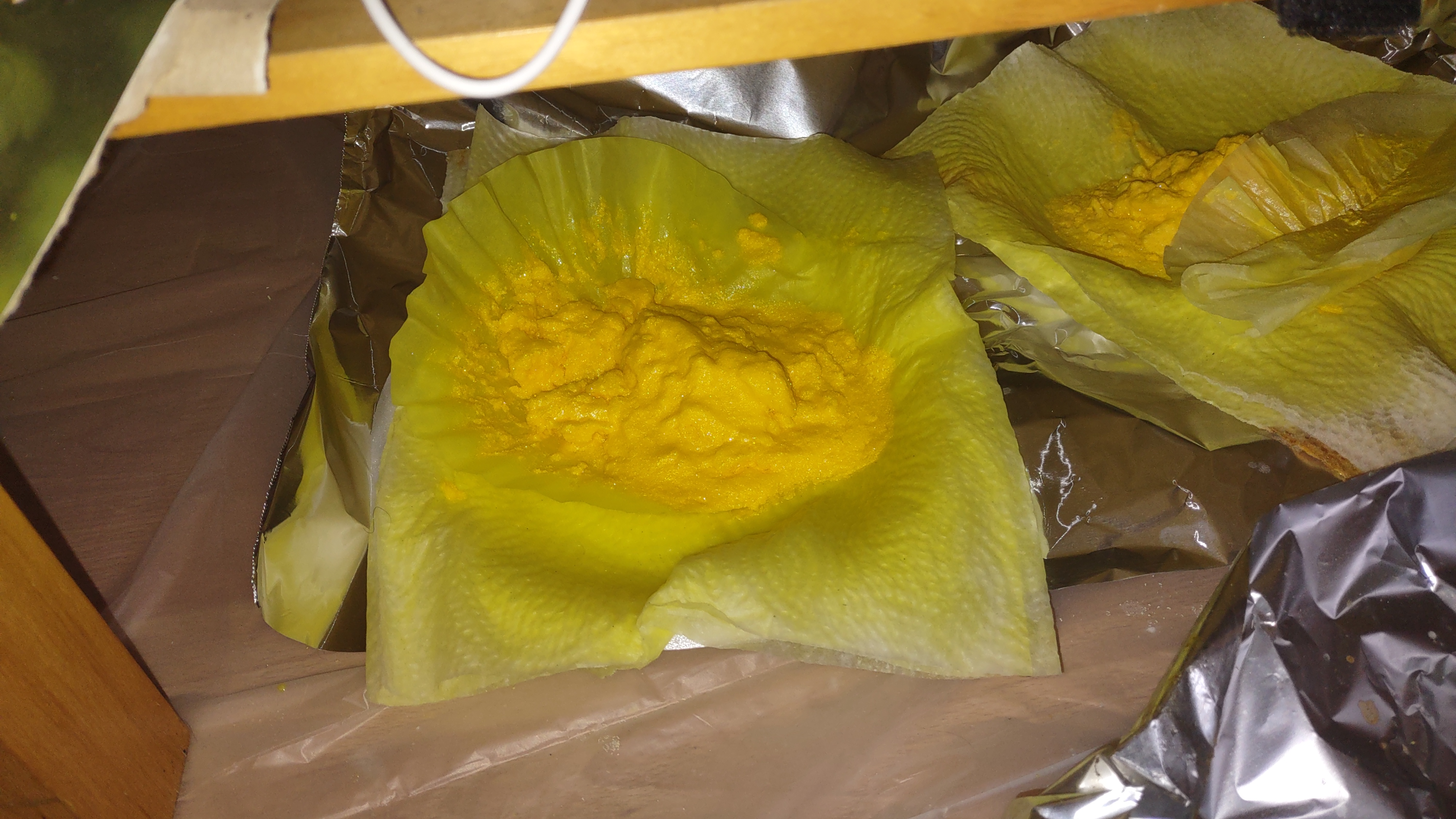

[*] posted on 19-2-2023 at 16:09
So I did the final picric acid synth and after speaking with someone on a discord group with extensive experience in making picric acid and they told me to try something differently: instead of adding the nitrate salt while it is hot, I did it while it is cold, and this is the result. I haven't done the heating step yet, and I won't do it for another hour or so at least to make sure that nothing is going wrong. Albeit so far (around 30 minutes in) I see that it is going to be OK.
The NO2 was minimal compared to the last time, but it did happen. I was indoors the whole time and there is some NO2 scent in my apartment, but it is fading fast. I think it is going to be good.
I pray that no runaway will happen during heating. In order to prevent that, I must take absolutely sure that heating is done very, very, VERY gradually. No more than 10C increments at a time.
Edit: I saw a bit more foaming happening when I was waiting. I realize I need to give it many more hours to make sure all reactions that can happen have happened before heating. The last thing I want is a runaway with this much picric acid!

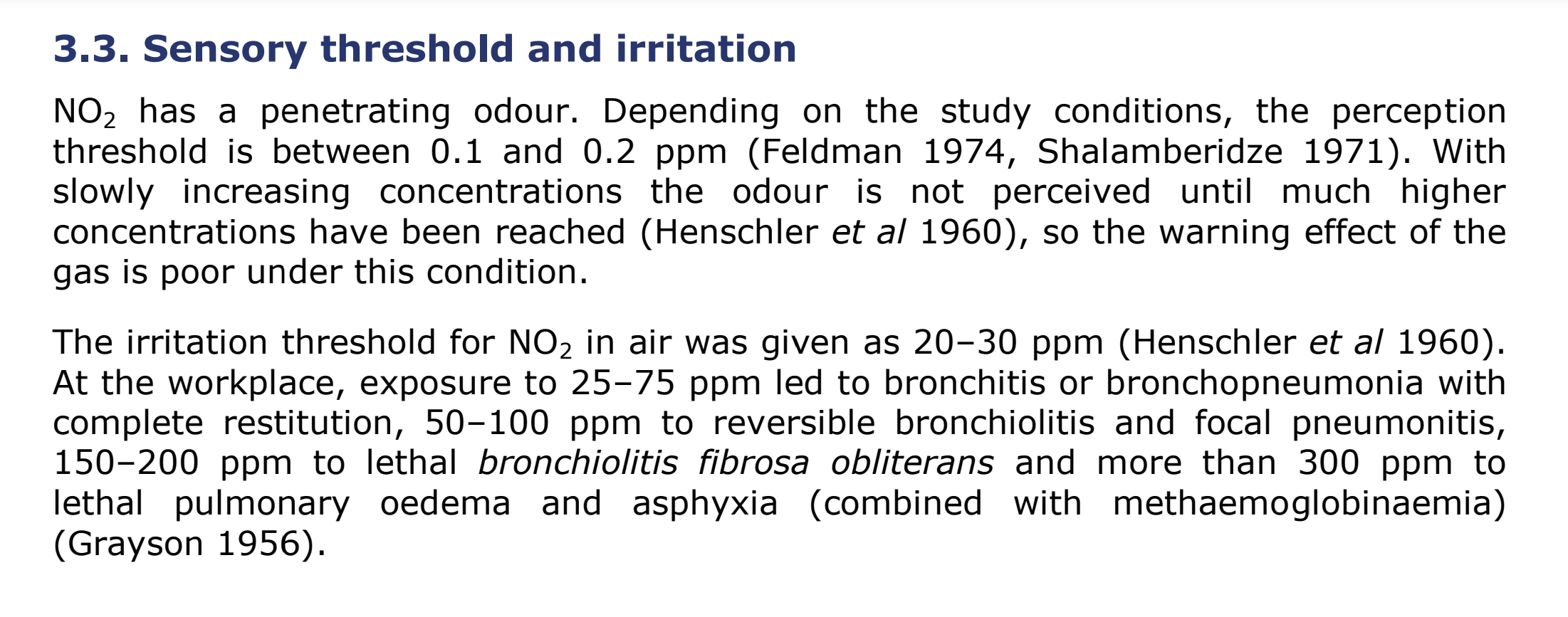

If you are doing this synthesis INDOORS without a hood/air handling, you are risking your health/life and possibly the health and lives of others.
Yes, you're likely to have issues as you heat the mixture. Foaming and/or a runaway are possible. But I'd worry more about your LUNGS.
Note on attached image that the sensory threshold may be as low as .1 ppm, but also note that in cases of slowly raised concentrations ABILITY TO SENSE LOWER BUT STILL DAMAGING LEVELS IS LOST. The max for a 4 hour exposure may be set at .5ppm, but you can't judge that by your sense of smell.
And it sounds EXACTLY like what you're probably going to be doing, trying to stretch this reaction out and run it without a proper hood and indoors.
Stop. Take it outside. Don't run such nitration reactions indoors unless you've got hood or other effective air handling equipment.

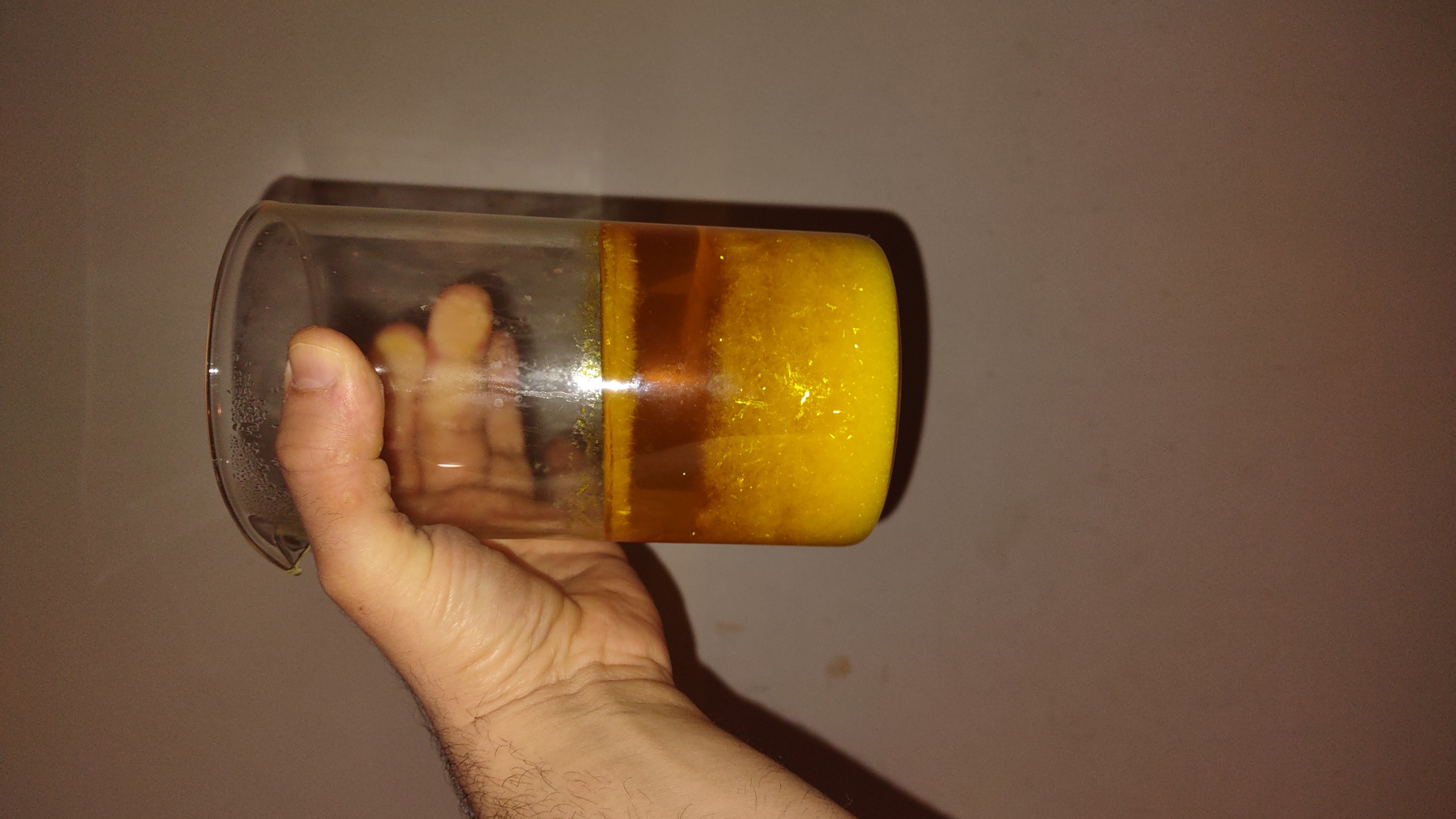

[*] posted on 20-2-2023 at 20:10
I didn't have that many problems as you are describing, but I am really well aware of the dangers. I will never, EVER do another nitration indoors. No matter what. My gas mask stopped most of the gasses, but not all, which is why I didn't have much problems this time. But I am extremely well aware of the dangers. I have had NO2 inhalation issues and I REALLY FUCKING HATE IT!
I spoke with a doctor about it and they did advise more precautions.
I realize that I simply must take seasonal breaks if need be. Winter time is a problem in my area not just due to the cold but often times due to the snow (electronics and moisture don't mix well). I must accept that there is no shame in waiting a few months before doing something like this.
At any rate, my 2nd synth is fully complete, and the weather outside was well enough that I could do the heating step outside (and it was essential). I ran into difficulties with my thermometer which was often inaccurate, but I took great precautions to make sure that I was heating everything SLOWLY and in gradual steps to allow for any reaction to happen piecemeal and prevent a runaway.
When I heated it to 75C I decided to go all the way and when it reached 100C it did start to bubble with red NO2 gasses forming, but I did it outside and the wind was on my side so all dangerous gasses were blown away.
It has cooled down to near room temperature now and you can see it in the photo. I am not going to do any more picric acid synths for a very long time. I got too much already and nothing more to prove or explore with it.
I'll be fine, and I will be taking a break from most chemistry for a good long time to focus on other things.
For this and my previous synth, I will make sure everything is dried up before doing a recrystalization of everything and post my final results here when that happens.
IMG_20230220_225522507 - Copy.jpg - 1.2MB

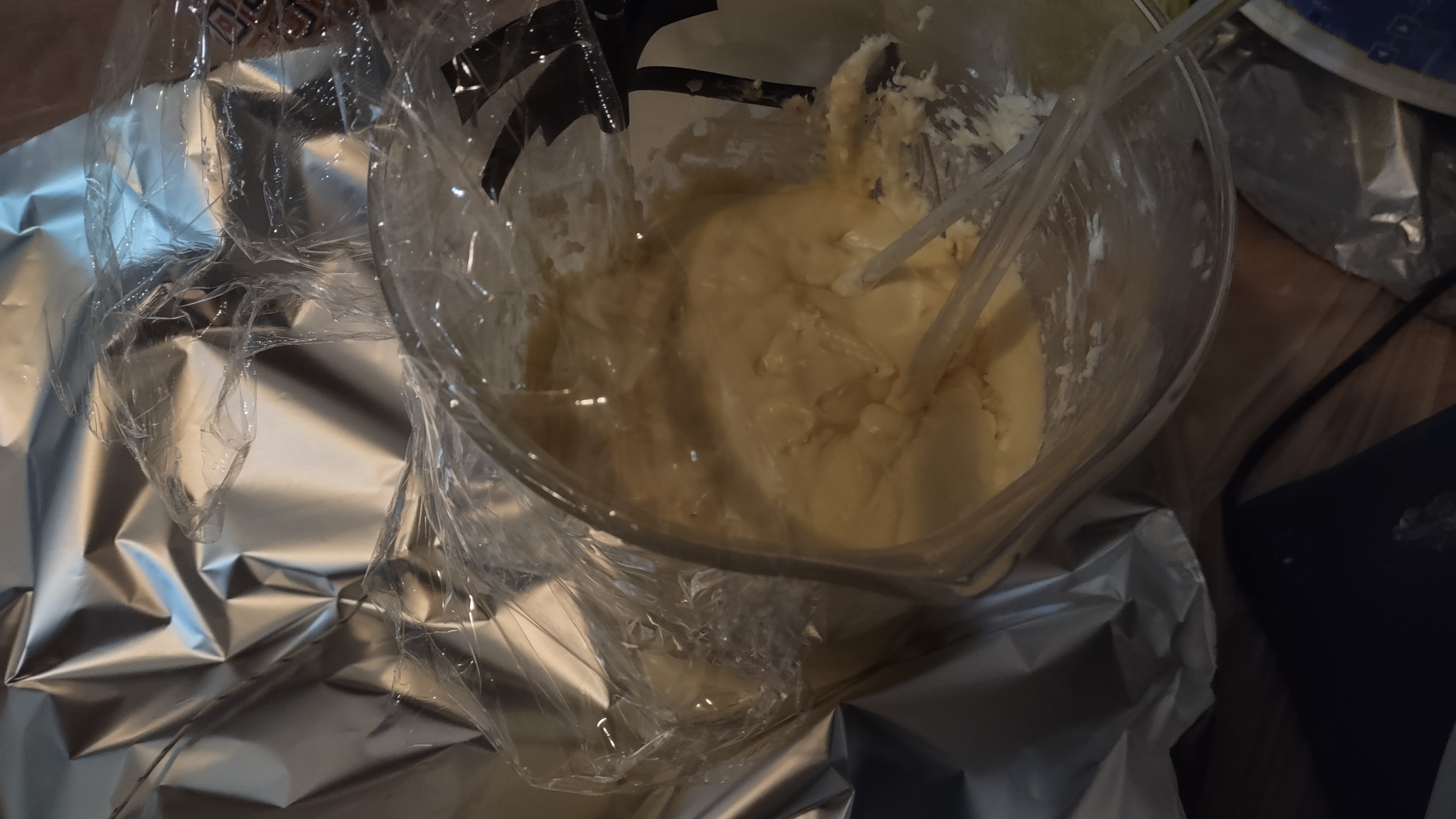

OK so some final notes on this. While the final yield is obviously to be decided. I had to use a lot more water to crash out the picric acid because I could not break up the chunk that was at the absolute bottom. One thing I needed to keep in mind for the future (if I ever do this again!) is that I probably will need to add water to the acid BEFORE I put it in the fridge. Obviously the water must be ice cold and it must be added dropwise (for all practical purposes) as putting the picric in the fridge caused it to solidify both times. But in the first time I was able to breka up the chunks somewhat without excessive water. I was not able to do so in the second time in the end had to pour in boiling hot distilled water.
That's a note to self for the future.

[*] posted on 24-2-2023 at 18:05
Wow. I dried out the batches separately. I am quite astounded. From my first 'hot' batch I measured out 315.60 grams from a starting 150 grams of salicylic acid, 600ml sulfuric acid (h2so4) and 270 grams of KNO3 (potassium nitrate).
my 2nd batch of similar reagents but double the distilled water (around 1300ml instead of 800ml water) is 242.52 grams. This means I ended up with a raw unrecrystalized total of 552.54 grams.
from 300 grams of salicylic acid this is a total of 1.8418 grams total. Even Rosco only made a total of 1.2g surplus, not 1.84. Then again, he started from acetylsalicylic acid, and not salicylic acid.
I am both proud and terrified of myself! Going to report the total weight after recrystalization.

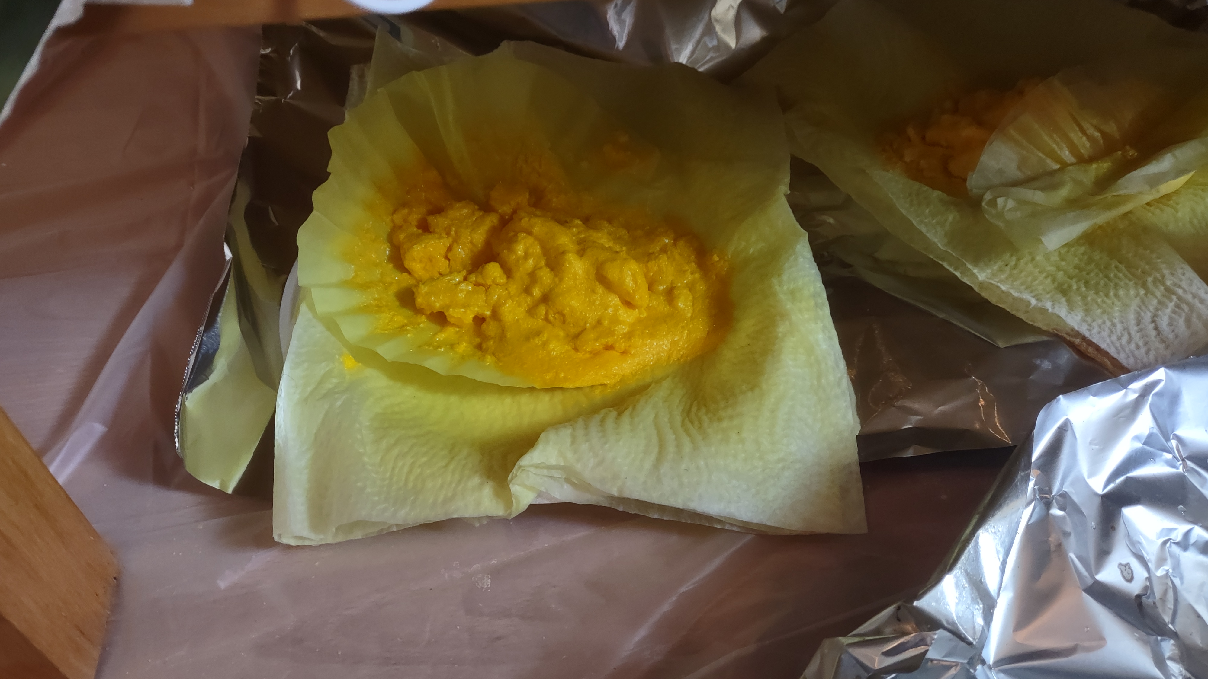

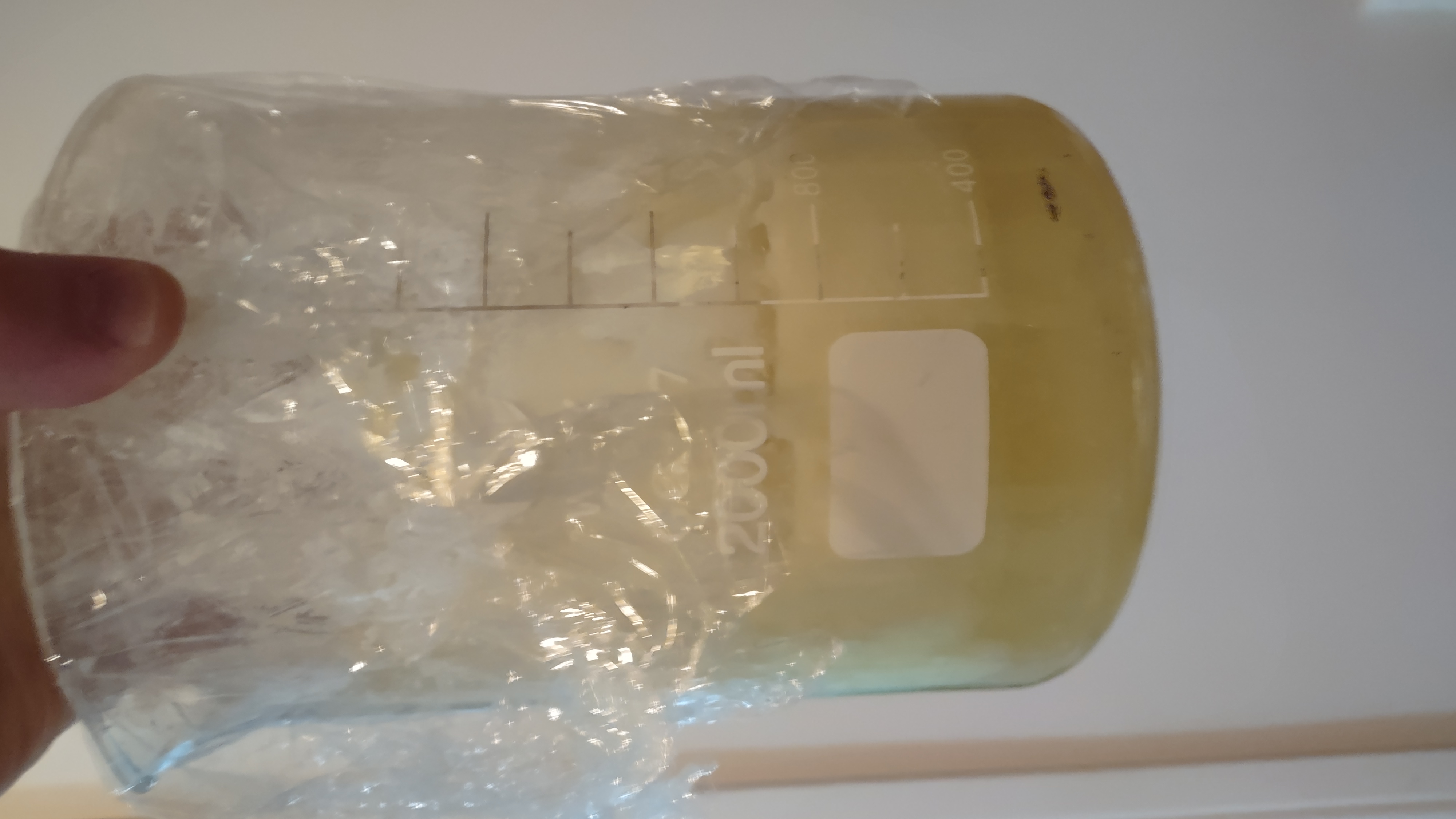

[*] posted on 26-2-2023 at 11:46
I got one question... I got a lot of left over liquid (which I will boil mostly down, but leave only a little left since I am confident that the remainder will have whatever is left of the sulfuric acid in it) but after boiling it down, and even when cooling down slowly, the picric has a reddish tint to it.
Is this a problem? did it degrade or something happen to it? I need to mention that in my previous synths using ASA There was a lot of blobs of impurities at the bottom, but in this circumstance, I find nothing. I believe this cold mean that I have some extremely pure picric acid right off the bat. But a recrystalization is always a good idea, if not to get some better crystal shapes.
But I am worried about the reddish tint to everything. Why does that happen? I know that when you dissolve picric acid in hot water the color of everything turns red, but is that an issue that I should be concerned about?
IMG_20230226_142648639 - Copy.jpg - 1.9MBIMG_20230226_142654263 - Copy.jpg - 2.1MB

[*] posted on 26-2-2023 at 14:45
I assume you are not trying for mass production here? The whole idea of taking the liquid off your crude crystals is to get rid of all of your impurities. Your liquid will contain all sorts of impurities and is best neutralised and discarded. If you chilled your initial reaction mix right down you are likely to be disposing of no more than several g of picric acid per litre. Best to focus on your crop of crude crystals and getting them purified. Trying to increase yield by extracting product from your waste solution is of no real value unless the desired product is high value or you are trying to optimise an industrial process. With energetics in particular obtaining a pure product is very important. You don't want to be introducing unknowns.

[*] posted on 26-2-2023 at 18:02
It worries me that you synthesized such an amount. You dont need that much for proof of concept.
I agree with B(a)P, focus on purifying what you have. As for getting most out of the mother liquor, I'd say you reach a point quite fast where you have to invest a huge amount of time / energy for diminishing results. I'm not saying dont to it, it's educative and you can get interesting shapes from those crystals. But after doing it once and weighting the results you probably want to focus your efforts on your goal.
I reached this same conclusion with silver refining. I spend an awful amount of time to get all the silver out of solution. Litterally miligrams... And then when I spill the same amount on the table I just wipe it off with a sponge...
If you're worried about your PA still having some impurities just recrystallize it once more. Do the maths: how much PA you have, how much water you'll need, how much PA will be lost still dissolved in the water at room temperature ?
Not enough for you to care about it.
But man... I'd never want to recrystallize that much with just water. Is IPA / ethanol / methanol available for cheap where you are ? All would work as co-solvents. As for the ratios... well... eyeballing works as long as you've kept enough volume in your container to add more alcohol.
Hot filter, let cool to room temperature then filter out the PA. No need for a final wash. Drying should be faster than with plain water. I see in your picture that your PA is a bit damp. You can squeeze out water when picking it up with your disposable gloves. BE CAREFUL ! Dont break the filter ;)
Important note: if you use a co-solvent as I suggested PA form will be different than from water. IPA is cheap, some people dont recommend it because it makes platelets / scales that are "hard" to pour and to pack for maximum density.
Sieving through a fine plastic strainer will get you powder. Wear a mask while doing this or enjoy the bitterness of PA in your throat ;)

[*] posted on 27-2-2023 at 20:03
I know how you feel. I had no idea I would end up with this much. My guess is that the Salicylic acid is so much better than the ASA that I used that I ended up with much, much more than I ever thought I would end up with. Most of the picric will end up in a bonfire when I am done with all this because I really don't need that much. I know it burns well but will not explode, which is important. Like I said, when I used ASA I didn't end up with this much surplus. I usually got roughly around what I put in, or even less (and that's only the crude yield. After recrytalization I ended up with far less as well). If I had known I would have gotten 1.84 grams per 1 gram of salicylic acid I would have done just one synth of 100 grams of salicylic as a 'final exam' and called it a day. I seriously underestimated what my final result would be, and it was likely due to the ASA I was using probably wasn't as pure as I thought it was. The salicylic acid I got? That stuff is as pure as it gets.
The mother liquor is gone. The stuff I will be boiling down is the liquid I used to recrystalize, but I will be leaving behind a few hundred ml to make sure that any left over H2SO4 is gone and ditto for any other impurities.
IPA and methanol are super cheap, and I have a good supply of 95% ethanol, too. For using water this stuff takes HOURS. I use 2100ml of boiling hot water (I preboil it before pouring it in the beaker) and then start the heating. Since it is already hot the heating won't be necessary. It takes around 4.5 or 5 hours to make it down to 700ml or so before I take it off the heat.
The picric is damp and I am willing to give it a squeeze. I learned that when filtering it I need to use 4 coffee filters on top of one another in order to make sure the filter is strong enough for a good squeeze with breaking. And I always use glove. I have lots and lots of disposable nitrile and vinyl gloves available. ditto for masks. I have lots of surgical masks to use in addition to my gas mask.
And I said it before and I will say it again. I am done making picric acid. I think after making all of this I have proved to myself that I can make it. I need to move onto something else! :D To be honest after this, most energetics making is starting to get repetitive and I might even retire from chemistry for a good long time. I still got other journeys to go on in energetics making, but those are for another time and another topic!
Edit: To a large extent seeing my yield made me think of the video from WessonSmith (the NHN guy who doesn't post here anymore) who has a video where he made what appeared to be dozens of grams (if not over 100) of NHN. That was... heart stopping!)
