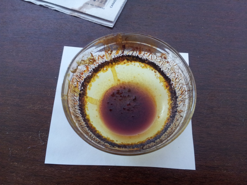

[*] posted on 29-1-2014 at 07:05
I tend to believe you, that larger well defined crystals giving a higher density product will perform better, since you usually have the right idea about these sorts of things. I was originally thinking that as long as the less dense material was pressed to a high density in a cap that it would perform well. I don't completely understand it, but it does seem logical that a higher bulk density of the loose material would be advantageous from a performance perspective.
Regarding evaporative recrystallization, after a couple hours of waiting, the level of the solution was not dropping at all so I poked more holes in the aluminum foil covering the small glass dish. It has been about 16 hours now since I poked all the holes in the aluminum cover and there is still about 5 mL or so of the 22 mL of acetone remaining. Ambient temperature is, and has been, about 20C.
DDNP Evaporative Recrystallization.jpg - 196kB
[Edited on 30-1-2014 by Hennig Brand]

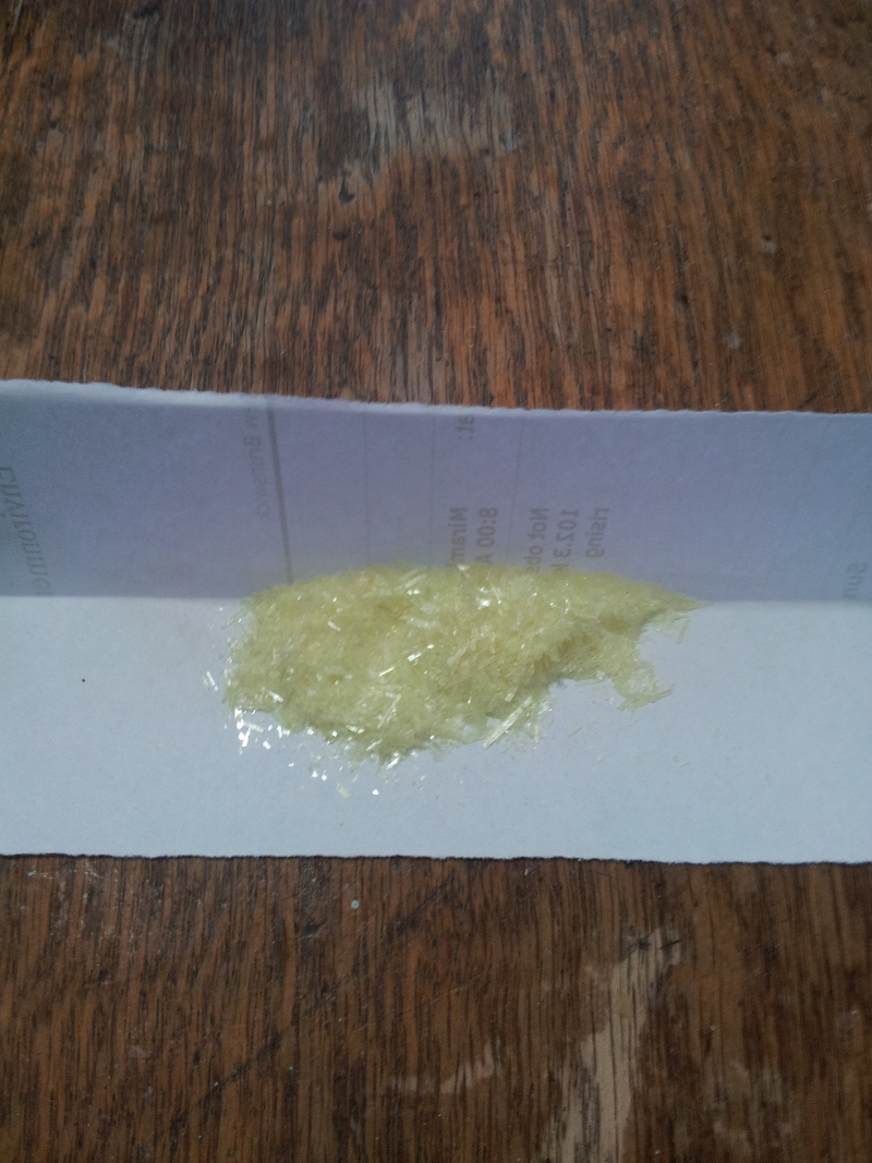

[*] posted on 29-1-2014 at 15:12
The perforated aluminum cover was taken off the evaporating dish at about the 18 hour mark. There was still 1 or 2 mL of acetone left. Water was added to precipitate any remaining DDNP (no more seemed to precipitate) and wash the crystals. After filtering, the filtrate was very red (which I forgot to get a picture of). Yield from the recrystallization was about 95%. A more accurate value for yield could not be determined with the scales available to me at the moment. A small amount of material was not recovered from the sides of the evaporating dish, so the yield was likely closer to 97-98%.
The density has been increased immensely. Dark brown tabular crystals formed on the walls of the dish, which had largely fused together by the end of the evaporation. A small amount of lighter brown/yellow material was at the bottom of the dish, in the 1 or 2 mL of acetone, and looked to be cubic crystals.
The density difference really is amazing. The second picture is of the damp, high density, material right after being removed from the evaporating dish. The third picture shows one gram of unrecrystallized material on the left and one gram of recrystallized material on the right.
Evaporated DDNP Solution.jpg - 248kB Dense DDNP after Solvent Evaporation.jpg - 170kB Unrecrystallized versus Recrystallized.jpg - 221kB
Contrary to my earlier perception, it seems that this method does also purify the DDNP. Yield is also obviously very good with this type of recrystallization. Yield would be 100% (all solute recovered) if all the solvent had been evaporated. I believe some impurity was removed by adding water before the last bit of acetone had evaporated, however, given the appearance of the filtrate.
I think that little bit of lighter brown material sitting on the bottom of the evaporating dish was probably the result of my not being careful enough to ensure that absolutely all of the low density crude DDNP had dissolved before putting on the aluminum cover. Next time I will be a little more careful to verify that all material has dissolved.

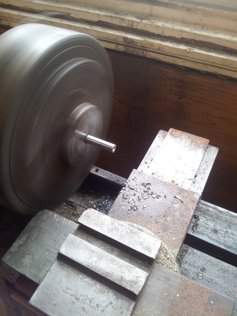

[*] posted on 31-1-2014 at 13:48
Reinforced Detonator
I attempted to improve my DDNP detonator design today and detonate some picric acid. A reinforced detonator was constructed. Aluminum round stock was going to be used to make the reinforced cap or insert, but was not readily available so carbon steel round stock was used instead. The outer casing was made from a piece of aluminum arrow, with inside diameter just shy of 5/16". The inner reinforced cap/insert was turned on a lathe, from 5/16" carbon steel round stock. It was sized so that it would fit snugly inside the outer casing and would need to be pressed into place. The reinforced cap/insert was drilled out for 1/4" and a 1/16" hole drilled in its end as a flash hole to except fire from the fuse or igniter. Four inserts were made, each taking about a half an hour to make.
Test
Base charge: 2.2 g picric acid from ASA (melting point indicated at least 98% pure)
Primary: 0.5 g DDNP recrystallized by evaporation
Flash igniter: 0.2 g basic lead picrate
Cap outer dimensions:
Length: 6 cm
Diameter: 9 mm
The flash igniter follow by the DDNP were pressed into the reinforced cap/insert. The picric acid was pressed into the outer cap casing (aluminum arrow piece). About 0.2-0.3 g of picric acid was poured in last and the steel insert containing the primaries pressed firmly on top. A little black powder was put in last follow by a fuse and a little hot melt glue as usual.
Witness plates:
base: 1/8" steel
side: 40 thousands of an inch steel
The DDNP reinforced cap failed to detonate the picric acid, which sort of surprised me. I was really expecting this to work.
The bottom half of the picric acid base charge was recovered with the picric acid still in place in the casing (about 1 g).
Lathe 1.jpg - 447kB Lathe 2.jpg - 493kB Reinforcing Inserts.jpg - 260kB Picric Acid.jpg - 394kB Loading 1.jpg - 163kB Loading 2.jpg - 396kB Loading 3.jpg - 267kB Cap and Witness Plates.jpg - 173kB Pre-Test.jpg - 415kB Post Test.jpg - 453kB
