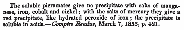

With regards to an alternative candidate transition metal salt that could function in small quantity as a regenerable catalyst not being sequestered as picramate during the reduction any of the ones described by Girard in 1853 may work as well as does the copper for the actual reduction, but by remaining in solution can be regenerated. For example, nickel sulfate, or possibly better nickel acetate or other organic acid nickel salt, is a candidate.
And these reduction schemes may likewise be applicable to styphnic acid for reduction to styphnamic acid for diazotization to DDNR.
soluble picramates not precipitated Girard Comptes Rendus 1853.bmp - 192kB

Manganese, iron, cobalt, and nickel are likely and each would probably be optimal at a particular pH, temperature, and concentration which would need to be "process engineered" by the chemist / technician /operator keeping that pH and other parameters in mind with regards to order and time of addition and the reagents used.
My intuition about these was first on Manganese due to good solubility of the picrate and picramate, but what is the sensitivity with Ascorbic or Ascorbate is unknown. Nickel was another thought because of similar chemistry with copper but no report of an insoluble picramate to complicate things.
My collateral thoughts about buffering using Magnesium as the base was likewise good solubility for the picrate and picramate and having a limited swing for pH inherent by use of Magnesium for the base. Likewise using organic acid salts instead of mineral acid salts would dampen pH swings. And my thoughts regarding glycine as potentially useful related to a twofold potential usefulness as an organic acid buffer and solubility enhancer via chelation as well as a solubility enhancer for picric acid in a low pH reduction system which would enhance the activity of Ascorbic acid at a lower and optimum pH of about 2-3 pH where free Ascorbic acid is at peak activity as a 2H (++) value reducing agent.

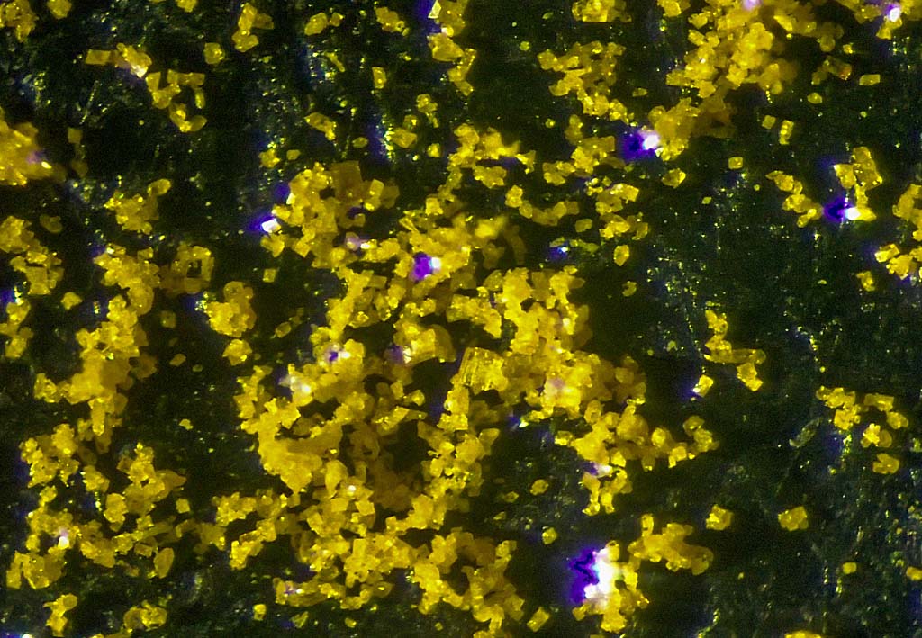

Been doing some additional experiments involving styphnamic acid and it's diazotization, all is done on an extremely small scale (50-100 mg) due to the hazards of these compounds, so not very precise. The solubility of the styphnamic acid in hydrochloric is very particular. Adding very concentrated (30%) hydrochloric to the deep orange-red stypnamic, a light yellow precipitate is formed, probably of the chloride salt, that is nearly insoluble in the concentrated HCl. When the mix was carefully diluted stepwise and weighted, the maximum solubility of styphnamic acid in HCl seems to be at around 13-17% HCl. Further dilution results in a pretty sharp dissociation boundary, where the light yellow chloride salt transforms instantly back to the orange-red free styphnamic acid. Since the solubility of styphnamic also depends on temperature and total volume of acid added, this would be a lot of work to all sort out. It would also not be very meaningfull since the solubility of the diazoquinone in HCl seems to behave very different as that of styphnamic itself.
Diazotization using 20% HCl at 0 deg C. produces scales or cubes of a very light yellow compound, probably the chloride salt as guessed earlier, strange thing is that it seems to need 2 mole eqvts of nitrite in order the precipitate the light yellow chloride salt of the diazoquinone, but maybe I'm just impatient...hmmm...weirdness...:D The putative chloride salt in itself seems pretty explosive and large losses can occur due to the relatively high solubility of the diazoquinone in HCl. A better option seems diazotization in 30-60% sulfuric. The sulfate salt seems less explosive as the chloride salt, presumably due to the bulkyness of the sulfate group and recovery of the acid salt seems higher.
The potassium salt seems most interesting (if these are really salts and not the free diazoquinone), it is relatively insoluble in cold water and shows higher brisancy compared to the sodium salt. It is easily made by neutralizing the chloride/sulfate salt using bicarbonate to almost neutral and precipitation using saturated KCl. Upon recrystallization from hot water, the potassium salt precipitates as very fine light yellow needles clumping togther. It behaves INCREDIBLY brisant, the tiniest specks blow holes in aluminium foil, like an azide or tetrazole derivative would. Also did a rough explosion temperature measurement on my hotplate, surprisingly the explosion temperature seemed at least equal or even higher than that of the 2,6-dinitro 4-diazo resorcinol derivative, immidiate explosion temp. estimated around 250-260 deg C. Maybe due to higher purity.

Tdep
Posts: 521
Registered: 31-1-2013
[*] posted on 13-12-2018 at 21:56
[Edited on 14-12-2018 by nitro-genes]
Very interesting. Could you test if there is indeed potassium involved? Making up a sat solution in warm-ish water, then adding in some NH4/NaClO4, should give you a clear positive test for potassium
nitro-genes
Posts: 1048
Registered: 5-4-2005
[*] posted on 14-12-2018 at 03:36
That would indeed be a good idea, though I don't have any perchlorates available anymore. Experimenting with this putative diazoquinone on a very small scale is really difficult, no idea actually what is the acid salt (if exist at all) the free diazoquinone and metal salts. If the diazoquione is very acidic, the acid would just precipitate more due to less deprotonation, similar to picric being less soluble in dilute HCl. Been thinking that the putative sulfate salt could be analyzed using calcium salts. At these scales though, adding 1 drop of something can mean the difference between obtaining a precipitate or dissolving everything. For these kind of experiments you would also really need to wash things properly or perform at large scale, both are rather difficult and/or dangerous.
Talking about perchlorates and dangerous....if the precipitate obtained after diazotization of styphnamic truly is an acid salt of the diazoquinone, I wonder if a diazonium perchlorate would also exist and would precipitate, it would be like the ultimate primary from hell probably. :o:cool::D It is good that I don't have any perchloric acid, or would likely loose an eye or some fingers....:P
nitro-genes
Posts: 1048
[*] posted on 20-12-2018 at 17:08
A test was done to determine if the compound isolated after diazotization of styphnamic is an acid salt or free diazoquinone:
Experimental:
0.5 g styphnamic was dissolved in 6 g of 50% sulfuric with slight warming, forming a very light yellow solution. Upon cooling to <0 deg C, there was no precipitation of the sulfate salt (as can occur with concentrated HCl). Then, 0.17 g of sodium nitrite was added to 1.5 ml water and added dropwise while in an icebath, some foaming was observed near the end of the reaction. Halfway the addition (about 15 minutes in), light yellow crystals started forming. After stirring for another 60 minutes after the last addition, the light yellow crystals were filtered off, blotted dry as best as possible using paper towels and dried for 8 hours at room temperature. Yield after drying was 0.49 grams. The dried precipitate is somewhat flame sensitive, burning with an orange flame and sustains deflageration (although burnrate is very slow). Heated slowly to ignition point in 2-5 mg amounts on a spatule, it never produces a detonation though.
The dried compound was cautiously transfered to a 20 ml beaker and destilled water was added dropwise at room temperature untill all dissolved. In total, 0.82 grams of water (at room temperature) was needed. Then, 3 ml of a pH 7 buffered ~10% calcium acetate /acetic solution was added, total volume adjusted to 10 ml, and kept at 4 deg. C. overnight. Only ~15 mg of calcium sulfate could be recovered after overnight at 4 deg C. Then, 1 ml of the filtrate was transfered to a 5 ml beaker and a few drops of a near saturated KCl solution added while swirling. The solution immediately became almost solid in apparance from abudant precipitation of light yellow needles of the potassium salt.
To the rest of the filtrate containing the very soluble calcium salt of 2-diazo 4,6-dinitroresorcinol was added a slight excess of ammonia. N2 gas was evolved (quite slowly though) and long, light brown needles formed after 24 hours in the cold, presumably of 4,6-dinitropyrogallol or it's ammonium salt. It burns only weakly energetic after drying.
The nitration of styphnamic was also attempted:
Experimental:
0.5 grams of styphnamic was added to 7.5 g 97% sulfuric acid. The styphnamic formed sticky lumps when contacting the sulfuric and was very hessitant to dissolve, though eventually (and with a bit of persuasion) a light yellow solution was obtained. This was cooled to 0 deg C. in an ice bath and slowly 0.6 g KNO3 was addded over the course of an hour or so. The light yellow solution became an incredibly dark red (like red wine). After stirring for about 3 hours in total, the reaction was left on ice without stirring for another 12 hours. At this point the solution had become a light yellow-orange. While still in the icebath, about 15 ml's of ice cold water was added dropwise. A lof of NOx was released. After another 8 hours or so at -20C, yellow-orange and 3-5 mm long needles were present in the solution (judging by the colour, there might have been a lot more product left in the filtrate, perhaps less water would need to be added to precipitate more). The needles were filtered off, blotted dry with paper towels and after drying weighed about 100 mg. A few mg's on a spatule when heated slowly results in detonation. It also sustains deflageration from flame, flashing off reasonably quickly, leaving a large black stain. All in all, it seems more energetic as the product obtained from diazotization of styphnamic using nitrite/50% sulfuric above.
The rest of the product (~100 mg) was added to a 5 ml beaker, and distilled water again added until all dissolved. It needed 4.68 g of water to all dissolve, so also it's solubility seems very different from that of the product obtained from direct diazotization. A bit of calcium carbonate was added until the pH was neutral and a few drops of a saturated KCl solution again added. Upon cooling for several hours at 4 deg C., there was no precipitation of a putative potassium salt. Solid KCl was added untill nearly saturated and cooled again. Small golden-orange cubic crystals of a potasium salt appeared (attachment), which behaved very energetic. So, also the solubility and colour of the potassium salt seems different than the product obtained from styphnamic diazotization. When touched by a glowing splint, it seems to make DDT in an even smaller amounts as the light yellow potassium salt of 2-diazo 4,6-dinitroresorcinol itself.
Although it is quite possible that the nitration of styphnamic produced a small yield of 2-diazo 4,6-dinitrophenol from the nitrous produced, it is tempting to speculate that a diazodinitrophloroglucinate resulted from the nitration by a putative 2-amino 4,5,6 trinitro resorcinol derivative! :D
Potassium salt diazodinitrophloroglucinate maybe - Copy.jpg - 187kB
