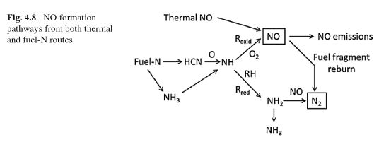

I'll share my hypothetical idea for achieveing this task for others to use if they so desire.
The combustion of fuel results in the production of nitrogen oxides. Of the many mechanistic sources by which these may be produced, so-called 'fuel derived NOx' can produce the most if combustion is carried out with excellent airation, AFAIK. Fuel NOx is NOx that is produced from nitrogen atoms in the fuel molecule itself, for example, from burning amines.
So hypothetically, burning a very nitrogen rich fuel should produce lots of NOx in the flue gas which can be used to make nitric acid by subsequent absorbtion and oxidation.
Beware though that burning nitrogenic fuels can also produce cyanide, but I think this is more an issue when the combustion is carried out with insufficient air.
Theoretically, one could use fuel tablets as a nitrogenic fuel (from the hexamine component), however, these aren't exactly cheap. Soybeans, what with their ~36% protein content, IS a cheap bulk nitrogenic 'fuel' :)
I know this is very hypothetical, but I don't think it's too crazy, or is it?

Well I was thinking that for a large apparatus, one could have a suitable steel tank as a combustion chamber in which a large radial and horizontal metal fan sits at the bottom and beans are fed in through the top, somehow.
A blower blows air in tangentially at the base, close to the radial fan. The beans are constantly bashed and tossed around by the spinning fan, this ensures that they burn well with excess air. It would also break off any ash forming on the bean, further improving aeration. The exhaust gas outlet is from the centre top, the spinning solids are flung outwards off course, so that should keep the exhaust free of big bits, but probably not the fine ash. Ideally the exhaust should run into a cyclone to spin out the ash and then the gases fed to an absorber, the simplest of which could be made with H2O2, though use air as the oxidant would be the cheapest, but hardest absorber to get to work.
As for other gases, N2O is possible, but that wouldn't absorb. SO2 probably as well? I don't know how much sulfur is in soy beans, but I guessing quite a bit... but that shouldn't be a problem. The crude nitric acid formed probably would need distillation to clean it up anyway.
This kind of rig I'm proposing is for litre scales, not 100's ml, but perhaps a proof of concept should be explored with something very small first.
I don't know how easily fuel tablets blow out with wind, are they very resistant? If so, a simple test could be a burning fuel table in a metal tube with a hair drier in the one end and the exhaust lead via a stopper and tube to bubble through H2O2 solution?

The trioxane isn't so much an issue as the idea to use fuel tablets is for proof of concept only, i.e. making some small amount of dilute nitric acid. Making any significant amounts will require scaling up. My soy bean idea is just the cheapest OTC nitrogen-rich fuel I could think off.
I think what is going to make or break this is the selectivity for making nitric oxide. That is to say, what fraction of nitrogen atoms in the fuel is converted to nitric oxide? It's probably poor, but if it's easy to carry out and the feedstock is cheap enough, who cares for an amateur setup?
Anyhow, I don't think this is too far removed from what is practiced industrially, i.e. industry burns THE most nitrogenic fuel... ammonia. However, typically a catalyst like platinum is used in that case and I don't think that is practical in the amateur context.
It might not be necessary to fully agitate/fluidise the beans in the combustion chamber, but I suspect this might give the best results. As you said, blowing lots of air through a packed bed of burning beans would probably also work, maybe close to just as well :D
Another key factor may be how the speciation of the nitrogen in the fuel affects the selectivity to it forming NO. Perhaps the amides in proteins don't work well at all compared to amines.

[*] posted on 4-12-2014 at 13:02
Started digging the literature... interesting stuff.
From the book "Pollutants Generated by the Combustion of Solid Biomass Fuels" by Jenny M. Jones, et al, p54:
NOx from burning biomass.JPG - 20kB
The book was only partially available for reading on google books. From page 55:
portion of page.JPG - 102kB
So it seems important that the combustion be well mixed to avoid producing small amounts of cyanide in the flue gas.
Anyhow, now at least we know burning protein produces NO... exactly how much is the next question.
