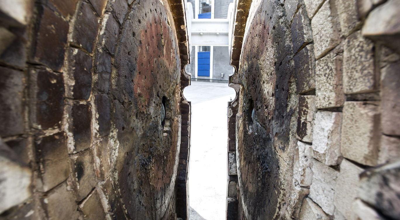

I'm still working on my stuff. I figured after the Fall semester ended that I'd have more time to work on this project, but that has not been the case, unfortunately. I start classes again on the 12th, so if I'm able to finish, it will probably be before then. If not, well, I plan to keep plodding on as time permits.
Economy in industry and on the lab scale are two different things. The Birkeland-Eyde route is too expensive on a commercial scale. In the lab, though, it should take around $1-2 of electricity to make a liter of nitric acid.

It's a very interesting design, but I think it can be simpler than that. The fancy glassware isn't optimal or necessary. Since the magnets are positioned in a skewed axis, the arc is rotated slightly. This isn't an issue, except that I'm the kind of person who straightens crooked wall hangings. The power supply sounds like a high frequency unit, but I can't tell since it is cleverly concealed throughout the video.
The original design was essentially an iron container full of firebrick:
Birkeland-Eyde_lysbue.JPG - 955kB 20120531-tfk-1481ingress_fullskjerm.jpg - 208kB url.jpeg - 49kB
