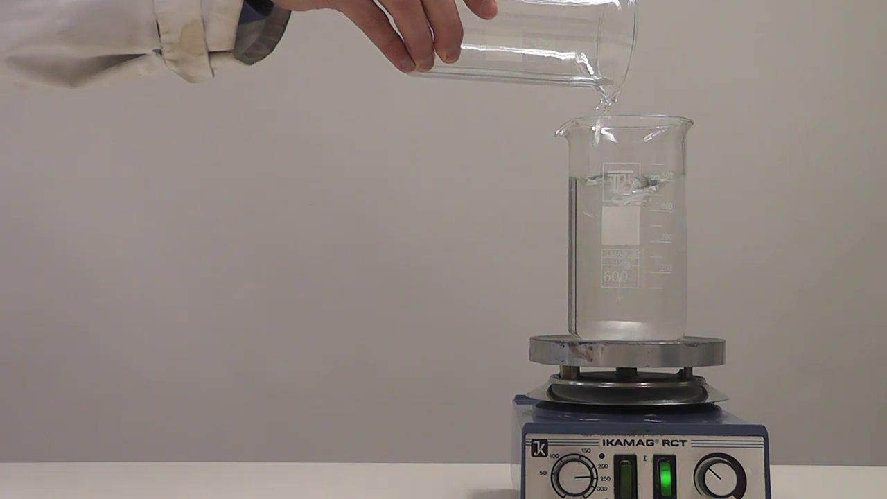

Greetings,
inspired by a post from a user on versuchschemie.de I tried this experiment. It's a chemical riddle.
A colorless liquid is poored into another colorless liquid in a beaker. On addition the liquid turns blue. Eventually on further addition the liquid turns colorless again.
vlcsnap-2015-01-17-20h12m26s14.png - 470kB vlcsnap-2015-01-17-20h12m50s38.png - 449kB vlcsnap-2015-01-17-20h12m57s106.png - 389kB
Do you know how it is done? Have fun finding it out!
Dr. K.

I would venture the guess that it is a chemical reaction in the beginning, and a thermal reaction at the end.
Just an uneducated guess.
Zom.

A way to do it would be to put starch /KI in dilute acid in the beaker and add a solution of an oxidant in dilute alkali.
Initially the oxidant converts the iodide to iodine which gives a blue colour.
Further addition neutralises the acid and then makes the solution alkaline causing the iodine to disproportionate so the colour is removed.
There are probably other possibilities.
[Edited on 18-1-15 by unionised]

I would agree with unionised that the reaction involves iodine, but I think it might be going iodide > triiodide-starch complex > iodate.

Maybe a pH indicator. It startes out colorless (either in an acidic or basic medium, depending on the indicator). You add an acid or a base and it turns blue. And when the medium becames too acidic/basic it goes colorless again. I don't know any indicator that does this, what so ever... A Redox indicator could work in the same lines too...

No iodine or starch are included. The liquids are of room temperature.

[*] posted on 18-1-2015 at 14:55
I beg to differ... I see the heat control on the hot plate is active. Thus my initial answer stands.
There is a chemical reaction that depends on a specific temp., and as the addition continues (cooler compound), that temp fell to negate the reaction.
What is this "room temp" witchery of which you speak?:D
Zom.

No, the heat control is off. Notice the left switch (heater) is not lit. The right switch (stirrer) is on.

Sugar, potassium hydroxide, and a blue indicator similar in qualities to phenolphthalein?

One more guess... Copper Sulfate / Sulfuric Acid on the stir'er. and Potassium Hydroxide is the addition.
Copper hydroxide is the blue precipitate.
Zom.

No sugar, no copper sulfate. Two hints:
1. The temperature actually is rising a little (2-5 °C).
2. You can perform the experiment in colors like yellow or pink as well.

Okay, my guess. The beaker being stirred contains a base such as sodium hydroxide. The liquid you are adding is a solution of an excess of dilute acid and some thymolphthalein. When a small amount is added, the solution is still basic and it turns a bluish color. When more solution is added, the pH turns acidic and the thymolphthalein becomes colorless. Substituting the thymolphthalein for phenolphthalein will be the same experiment, but it will be colorless-pink-colorless instead. I'm not sure what would provide a yellow color.

@gdflp: Yes, you are right. This is the perfect explanation. As for the yellow color, one could use nitrophenole. Mixing thymolphthaleine and nitrophenole would give a green variant of this experiment.

What is funny about this is the fact that everyone came up with those much more difficult possibilities than acid-base reaction with the indicator -,- :D We were not expecting it! :D

There is one thing that does not seem to fit with this explanation (pH indicator+dilute acid)
If you observe the video, you can see that the first additions are poured into the vortex and give rise to a faint blue color in the vortex which dissapears upon mixing. Only when a critical amount of liquid has been added does the color stay (as is commonly observed in titrations).
If it was an indicator+acid added to an alkaline solution, you would expect to see initially a relatively strong color in the vortex which is diluted but persists upon mixing, and not a critical treshold.

If you observe the video, you can see that the first additions are poured into the vortex and give rise to a faint blue color in the vortex which disappears upon mixing. Only when a critical amount of liquid has been added does the color stay (as is commonly observed in titrations).
If it was an indicator+acid added to an alkaline solution, you would expect to see initially a relatively strong color in the vortex which is diluted but persists upon mixing, and not a critical threshold.
If you watch carefully, it never really loses the blue color entirely, I think it appears this way because the thymolphthalein is so dilute in the acid, it is not noticeable when only a small amount of the solution is poured in. As more of the acid is poured in, the concentration of thymolphthalein starts rising to a point where it becomes noticeable. The appearance of a critical point may just be due to the solution being poured in quickly and not being thoroughly mixed quick enough.
