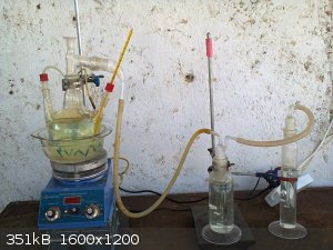

[*] posted on 14-4-2015 at 19:16
Thanks,
@woelen ,you are right.
Yesterday i used aquarium pump for bubbling air in my reaction flask and gas absorbed in two trap contain dilute nitric acid.
(I did this reaction outside of lab)
I have to say this worked but some NO2 escaped
I think strong Sodium Hydroxide / Sodium Sulfite solution work better(i have to try)

[*] posted on 14-4-2015 at 19:25
A fritted disk will increase your surface area of your bubbles and help with the absorption but will also increase the back pressure of the system or even having stirring in one of the traps.
