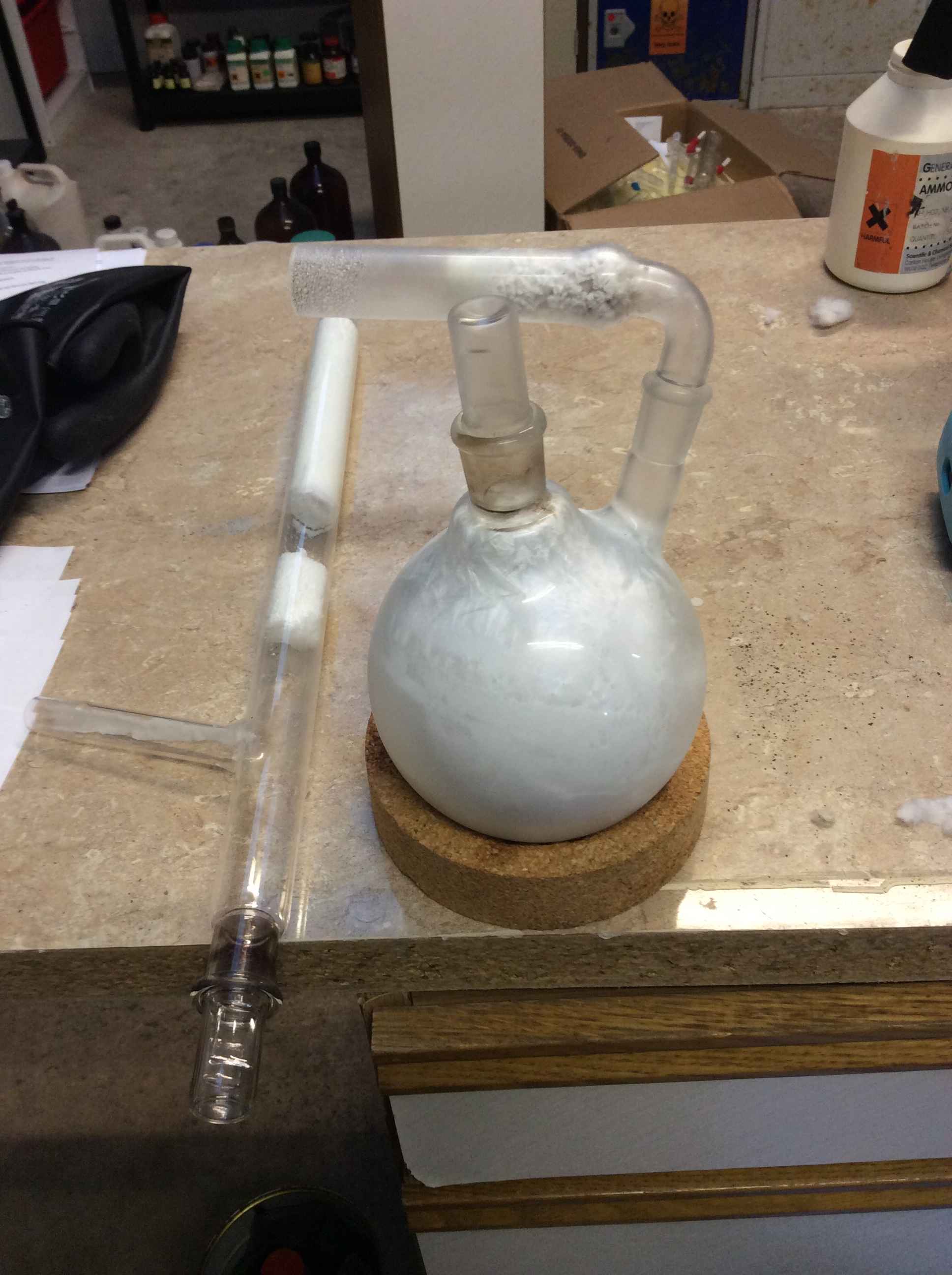

[*] posted on 16-6-2015 at 02:30
I would!
Here is some solid SO3
And the apparatus that generated it from sodium hydrogen sulphate. note white fumes issuing from drying tube
Just needs sensible precautions as always!
IMG_1146.JPG - 192kBIMG_1796.JPG - 392kB

[*] posted on 16-6-2015 at 10:57
I've made it a couple times, decomposition of a metal sulfate was my method. Using an all glass apparatus and leading the sulfur trioxide into 98% sulfuric acid worked fine, not easy, not practical.

[*] posted on 16-6-2015 at 12:00
I used a quartz tube the second time, and the metal being copper (II) sulfate, the required temperature is only around 550°C, although I used closer to 600°C. I was impatient and didn't wait for the reaction to complete, got only 12% yield (by decomposed sulfate), which took about 30 minutes from the time heat was added to when I turned off the Bunsen. The small quantity of 98% acid and turned to just over 110%, acc. to my acid titration. Which I had calculated to be about 93-95% SO3 absorption (including potential sulfur (VI) reduction by the high temperatures).
The first time I hardly did any analysis of yields and thus have no data.
