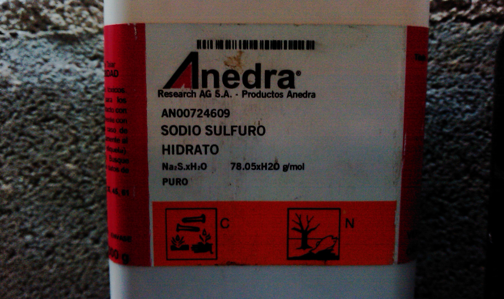

I did the stoichiometry and used these amounts of reagents.
Nitrobenzene = 10 ml
Sodium Sulfide (Nonahydrate) = 16g
Ethanol (96%) = 50 ml
Water = 50ml
The reaction was done in reflux or something like 1 + 1/2 hours in a 150 ml erlenmeyer flask.
after that i transfer all in a 500ml flat bottom flask and set for simple distillation. First 70 ml of a clear yellow liquid was collected in the 250 erlenmeyer flask as you see in the images.
When a turbid distilled started to come over and i switch the collector to a beaker. And got everything up to 200 ml
I've noticed that the first portion had a Nitrobenzene odor.
But the liquid portion had a aniline smell. so i got exited and post this. The yield is not amazing but ir works i will try to do some more reactions, if you have ideas that you want me to try i will look at theme.
The Reagents i've used where very pure.
Nitrobenzene (99.9%)
Sodium Sulfide (60%)
Ethanol (96%) (I had a Ethanol densimeter and got the same result )
Distilled water.
After distillation was started, i tested the PH of the solution and related basic in phenolphthalein, I also test for the formation of Sulfur with acid and got Positive Result. So the reaction has to be working :D
Ok thanks for your attention, hope these is useful for somebody
NOTE (THE REAGENTS NAMES IN SPANISH BECAUSE I LIVE IN ARGENTINA...GREETING TO ALL :D :D )
