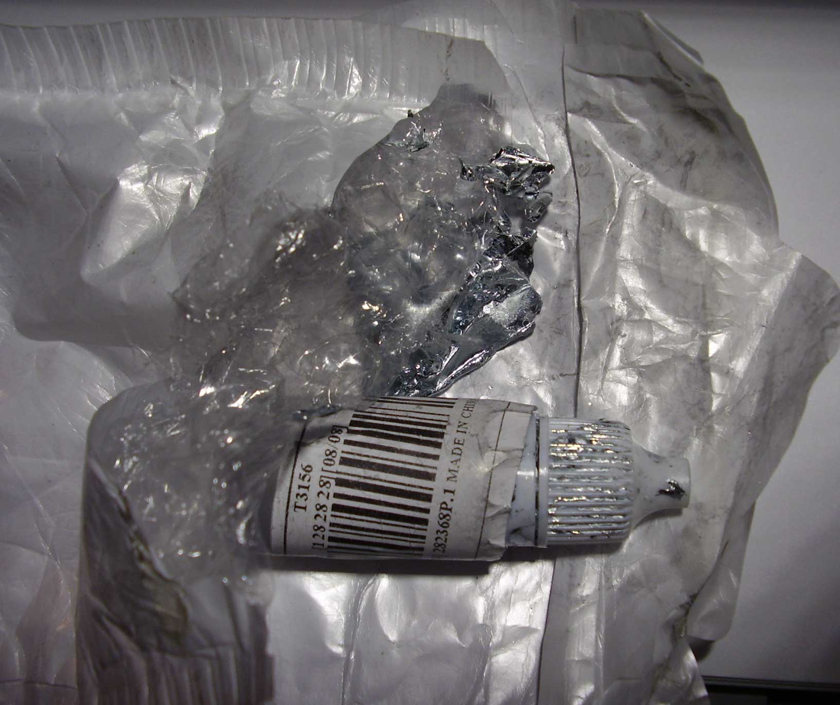

I recently ordered some gallium from china. 28g for £8 including delivery a nice price probably a to good to be true price.
It is supposed to be on its way but the listing has been removed so I was concerned in case its restricted. I could find no restrictions on its sale or possession in the uk but its not supposed to be transported by Royal Mail and probably not by air.
I guess I will have to wait (a long time if its by sea) and see if it arrives ok and hopefully I can not get in trouble. It should be the sellers responsibility to ship correctly.
Ok not really "When chemistry goes wrong" but sort of related
I am pleased it arrived today via Royal Mail. Not packed very well. It had apparently melted and leaked from its container. The whole package weighed 36g so the weight of the gallium is about correct.
