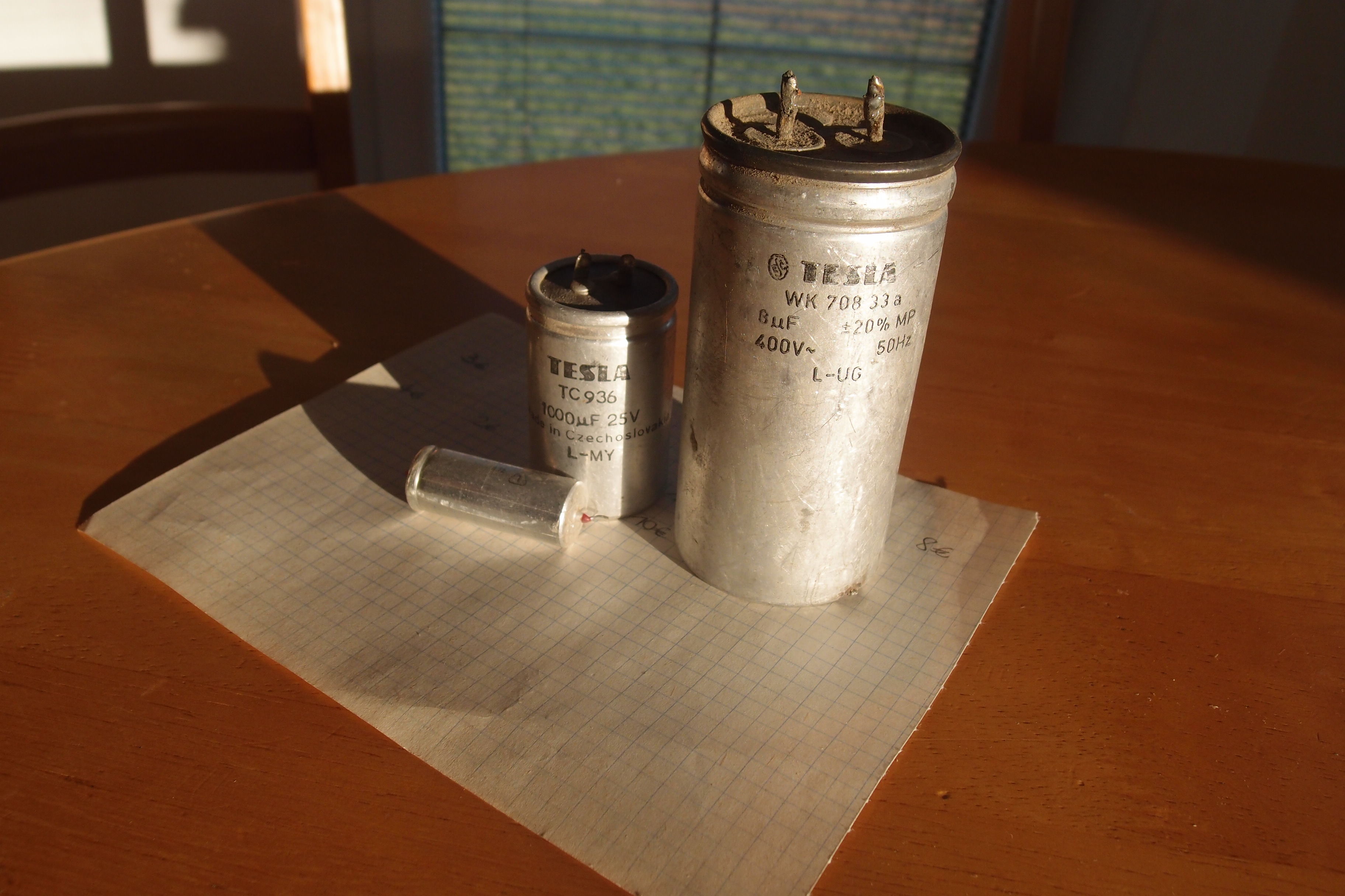

Hello, I found these old capatitors today, they are roughy 30years old and made in czechoslovakia.
Is it possible to tell if there´s any palladium or some other precious metal in it?
P2262602.JPG - 1.7MB P2262603.JPG - 1.6MB P2262604.JPG - 1.5MB P2262605.JPG - 1.4MB

The 1000 uF capacitor looks like an electrolytic capacitor. These contain thin Al-foil, with isolating paper-like stuff between the layers of Al-foil. No palladium or other interesting materials.
The 8 uF capacitor is more interesting (albeit not from a chemical point of view). It is a high voltage AC-capacitor. If you are in for electronics, then you can use it for nice experiments. Do not expect any interesting materials in the capacitor if you take it apart.
