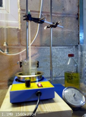

My first test;
Ka Li Te KLT-310 100mm dia. 300W Solder Pot.
http://www.ebay.co.uk/itm/171177567059?_trksid=p2057872.m274...
Setup;
(does not really need a photograph, just wanted to show off my new retort stands and clamps :D
Power.jpg - 1.1MB
KLT-310 as an oil (olive) bath, power set to HI = maximum
250 ml Pyrex beaker
-10 to +110 C thermometer, 1 C graduations, not calibrated.
Ambient temperature 18 C, pressure 29.61" Hg
100 ml of distilled water put in beaker
Time / Water Temp. / comment
8:53 / 16.0 / Power ON
8:57 / 33.5 /
8:58 / 48.0 /
8:59 / 64.0 /
9:00 / 79.5 /
9:02 / 100.0 / boiling
9:12 / 100.0 / Power OFF, 44ml water remaining.
So,
time to heat 100 ml of water with a starting temperature of 16 C to 100 C = 9 minutes = 540 seconds
time to boil off 56 ml of water = 10 min. = 600 seconds.
some math ....
Method 1 ... rate of rise of temperature:
(100 - 16) x 4187 x 0.1 = 35,171 J
35,171 / 540 = 65.13 Watts effective heating power
Method 2 ... rate of evaporation of water:
(100 - 44) x 2,270 = 127,120 J
127,120 / 600 = 212 Watts effective evaporating power
Both measurements are useful but I thing the thermal inertia of the heater/oil/beaker appear to have a significant effect in method 1.
Observations;
tiny splashes of water could occasionally be heard sizzling in the oil or on the lip of the heater,
unexpected water loss results in an over estimate of power,
but I estimate that it was very small quantity.
The thermometer went up to 103 C !
could be thermometer error, insufficient immersion or superheating due to no boiling chips or stirring.
not enough boss clamps to hold a second thermometer so oil temp not measured, the oil did not smoke.
[Edited on 27-10-2015 by Sulaiman]
