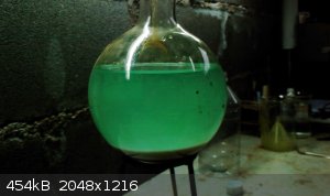

When the reflux was stopped i got a 2l RBF with 1250 ml of cold water and added the reaction to it, Immediately cuprous chloride was precipitated and got very quickly to the bottom of the RBF. The solution was a light green blue color.

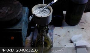

The top solution was decanted out, and the cuprous chloride was vacuum filtered. The cuprous chloride was wash twice with distilled water and then with EtOH. And when was more or less dried it was transferred to a pre-weight container and yield was calculated to be 78.6% from starting copper, since from the original 60 gr, 13.5 gr were recovered so 46.5 gr of copper were consumed in the reaction.
57 gr of white cuprous chloride was collected and store in a plastic bottle for storage.
