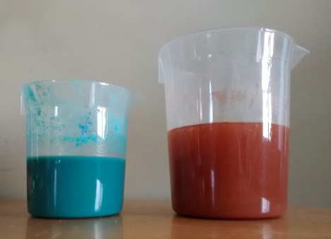

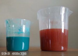

I found blogfast25's blog (I think), with a page on copper thermite, where he claims to have produced a bead of copper metal from a Cu2O thermite. Unfortunately, I can't see the photos. I'm currently attempting to produce copper(I) oxide from my copper(II) sulfate via a Benedict's reagent type reaction with sodium carbonate and high-fructose corn syrup, in order to attempt the reaction detailed there.
benedicts reagent.jpg - 93kB
Though I haven''t given up on a sulfate-based copper thermite; I'll be making another attempt at this by the end of the week.
What is the best way to dry copper(I) oxide? Will it oxidize further if it's heated to dryness in air?
