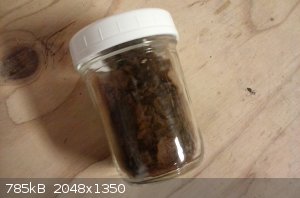

Preparation of Anhydrous Aluminum Chloride from Cupric Chloride and Aluminum
I've been trying to find information on preparing aluminum chloride from copper (II) chloride and aluminum. A couple of reputable sources have stated that it is possible, but I haven't found many details.
Preparing anhydrous copper (II) chloride is easy enough... it can be made from hydrogen peroxide, hydrochloric acid, and copper metal - or it can be made from calcium chloride and copper sulfate. Either preparation is easy. I couldn't find any 30% hydrogen peroxide locally, so I used the calcium chloride / copper sulfate method:
100.00 grams (0.77519 mol) of calcium chloride monohydrate were added to 200 mL of water and stirred until it dissolved. The solution was allowed to cool to room temperature, and the specific gravity was measured to ensure that the salt had not been contaminated with additional water. 193.55 g of copper sulfate pentahydrate was dissolved in 700 mL of water, producing a dark blue solution. The calcium chloride solution was added 10 mL at a time with stirring. Addition produced a green color that quickly dissipated, along with considerable precipitate. The mixture was allowed to stand overnight and then vacuum filtered. The clay-like filter cake was washed with 100 mL of water and discarded. The cyan filtrate was found to be unreactive to additional calcium chloride solution.
The volume of the filtrate was reduced over heat to 400 mL. A small amount of white precipitate formed. The mixture was vacuum filtered, and the presumed gypsum filter cake was discarded. Reducing the volume to 300 mL did not produce a significant amount of additional precipitate. The solution was evaporated to dryness in an oven with occasional stirring to produce 85.46 g of an amorphous brown solid, a yield of 82.00%, which was considered rather low due to mechanical losses.
So anyway, now I'm looking at around 85 grams of anhydrous copper chloride, and I have a roll of aluminum foil. Anyone have any ideas as to how to best prepare aluminum chloride from these materials, or should I just start torching assorted stoichiometric compositions in various apparatus and see what works?

This is something I was thinking about trying at some point, as well. My idea is to stir anhydrous CuCl2 and aluminium powder in chloroform, after which, theoretically, copper metal or cuprous chloride would settle out and aluminium chloride would be in solution in the chloroform. I have no idea if it would work, though.
[*] posted on 16-12-2015 at 08:22
Well done on the anh. CuCl2.
The reaction between Al powder and anh. CuCl2 has actually been reported on this forum somewhere (but I can't find it).
I can't vouch for the veracity of the results but as I recall the reaction proceeds but is far too exothermic to be of great use for preparing anh. AlCl3.
Only one way to find out: try! You will need Al powder though, no matter how course. Foil won't work, I think.
What has been tried and tested (by me) is the preparation of anh. AlCl3 by reaction of Al powder and anh. ZnCl2:
http://oxfordchemserve.com/lab-preparation-of-alcl3-reductio...
This runs nicely contained and at leisurely pace.
It too has been reported here, with one member replicating my results but again I can't find the thread (the search facility is truly crap).
[*] posted on 16-12-2015 at 08:23
It looks like it would take extremely large volumes of chloroform for that to work... I only have about 120 mL, so I don't think I will be able to do that... but it might be possible to use anhydrous ethanol.
[*] posted on 16-12-2015 at 08:24
Worth a shot but I think the reaction is too exothermic, while requiring some temperature to get going.

The Standard Heat of Formation of CuCl2 is - 206 kJ/mol (NIST), of ZnCl2 it's - 415 kJ/mol (Wolfram Alpha).
That difference of 200 kJ/mol clearly indicates that the reaction with CuCl2 runs MUCH hotter than with ZnCl2.

It looks like perhaps the easiest way to react CuCl2 with aluminum while capturing the product in an anhydrous state is to dissolve the copper (II) chloride in dry ethanol and then drip it onto the aluminum. I think aluminum chloride should go into solution with the copper precipitating out. Once the reaction is complete, the reaction mixture could be filtered and the aluminum chloride precipitated out of the ethanol with chloroform. Right?

We all know what the product is, and that it's purity is acceptable for the intended use, but my experience requires me to ask the following pedantic questions:
How do you know the CuCl2 is anhydrous? What tests did you perform to prove this? Did you test for decomposition after heating? You didn't even state the temperature or the length of time spent in the "oven".
You mention sourcing reagents locally. I interpret that to mean your reagents are OTC. Everybody knows that all OTC products are highly contaminated, enough to throw off the results of most experiments (I didn't think so, but I was wrong). You must repeat the experiment with reagent grade chemicals, and/or verify the product spectroscopically, to ensure contaminants didn't give a misleading result.
What was the purity of the product? How did you determine this?
How do you know your product is anhydrous copper(II) chloride? Don't tell me you judged this based mostly on color, that would be "beneath contempt."
Edit: Also, those one-piece plastic mason jar lids are far from air-tight (I also use them for chemical storage). You'd be better off using a regular gasketed lid, otherwise your "anhydrous" product soon won't be (unless you store the jar in a desiccator).
