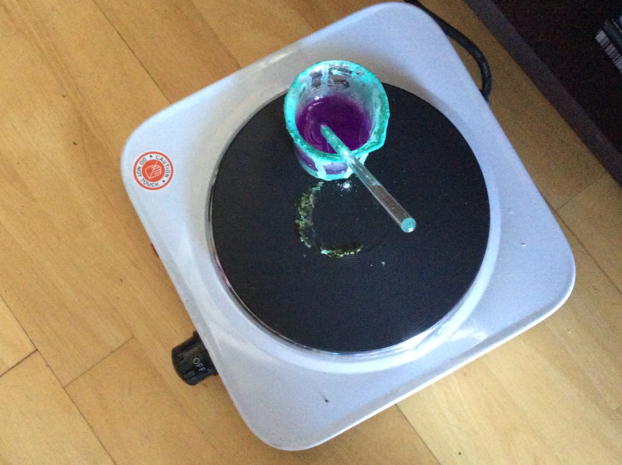

Purple floating liquid on CuCO3?
Hello all,
After synthesis and filtration of CuCO3 I heated it on a hot plate. The solid melted ??? and formed a strange purple floating layer on the top ???
Does anyone know the cause of that?
Thanks

[*] posted on 29-12-2015 at 19:23
You need to describe your synthesis first. W/o it no one can make any significant pronouncements re. what is causing the purple colour.

[*] posted on 29-12-2015 at 19:25
It's the standard NaHCO3 and CuSO4 precipitation.

You need to specify quantities.
I think poorly washed basic copper carbonate (CuCO3 DOESN'T exist, only basic copper carbonate does) gave cuprate which is blue. Blue + green gives purple.

[*] posted on 29-12-2015 at 19:52
Ok thanks,
As I had a good amount of very concentrated (near saturated) copper sulfate solution I just added baking soda until effervescence ceased. It was filtered using coffee filters and washed twice with distilled water. Then it was scooped and placed into the 100mL beaker.
Also I don't think blue and green will give purple, instead it gives turquoise.

[*] posted on 30-12-2015 at 15:14
There are several normal double carbonates of copper and other elements; check out Juangodoyite it ranges from deep blue violet to a lilac colour. It is Na2Cu(CO3)2 but sparingly soluble but other ratios of Na to Cu may be more soluble, looks reasonable.
Juangodoyite.jpg - 26kB
[*] posted on 30-12-2015 at 15:55
Nice find and I'd never heard of that mineral before. But I find it hard to see how it could form in OP's conditions, though...

[*] posted on 1-1-2016 at 15:16
Are there any methods of making these double carbonates?

[*] posted on 2-1-2016 at 00:34
Maybe heating mixture of Cu2(OH)2CO3+ Na2CO3+ NaHCO3 up to boiling point of water but under calcination of NaHCO3 it is just a guess but not so hard to try so good luck.
