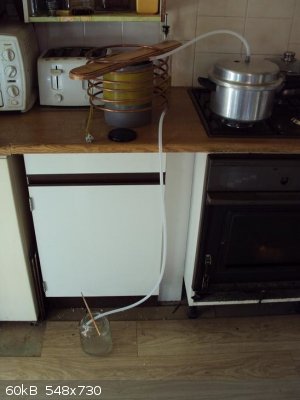

What shall I do with an old pressure cooker ?
Our pressure cooker was beginning to leak steam around the overpressure vent,
all seals can still be replaced, even though we have had it for >35 years.
(never changed seal ... old style Prestige brand)
Mainly due to it's age, I decided to replace the old aluminium cooker with a new stainless steel one.
Now available for chemistry ... a working aluminium pressure cooker.
I have used it as a steam generator to get some dH2O but I prefer glass,
I could use it as a vacuum chamber, or a very useful vacuum dessicator
any other ideas ?
Distillation.JPG - 60kB
This is the pressure cooker ... the condenser cooling was inadequate.
[Edited on 7-2-2016 by Sulaiman]
You could try a PVC sleeve (sink waste pipe?) on the tubing, sealed with 2-hole stoppers for tubing and cooling water?

sorry to bump but I am going to use the pressure cooker today to get some more dH2O,
(despite my preference for glass, I feel more comfortable leaving the aluminium pot unattended than my only large glass flask)
very cold out so just two 1.2 m borosilicate tubes as a condenser,
I will use a red rubber bung in the larger 'pot' hole with 8mm glass tube through it, bent to fit the condenser tube, no fractionation.
So;
Is there any SIMPLE surface treatment of the aluminium that may improve the quality of the dH2O ?
(e.g. treatment with a strong acid/base/oxidiser/reducer possible, ptfe lining not practical)
My feed water is 'medium hard' meaning I always get some (presumed) calcium carbonate crud.
Or am I concerned over nothing ... in what form could aluminium come over in the water vapour anyway ?
One day I would like to set up a small continuous water still, along with arc/corona N2/NO/NO2/HNO3 and S/SO2/SO3/H2SO4 generators
(a little over-ambitious maybe, I tend to suffer from polyprojectitis)
but for now I just need more dH2O that will be pure enough for most uses, diluting and washing mainly.
