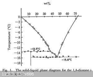

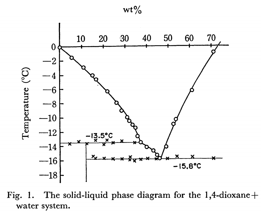

You put all 1100 ml of distillate into freezer - what was the result?
A yellow semi-solid mass. It stopped most of the reactions and allowed me to store the crude product safely stoppered until i could work on it again. I should note that the flask still build up pressure
Wasn't it contaminated with acetaldehyde?
yep.
I purified it a few days later. Fractional distillation in acidified conditions, koh soaking, decant. Then used it to clean crude sodium metal which also served to further purify the dioxane.
Waste disposal i dont remember how much i got below 80c during the second distilation, something l8ke 150~200ml i think. I suck at keeping track of yields.
Putting into freezer (-18 C) would freeze not only dioxane but also the water remained after drying the product. So I used only fridge +4 C and not freezer -18 C.
Very true, I figured that my rbf was almost half way full, so if the water did freeze solid it wouldnt break my flask, and my freezer is set to -5c but from the readings i didnt expect it to freeze solid

https://www.journal.csj.jp/doi/abs/10.1246/bcsj.46.2965
Attachment: bcsj.46.2965.pdf (692kB)
This file has been downloaded 302 times
Screenshot_20221115_032302.jpg - 133kB
1,4 dioxane + water melting points
Posts: 1035
[*] posted on 15-11-2022 at 09:30
Rainwater - well done. Luckily dioxane on solidification does NOT expand in volume unlike water. It is possible to remove most of the water still present after KOH drying and then distillation - by solidifying the almost dry dioxane in a fridge at +4 C for (few months better than only few days) and pouring out small amount of liquid on top of solid mass of dioxane. Then you need only tiny amount of hard to get sodium metal to dry it completely.
