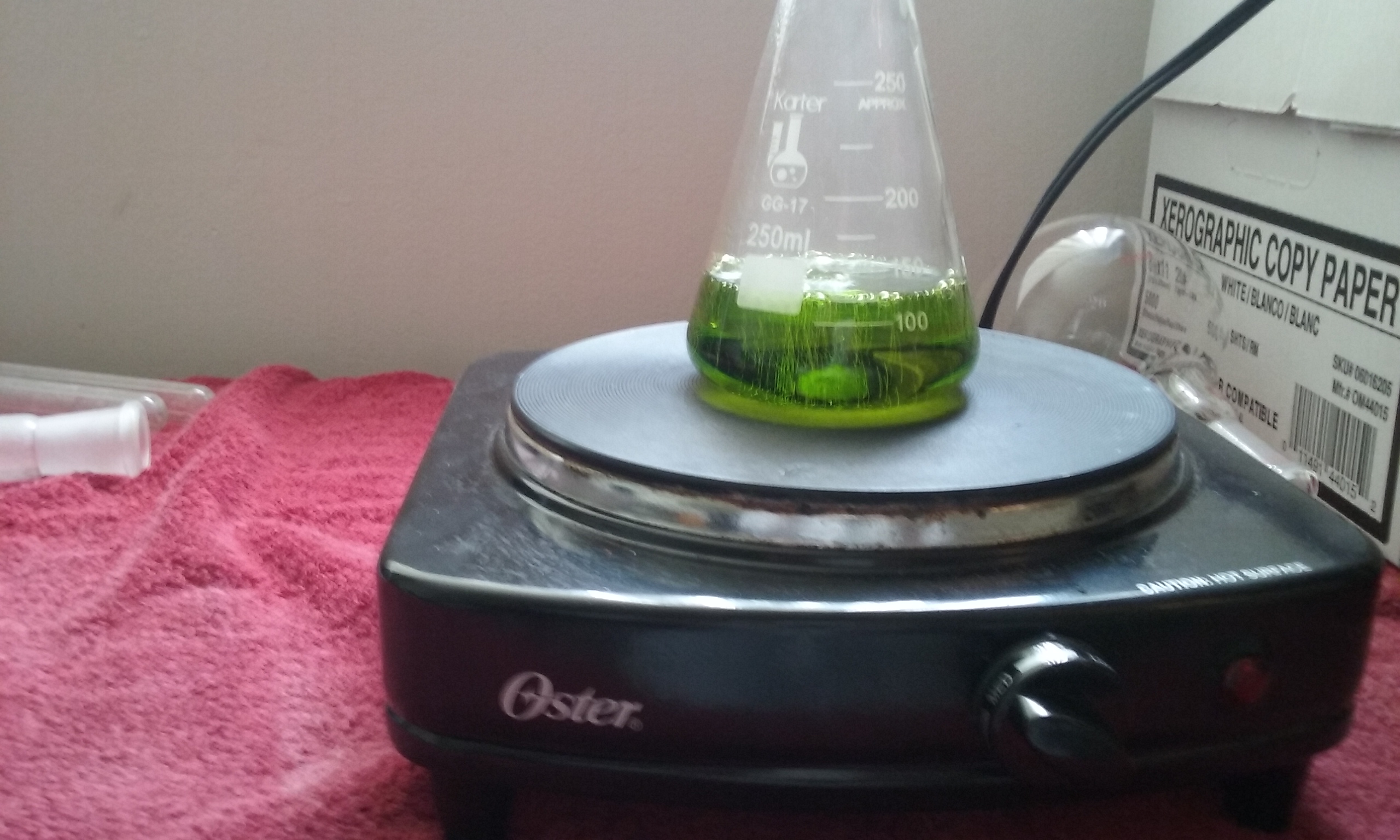

So I'm currently testing out the H2O2/HCl mixture theory since I don't have nitric, and it's become a rather bright green color (the peroxide is 3% unfortunately). You guys think the green is from the copper reacting or is that more likely something like chlorine?
20160607_142903.jpg - 966kB
Posts: 4087
[*] posted on 7-6-2016 at 11:05
The green is chloro complexes of copper. It's working.
