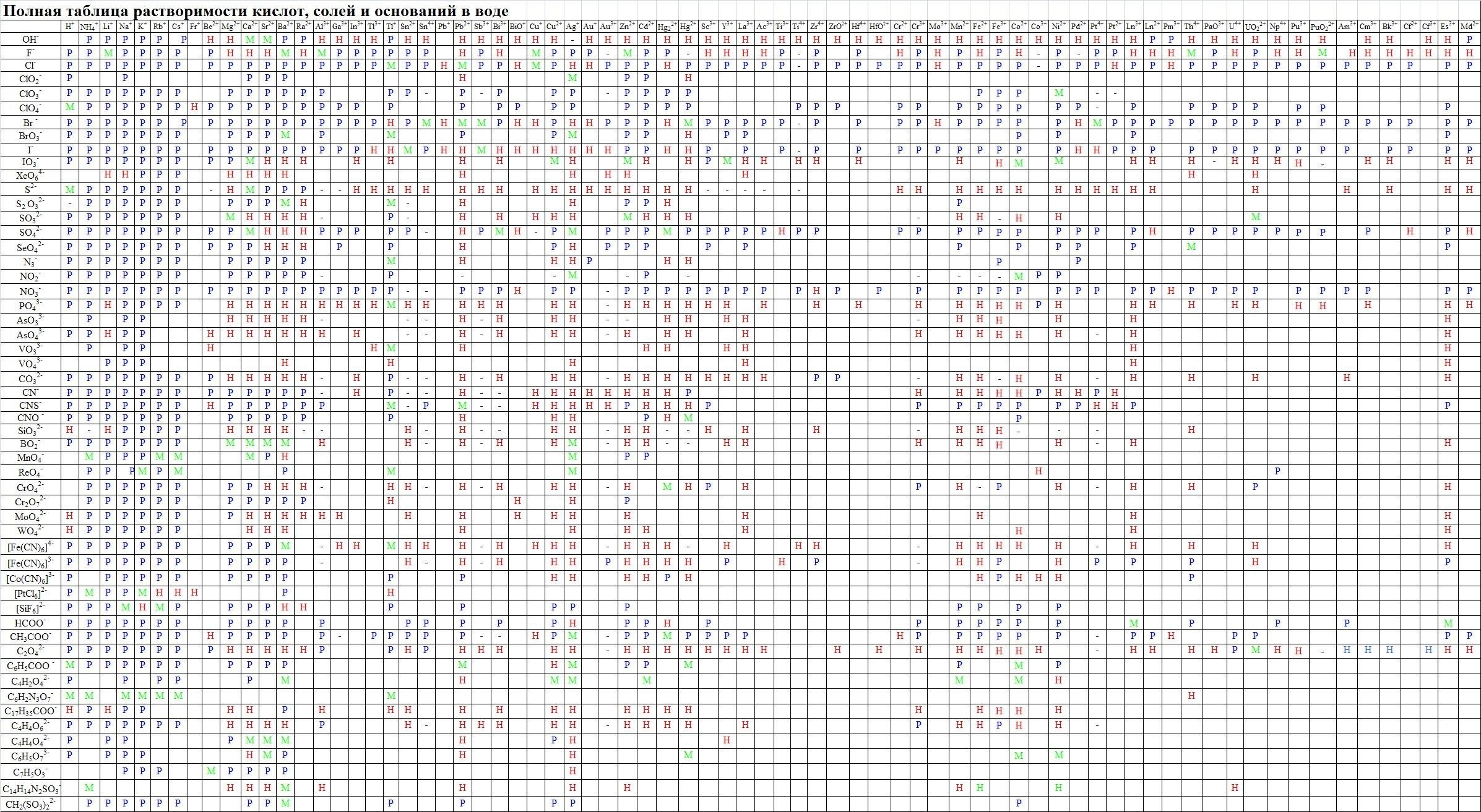

As for the perchloric, it is one of the principal chemicals for which I require the PbO2 anode in the first place.Although according to my Solubility Megatable(attached), I can also use chloric, bromic, hexafluorosilicic, formic and acetic acids. Plenty of options.
TabR2.jpg - 791kB

Nice table...
What does the P, H, M, - stands for?
I guess...
P --> soluble
H --> unsoluble/precipitate
M --> moderately soluble
"-" --> unstable
HClO4 is M while it should be P...
PH Z (PHILOU Zrealone)
Zandins
Posts: 25
Registered: 18-6-2016
[*] posted on 20-6-2016 at 08:25
Yes, although I do not know the specific limits separating soluble/moderate/insoluble.
The HClO4 puzzles me too, probably a misprint...
As for the original topic, I think I will melt the meshes down into a solid plate and try the sulfuric acid approach. Some sources state the coating becomes porous and unreliable, but I guess there is only one way to find out.
P.s. Everyone is more than welcome to use the Supertable for their own purposes, if need be.

Nice table...
I guess...
P --> soluble
"-" --> unstable
It's Russian, soluble = растворимый
insoluble = нерастворимый (the prefix "ne-" is the same as "non-" or "in-").
