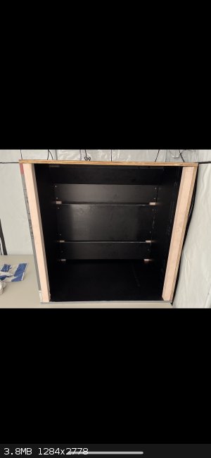

Help me finish my fume hood
I’ve almost finished my fume hood. The only thing i’m stuck on is building a sash that’s tight and able to slide up and down.
It is 930mm wide and 933 high.
It looks and seem simple but yea this has me stuck on what to do from here.
Any advice?
Rainwater
Posts: 703
Registered: 22-12-2021
It sounds like you're wanting a "linear rail". Thingy bob that slidez up and amd down you can mount the glass to
https://www.amazon.com/OrangeA-Linear-SBR20-1000mm-4SBR20UU-...
Mateo_swe
Posts: 493
Registered: 24-8-2019
Location: Within EU
That linear rail looks nice.
There are another type also but they are a bit more expensive i think.
This type (i just picked the first i found, search for better price and other models):
MGN12 Precise Linear Guide Rail & 2 Sliding Rail Block Set
Also, i would use a plastic plexiglass screen instead of glass.

Bubbles
Posts: 29
Registered: 13-7-2020
With my design I'm also stuck at the sash.
Those linear rails look nice, how would I stop it in place though? So stop the plexiglass lower window from falling down when in the up position.
I've also looked at vertical sliding windows but didn't find anything suitable in the Netherlands.
charley1957
Posts: 117
Registered: 18-2-2012
Location: Texas
Mood: Sublime
When I built my fume hood I used an old glass storm door with a moveable sash. I built the fume hood to the width of the storm door and bolted the
door to the front of the box. The sash of the storm door is now the sash of the fume hood. I raises and lowers and has stops at different heights.
It was a pretty painless build.
