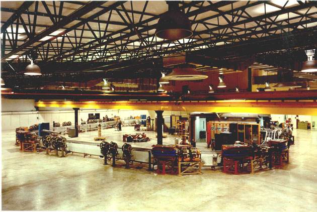

Obviously, the next thing to do once you have a reliable beam output is set up a particle storage ring fed from this linac, then develop uses for the synchrotron radiation emmited at the bending magnets- such as vaccuum UV microcircuit etching, nano-scale device optical fabrication stations (and for your honors class project, your very own free electron LASER).;)
Ion pumps with Ti getters in addition to your other vacuum pumps... And cement with Iron ore as aggregate for cheaper bulk radiation shielding, just sayin'.
My skinny 20 ish year old self helped build this machine... But I certainly was not on the design team.
[Edited on 12-7-2016 by Bert]

That is a picture of the University of Wisconsin's Alladin synchrotron storage ring, which was built in a 12-20 ft. deep hole (down to the bed rock, for stability and radiation shielding) near Stoughton, WI. I watched the excavation... And ended up working on various control systems for 3 years as a student employee. Only "film badge" job I have ever had-
My father had helped build an earlier machine, Tantalus, for MURA about 1/2 mile away. The nice flat stable bed rock there was an important factor in choosing both sites.

That building (and the full size basement, made up of the machine vault and a support shop) had a footprint a bit larger than 2 football fields. We used to play Frisbee in there on our lunch break, until the researchers showed up and occupied every square foot with beam line ports and experimental aparatus.
SRC_vault.png - 313kB Synchro_Radiation_Ctr1_00.jpg - 765kB
[Edited on 13-7-2016 by Bert]
Incredible... Absolutely Incredible :o
