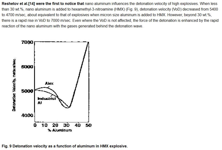

[*] posted on 31-8-2016 at 05:13
Thanks Dany, is that similar to what is happening in the graph below, very surprising effect that the VoD rapidly goes up with increasing aluminium content? What causes this effect, the relatively high speed of sound for metals? Interesting phenomena, can't directly fold my head around this. :)
Ref --> http://what-when-how.com/nanoscience-and-nanotechnology/meta...
Nano Al-HMX det velocity.jpg - 103kB
