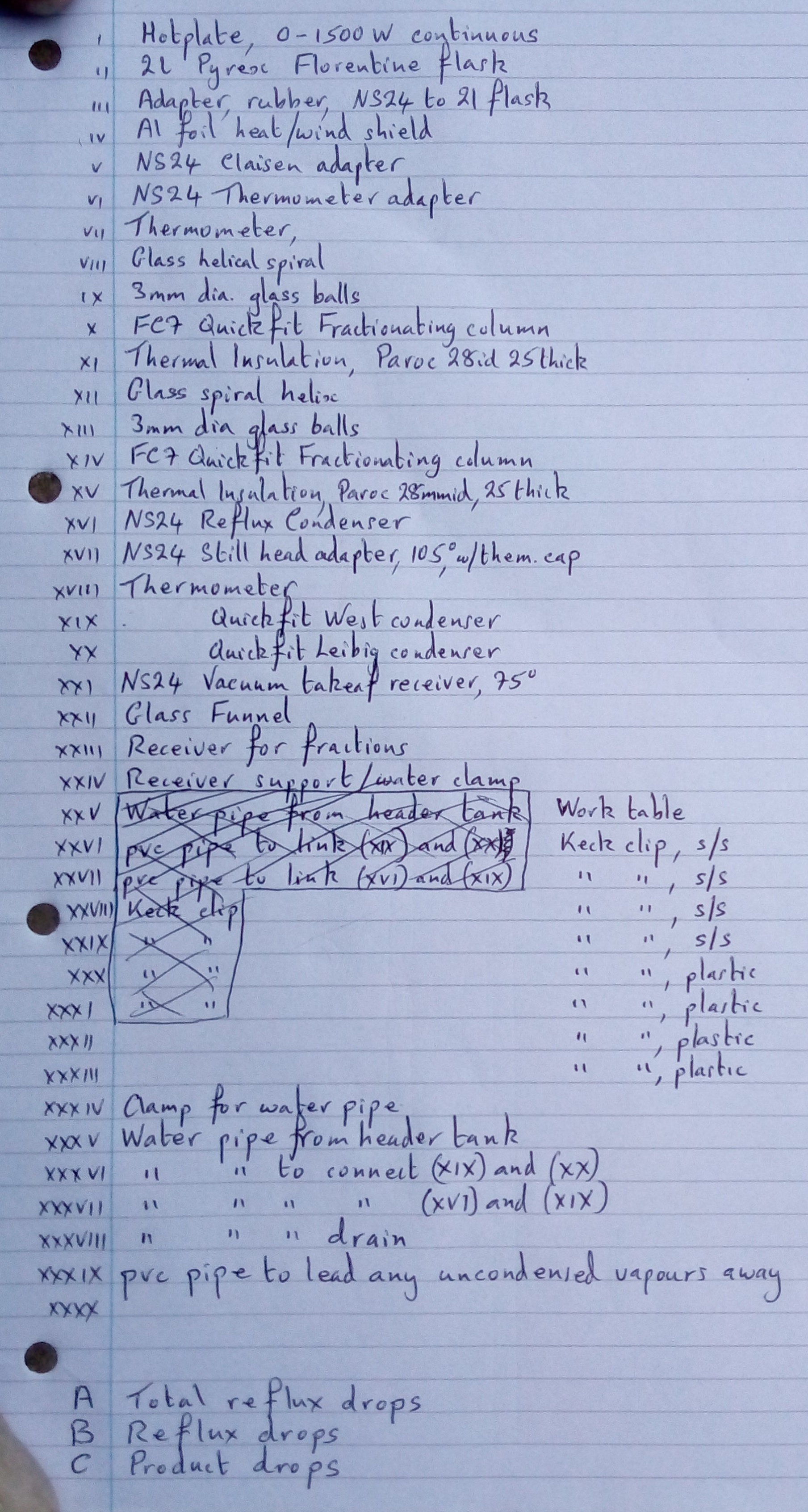

Set up for fractional distillation of c1.65 litres of 56 %ABV EtOH
Fractionating1.jpg - 1MB
Spent about two hours setting up
another two hours balancing heat vs. column flooding
my alfresco lab is so cold that even with cooling water at 1 drop per second, I can't get a drop of distillate,
total reflux on the outer wall of the reflux condenser ... to be continued ......
StillSchematic.jpg - 1.3MB StillKey.jpg - 1.4MB
[Edited on 20-2-2017 by Sulaiman]
Chemetix
Posts: 376
Registered: 23-9-2016
Location: Oztrayleeyah
[*] posted on 20-2-2017 at 13:53
What a set up! Ahh the giddy joy of a nice bit of glassware.
The reflux condenser, which you've already identified as the problem, is too big. It will need heavy insulation in cool weather. And the flow through it may I suggest, needs to be restricted.
A tee-piece on the inlet of the downward condensers, branching to feed the reflux condenser with an inline valve will be what you need. It keeps the condensate in contact with optimum cooling but allows the reflux rate to be controlled.
If you weren't wanting fractionation and wanted to just bring over the distillate as quick as possible I'd say the two liebigs in series would be optimal. But with slow reflux, only one would be needed. For ethanol that is, ether or petroleum spirit would need them both under any condition.
Posts: 3828
[*] posted on 20-2-2017 at 15:58
I agree about the two downward condensers ... overkill, but why not ?
I wrapped the reflux condenser in foil after the above post and got a couple of drops in the product condenser.
The main problem has been column flooding,
not achieving reflux rates that I'd expected,
as I was pondering how there could be more refluxing at the top of the column than at the bottom,

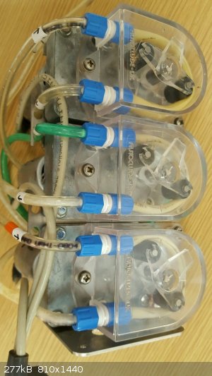

just an update on my distillation rig
To allow semi-unattended operation I bought six used peristaltic pumps via two eBay auctions from the same seller,
PeristalticPums1b.jpg - 335kB PeristalticPums2b.jpg - 277kB
All six came from a cow-milking assembly,
the motors, gearboxes, rollers and housings seem OK
I ordered 1m of 3.2mm i.d. x 1.6mm wall silicone tubing to replace the worn and swolen existing pumping-tubing
and 3x 8A (overkill) pwm controllers for the 12 Vdc motors (£6.90 total).
With 3.2mm i.d. tubing, 1 ml per revolution is pumped
and the motor and gearbox give 125 rpm at 12 V.
I should be able to use one pump for the reflux condenser, one for the product condensor and one as a vacuum pump for reduced pressure distillation.
I was pleasantly surprised by the vacuum pump potential of peristaltic pumps like this,
not a good flow rate but quite respectable pressure reduction

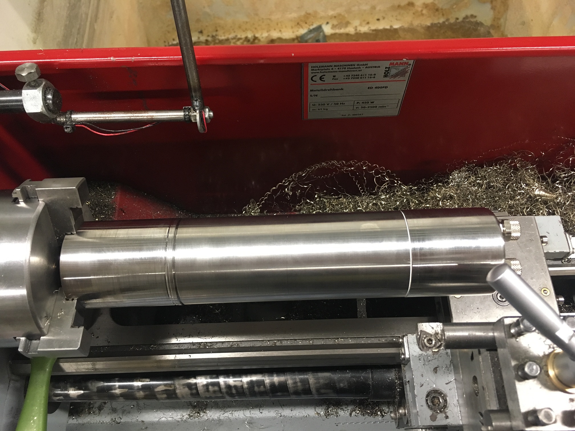

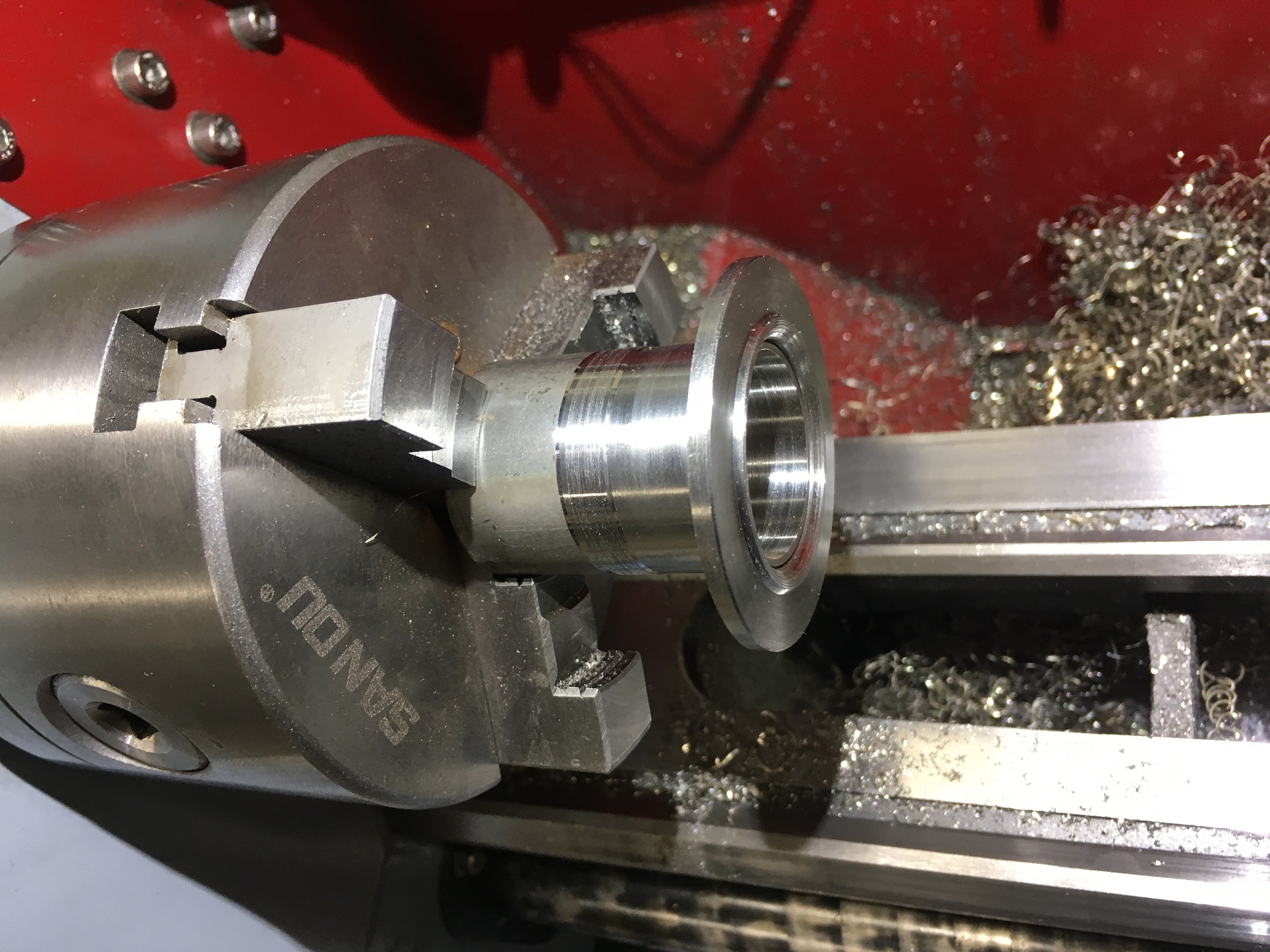

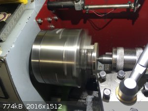

As far as fractionating alcohols or other noncorrosive organic solvents goes I must point out that using a glass set up (especially with a fractionating configuration) is most unpleasant, although visually appealing and will mostly end in shards, tears and sobbing. I highly reccommend to use a metal setup for these operations. It is sturdy and forgiving....under some circumstances also a lot more economical.
For example if one has access to a lathe and knows how to use it.
One can start out with scrap materials like thusly:
IMG_0224.JPG - 725kB IMG_0225.JPG - 807kB IMG_0226.JPG - 919kB IMG_0227.JPG - 943kB IMG_0228.JPG - 938kB IMG_0231.JPG - 774kB IMG_0233.JPG - 901kB
And create quite an appealing setup from all of this (the reflux head taking shape):
IMG_0234.JPG - 1MB IMG_0235.JPG - 883kB IMG_0239.JPG - 567kB IMG_0240.JPG - 725kB
A window section shall be incorporated a the base of the reflux head (in the last picture it has been substituted with a stainless section between the flanges):
IMG_0263.JPG - 788kB IMG_0264.JPG - 658kB IMG_0265.JPG - 608kB IMG_0266.JPG - 1020kB
The parts dissassembled and a shot of the column packing:
IMG_0270.JPG - 904kB IMG_0271.JPG - 783kB IMG_0272.JPG - 846kB IMG_0277.JPG - 860kB
It's a work in progress, but it shall be a pilot production/products develpment fractionating column once completed....
The only glass part shall be a 5cm quartz section below the reflux head. The rest is stainless 304. Sturdy and functional without the dangers of shattering on first contact :D
