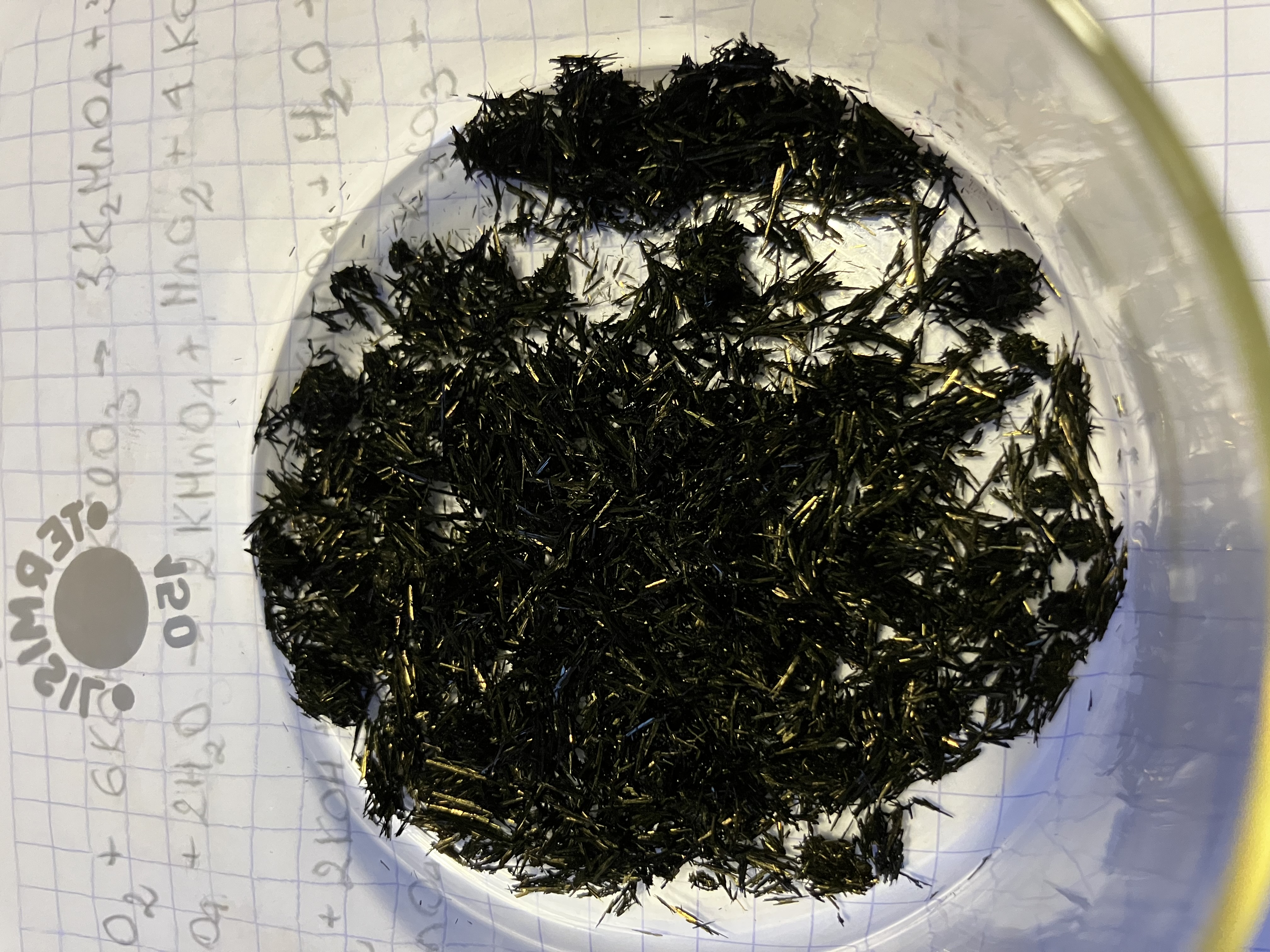

[*] posted on 29-5-2023 at 11:57
(Partial) Result of last batch.
IMG_1387.jpeg - 2.7MB
