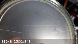

Culture plate before cultivation:
Culture media clean.jpg - 315kB
->Results:
White, wet, big colonies were detected on the cultivation zone. No bacteria growth was detected in any other side of the same plate neither on the second petri dish prepared. Recognition of the bacterial culture was not performed.
