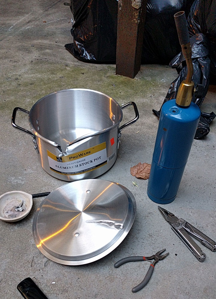

For the aluminum source, I used dollar-store aluminum cooking pots that had clearly been stamped out of sheets. 1100 aluminum alloy works particularly well for stamp-pressing, and is 99% aluminum, which accounts for its softness. Aluminum electrical wire also works, although the preferred alloy these days is usually only 98.5% pure. Casting aluminum and structural aluminum are the least pure aluminum alloys, and should be avoided. The two main impurities in aluminum are iron and silicon, which can be tested for by dissolving a small sample thoroughly in clear half-strength hydrochloric acid. Yellow color indicates iron, while an insoluble light brown precipitate indicates the presence of silicon.

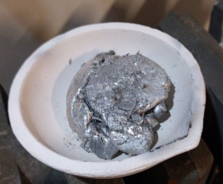

For melting the aluminum, you will need some sort of crucible. I bought mine from a jewelers' supply shop for $5, but it only needs to be able to withstand 600-800˚C, so material is not that critical. You can use an indentation in concrete or a large enough rock as a crucible if you have to, since you won't actually be pouring any molten metal. These would be better than using a steel crucible, which would contaminate the melt to an unacceptable level. You'll need something to stir with; graphite rods are ideal, but if you're doing this outside and smoke isn't a problem, you can use a stick. It will gradually burn away, but will only form charcoal and ash, neither of which will contaminate the aluminum. Really, just don't use anything metal for stirring unless you know what you're doing. You'll also need a heat source that can apply enough heat to keep all your aluminum molten at once. A propane hand torch with a one-pound tank like the one pictured can keep about 50g of aluminum molten at once. For reference, this is 50g of melted-down aluminum:
files.php.jpg - 79kB
If you don't know how much aluminum you'll be able to melt at the start, you can cut up your source into pieces and do something like this to keep track of how much metal you're melting:
files.php.jpg - 160kB

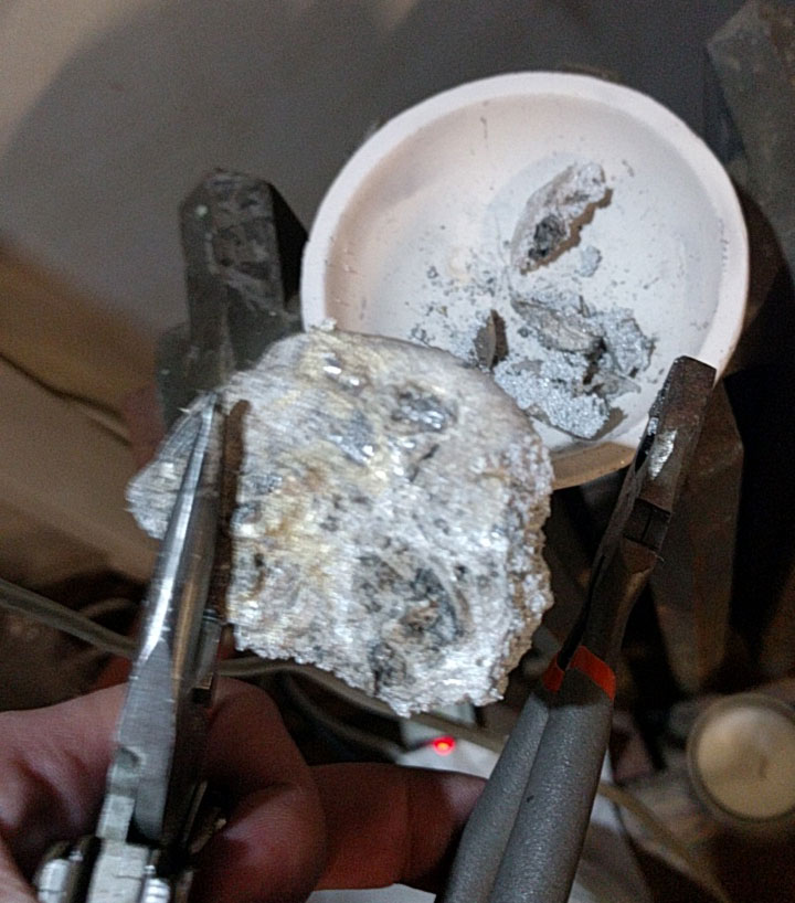

Start melting down aluminum, until you have the desired amount of molten metal, or until you reach the limit of how much metal your heat source can keep molten at once. If necessary, you can cool it down, weigh it, then melt it again. Now weigh out an amount of galinstan equal to about 5% the mass of your aluminum. Smaller amounts can work, just not as consistently. Larger percentages of galinstan will cause the aluminum to react more quickly. After much trial and error though, I've settled on 5% as the best balance between allowing a smooth, predictable reaction and keeping galinstan use low due to its relative expense compared to aluminum. You can weigh the galinstan in paper (preferably low-ash filter paper) then set it all into the molten aluminum to minimize splatter. As soon as the two mix, you'll notice the consistency change. The melting point drops, and it's easier to keep molten. You'll also notice that it forms a cement-like phase before it solidifies, unlike pure aluminum. It is critical at this stage to throughly mix the two metals. Once the metals are thoroughly mixed, the molten metal can be covered and allowed to cool to below 100˚C. At this point, the metal should have the approximate strength and physical properties of unfired clay; that is, not much strength at all, and the metal should be easy to break using two pairs of pliers to grip it:
files.php.jpg - 111kB
If the metal is too hard to break in spots, that's usually a sign that those spots didn't get enough galinstan mixed into them and will probably need to be remelted with more galinstan in order to make them useful as a reductive agent. This is a good time to break up the metal into small pieces and store it, preferably in an airtight glass jar. When added to water or alcohol, the metal will gradually break up into grains about the size of sand, so you don't need to manually break it up into very small pieces. This alloy reacts slowly with air, and can be handled with dry hands, even without gloves. The only danger in handling it, is if your hands are wet, and either you touch it or a small piece of it sticks to your skin, it can generate enough heat from the reaction with water to burn you, though not very badly.

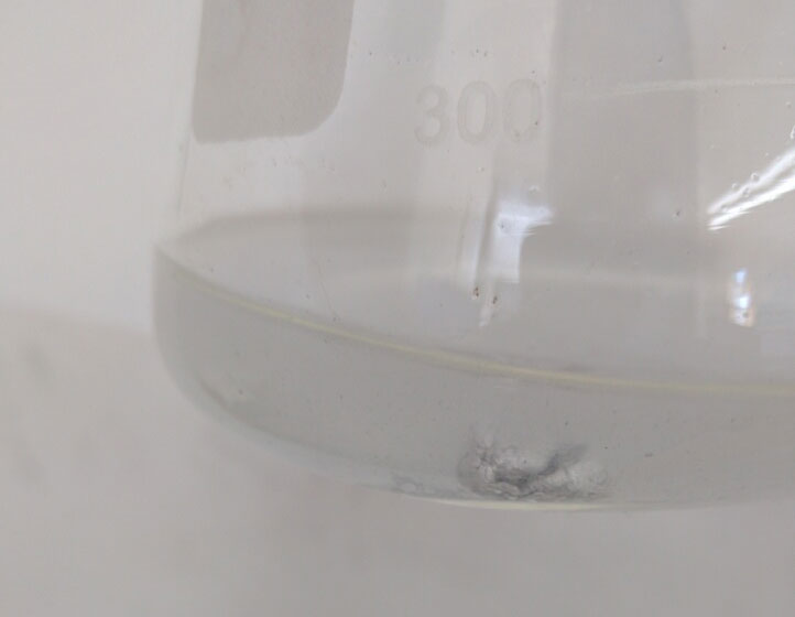

Typical reaction conditions
Substrates are initially dissolved in either water, a lower primary alcohol, or a mixture thereof, which act as hydrogen donors for the reduction. Isopropanol can work, however under anhydrous conditions, it will react with aluminum to form aluminum isopropoxide, which can reduce ketones into alcohols, and transform aldehydes into esters.
For reductions in methanol, ethanol, and water, nitroalkanes are reduced to amines in excellent yields. Nitroolefins are reduced into their corresponding alkyl amines due to a rearrangement that produces an imine. Reductive amination also proceeds smoothly. Stirring is highly recommended, since this is a heterogeneous reagent, although in my experience, the alloy usually generates enough hydrogen bubbles to adequately circulate the solution. Reaction rate can be controlled by the application of heating or cooling.
This reagent is also a convenient hydrogen source when added to water, and can be used as a more reactive form of aluminum in a number of reactions. For example, it can be added to a solution of iodine in diethyl ether to give an ether solution of aluminum triiodide. It can also be reacted with isopropyl alcohol to give aluminum isopropoxide, which can catalyze the conversion of ketones to alcohols in the presence of isopropanol, and secondary alcohols to ketones in the presence of acetone.

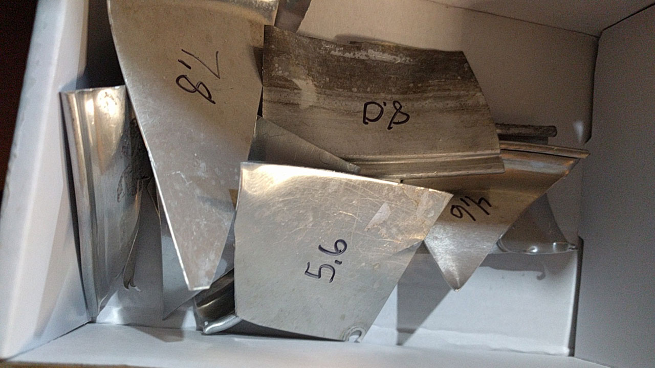

Another thing I'm discovering as I do more experiments with this reaction, is that aluminum purity seems to be very important for determining reactivity. Aluminum alloys typically only vary by 1-2% for metal content, but the reactivities of those alloys vary wildly. Also, I've found that these pans are MUCH more reactive, after being melted down, than any other aluminum source I've used:
pl3996927-takeaway_disposable_aluminum_foil_serving_trays_for_food_323mm_266mm_64mm.jpg - 63kB
Preliminary research points towards 3004 aluminum as the likeliest contender, and the added magnesium could be what's increasing the reactivity. I have yet to determine if or how magnesium changes the reducing activity of the alloy though. I'm having a hard time determining how aluminum reacts with organochlorides and organobromides, though magnesium's reactions with organohalides are extremely well-documented. The only thing that I seem to be able to find are warnings that methylene chloride and chloroform can undergo very energetic reactions in the presence of aluminum, but there's no indication of what the products of that reaction would be. Presumably it'd result in various chlorinated alkanes and alkenes? There may just be no information about the reaction products because the reaction is useless for synthetic purposes.
As far as reducing galinstan content in order to reduce reactivity of the resulting alloy, it doesn't work very well below 5% or so. I did 97% aluminum, but then the galinstan doesn't diffuse throughout the metal uniformly, and different pieces of the resulting alloy vary a lot in their reactivities. Another thing that I intend to try is an alloy composed of a eutectic mixture of just indium and gallium instead of galinstan. That ends up being 3:1 based on mass of gallium to indium. It melts at 15˚C, which is 59˚F. Stannous chloride could then be added to a reaction mixture as needed in order to fine-tune reaction rate. However, it seems to make the most sense to try running the reaction with only group 13 elements (aluminum, gallium, and indium) at some point, to characterize it in its simplest form. Since tin is in group 14, it would seem to be most likely to contribute to variation from the Al/Hg reaction.
One last observation: getting zinc or zinc salts into your reaction mixture is a mess, and I would recommend avoiding it as much as possible. Zinc barely dissolves in galinstan, but is plated onto it if aluminum metal is present. This results in thick, dark gray zinc mud everywhere, which can reduce gallium metal out of solution. Normally, gallium is reduced back onto the dissolving aluminum, and so the amount of gallium in the solution is always quite low. Zinc can interfere with this equilibrium though, pulling more and more gallium out of the reacting alloy until it's no longer able to form a liquid phase and the reaction stops. So to anyone thinking about trying to use zinc dust to reclaim galinstan: it wouldnt' work, and would probably make your job a lot harder. Instead, try this:
To the collected and washed sludge from a dissolving aluminum reaction, slowly add 20% HCl solution until it becomes clear or stops dissolving. Filter, then slowly add small pieces of aluminum (NOT dust!) to the liquid, waiting a few minutes after each piece to see how vigorously it reacts. Hydrogen bubbles should evolve, and eventually, parts of the surface should form a liquid phase. The fraction of the metal in the liquid phase should gradually increase, eventually getting you back your galinstan. This galinstan will be less pure though, due to impurities from the aluminum that dissolved during the initial reaction. If you're tempted to try reducing the metals with zinc, just don't. In practice, it dissolves at a similar rate as gallium, and the component metals of galinstan do not combine in a liquid phase like they do when using aluminum. Gallium seems to alloy with the zinc, forming a higher-melting-point alloy than pure gallium, and then the other metals can't combine with gallium to form a liquid-phase alloy. It just results in a mess, without much to show for your efforts.
