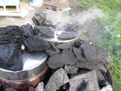

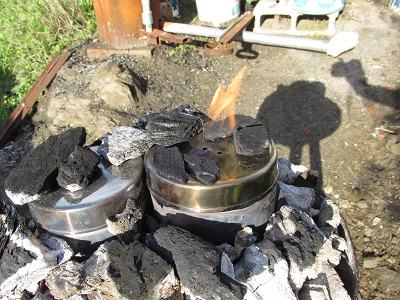

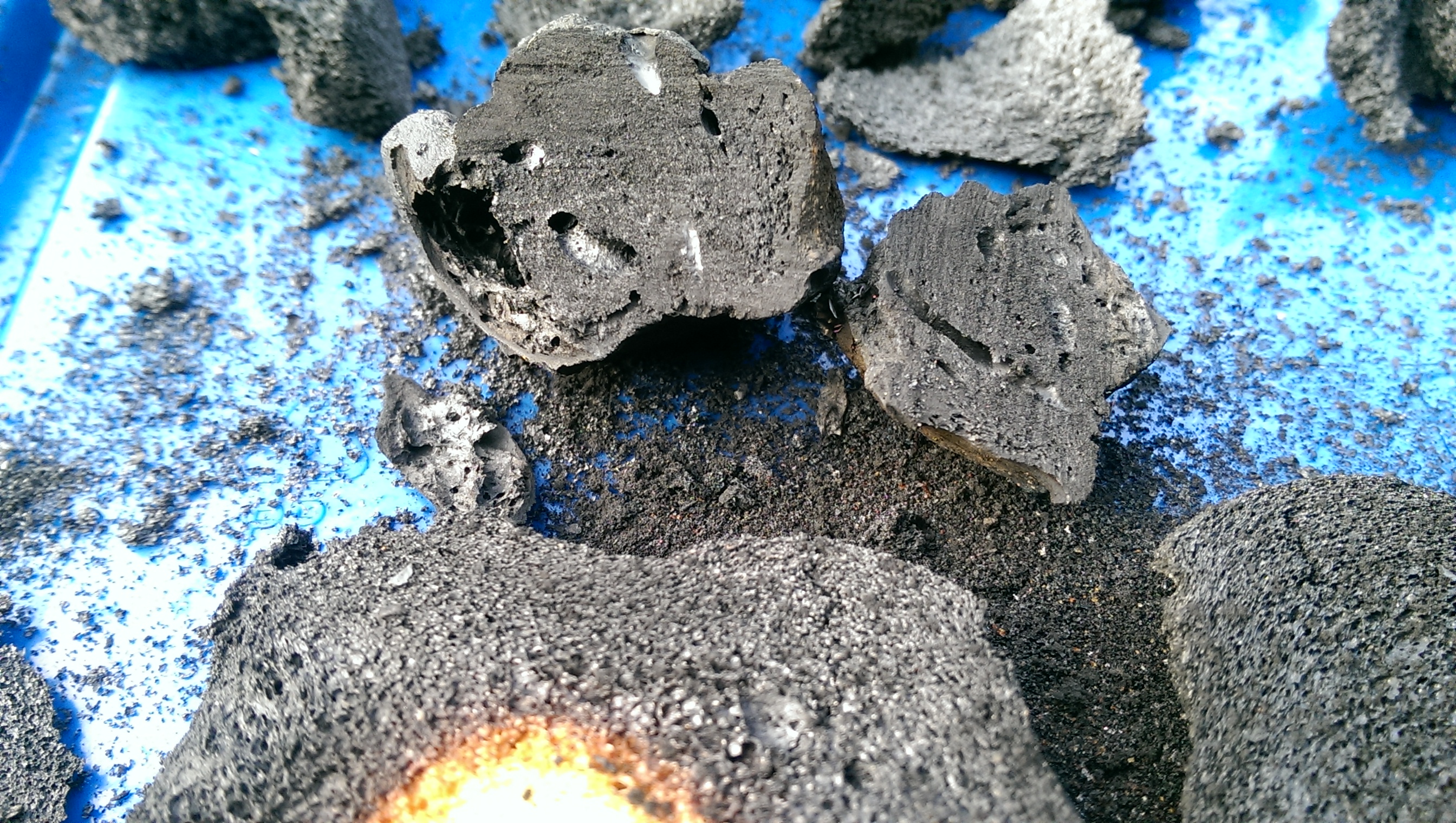

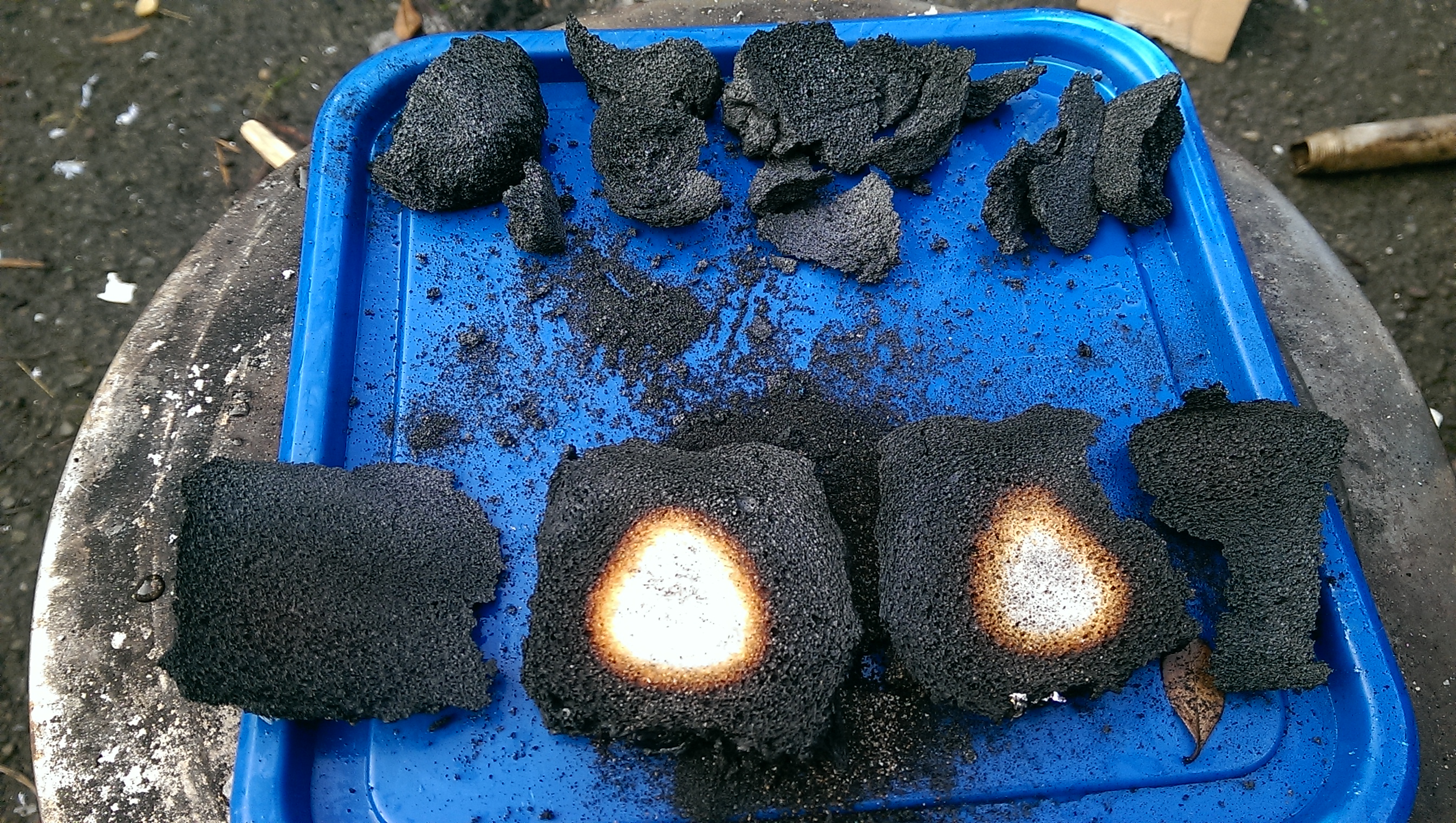

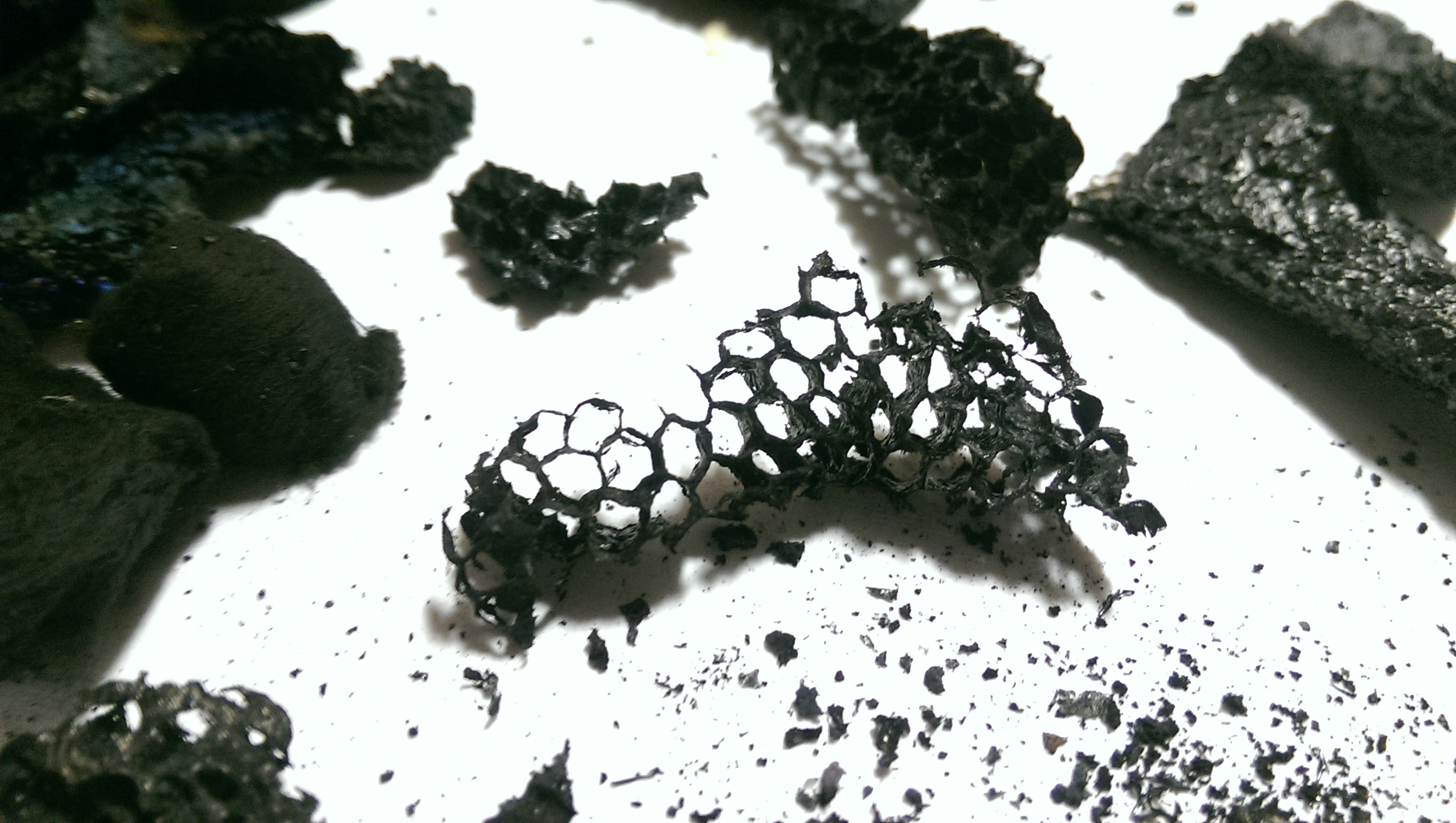

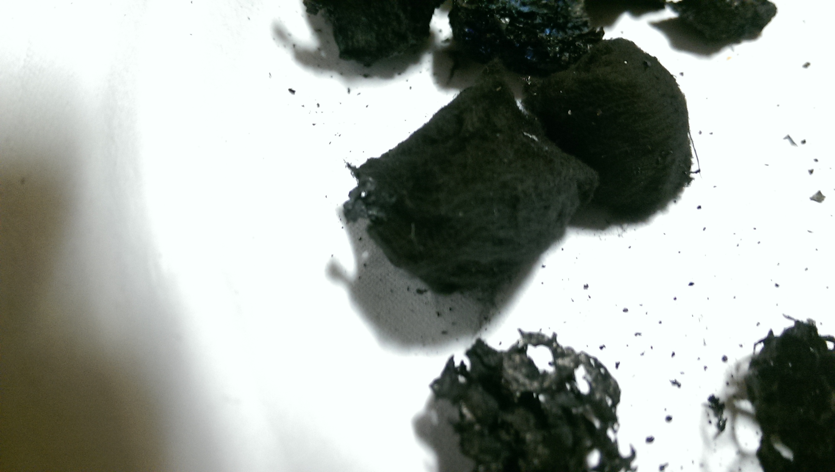

Just a touch over 2 hrs in charcoal briquette fueled heat, choked a good deal by stainless pot cover( thanks thrift store 1.5$). Results are:
control toast.jpg - 914kB Mg toast.jpg - 945kB
B toast.jpg - 926kB bannana.jpg - 1.1MB
cotton ball.jpg - 602kB wasp nest.jpg - 896kB
wasp nest II.jpg - 744kB
Control toast, Mg toast, B toast, bannana, cotton balls, wasp nest, wasp nest II.
This super cheap white bread is pretty hard without modification, the two test dopings were sub optimally attempted. Room temp saturation of well water by epsom salt and boric acid separately. Test slices were set in plastic liner and doused with each. After soaking, ammonia (10%) was dribbled in Mg sulfate side to ppt. Mg hydroxide in bread pores. No attempt was made to wash, but it was drained. Then both were set in aluminum boats on top of my stainless cover to dry a touch. Probably stupid as it soggied them up too. Pre-charred bits of sourdough were dosed with each dopant in a similar manner, except this time the boric acid was dissolved in MeOH. Both dried with white staining.
The boric acid toast doesnt seem to be noticibly affected structurally. Perhaps a touch softer. The Mg(OH)2 toast seems a touch stronger and the pre-charred seems noticibly stronger/slightly heavy.
The cotton balls are nondescript, charred all through, still feel roughly the same. Nice because they offer a compact/moldable shape(pre fire) and are absorbant. Could be fun on a few levels.
The bannana was on a whim, figured they have a ton of fiber. However shrinkage leads me to believe that freeze dried would be the way to go here. It looks pretty structurally sound, but like water loss defeated this on shrinking as it cracked but bits were strong. It also had a nice blue tinge fading to gold in some areas. Ravens feather if you will. The center was more large pores and the exterior had smaller fiberous areas. Could be really cool if structure was preserved in cooking = freeze dried first. Not in my capability.

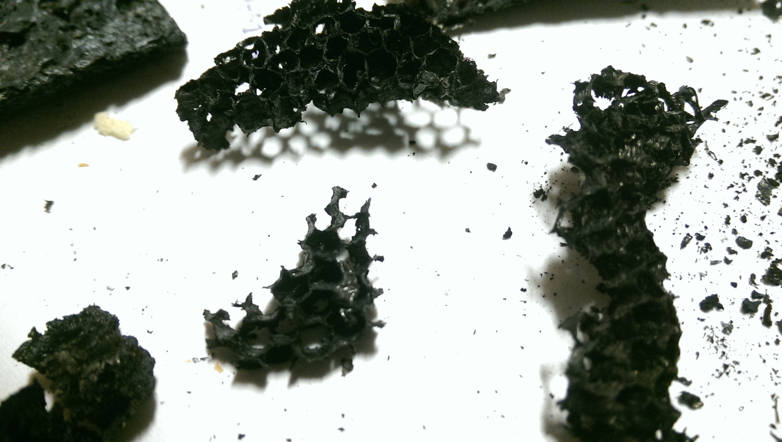

And my favorite effort, a portion of a yellowjacket comb stolen from a colony dying back for the season. All empy celled and unattended. I failed to safely cook them. Like an idiot, I pulled the tin out by had when nothing convienient presented it self to aid extraxting it = dropped from 2" up and fell over. ALMOST made it, lol. But the sample survived enough to see structure was preserved, surprisingly strong and dellicate simultaneously and easily catches a breeze.

Wasp nest thing opens more windows. Hard to come by and delicate, though many other natural shapes are more common and robust. If the back closed portion is sawed off, as I did, the open nature, low air resistance and relative strength in that direction could make effective catalyst support. Cars prove the shape is right. Nowhere near the same force could be supported, but I can see it working in some lab sized model.

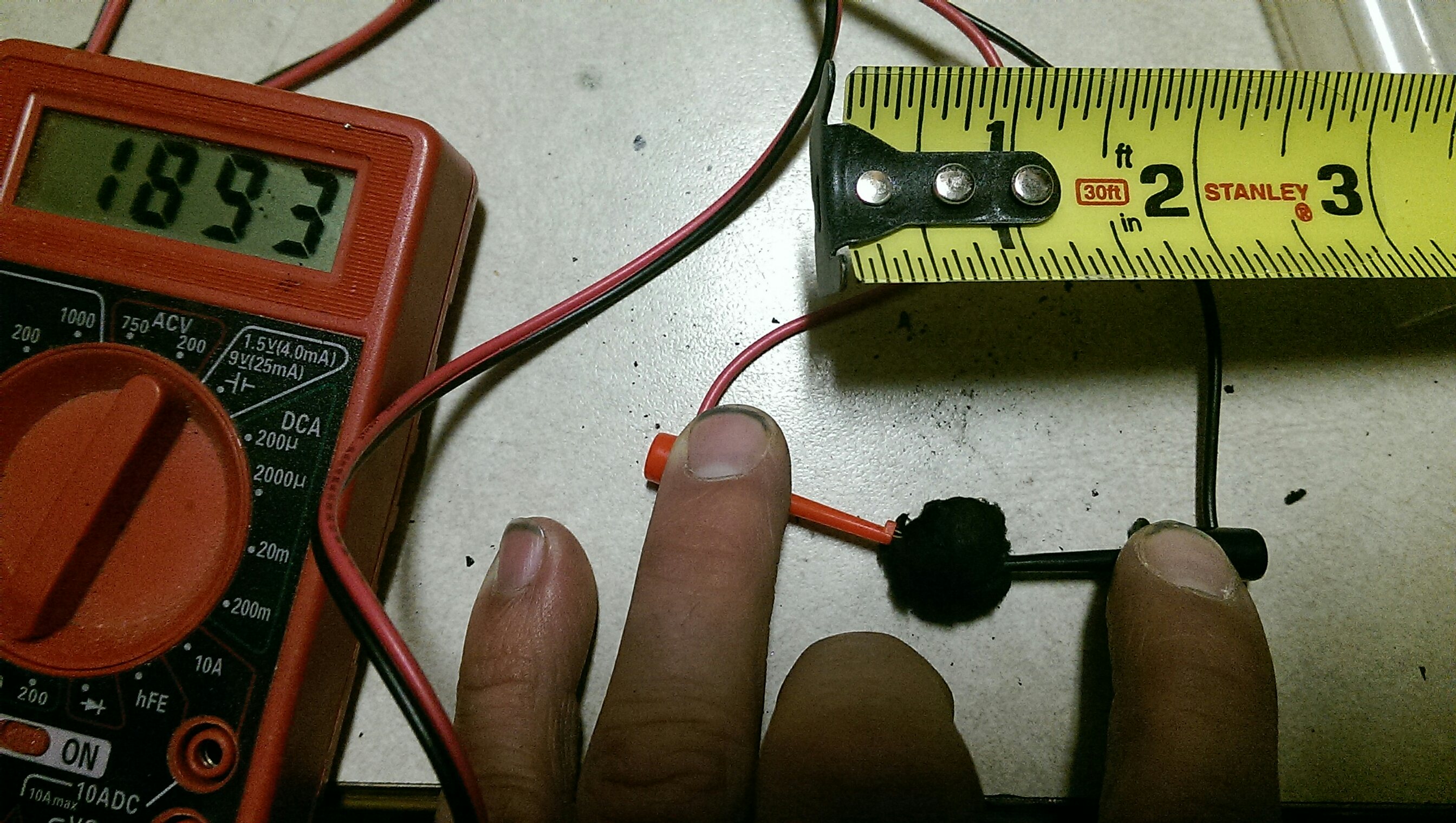

probe meter check 1.jpg - 564kBsurprising toast controll 5.jpg - 681kBIMAG8387.jpg - 741kB

The wasp nest is intriguing in that it managed to retain any shape at all.

My last Toast attempt with CaCl2 gave ~20 ohms resistance - maybe that can be improved on.

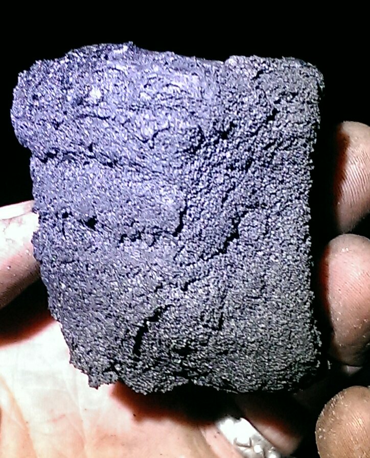

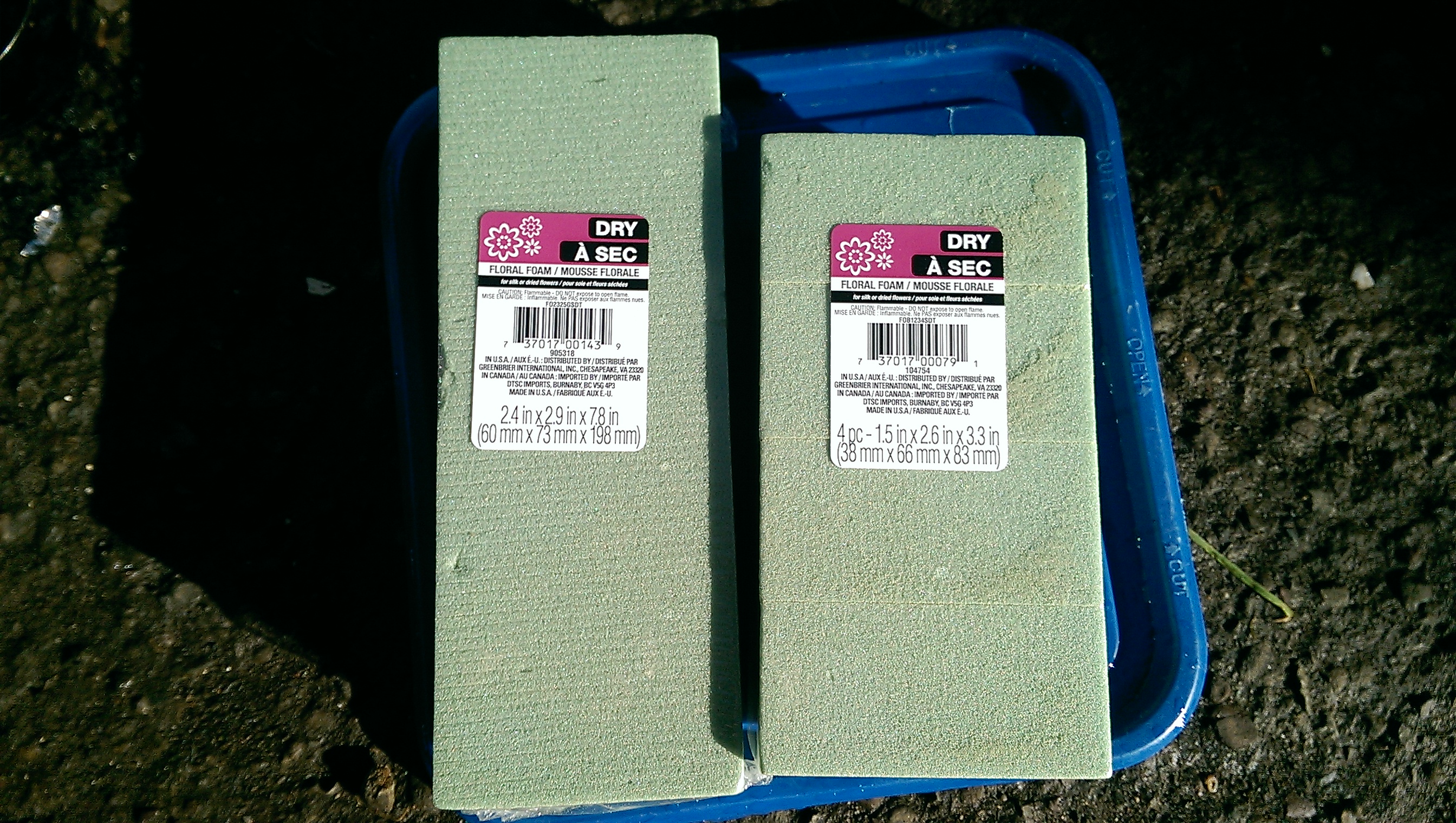

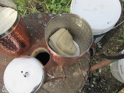

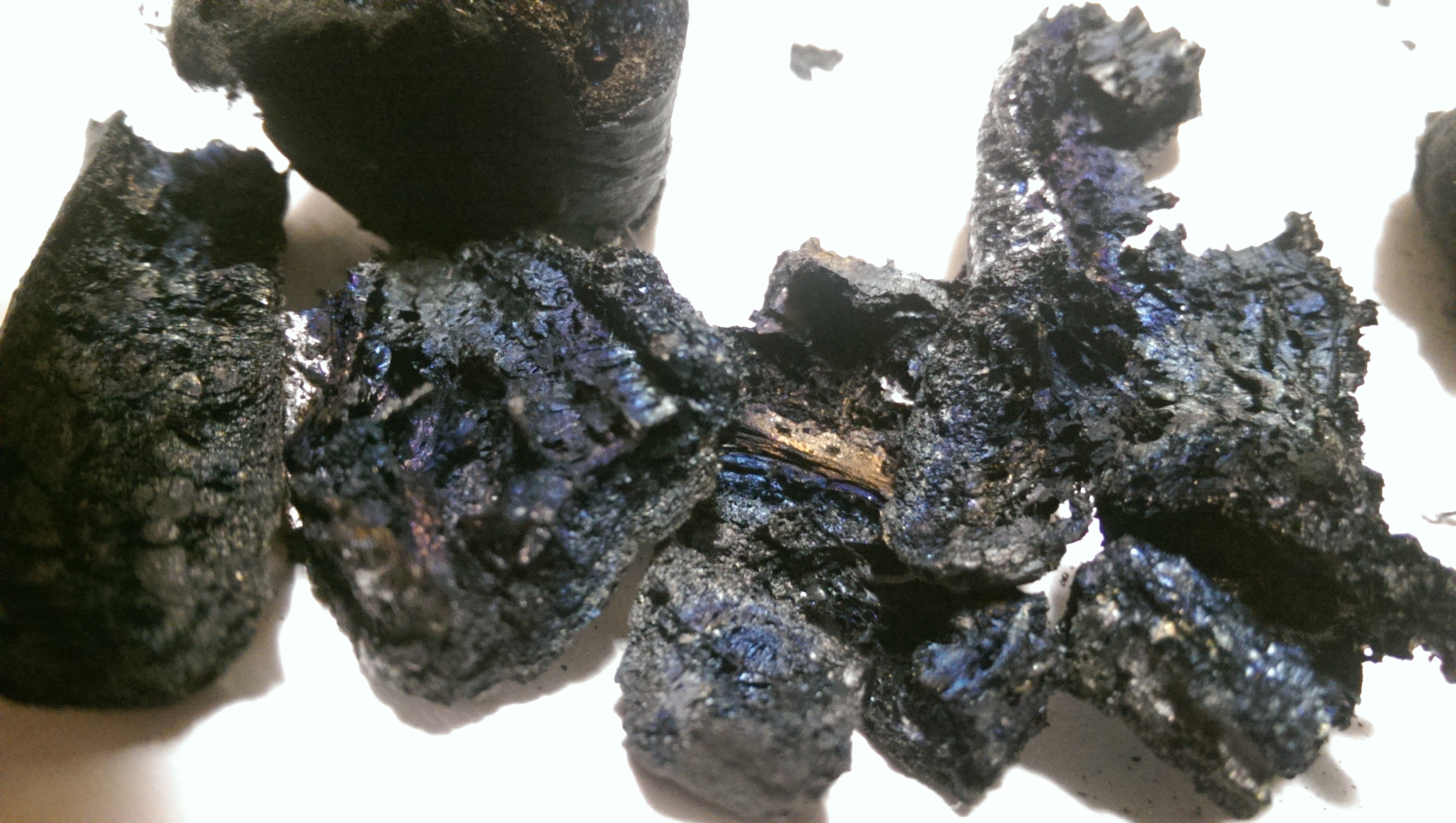

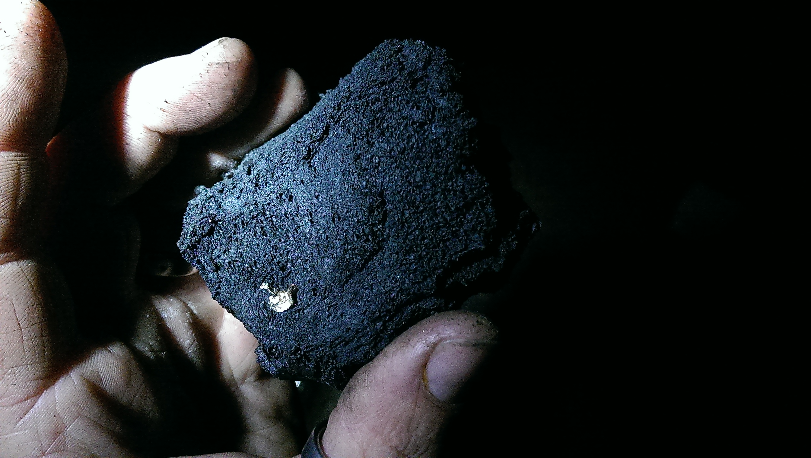

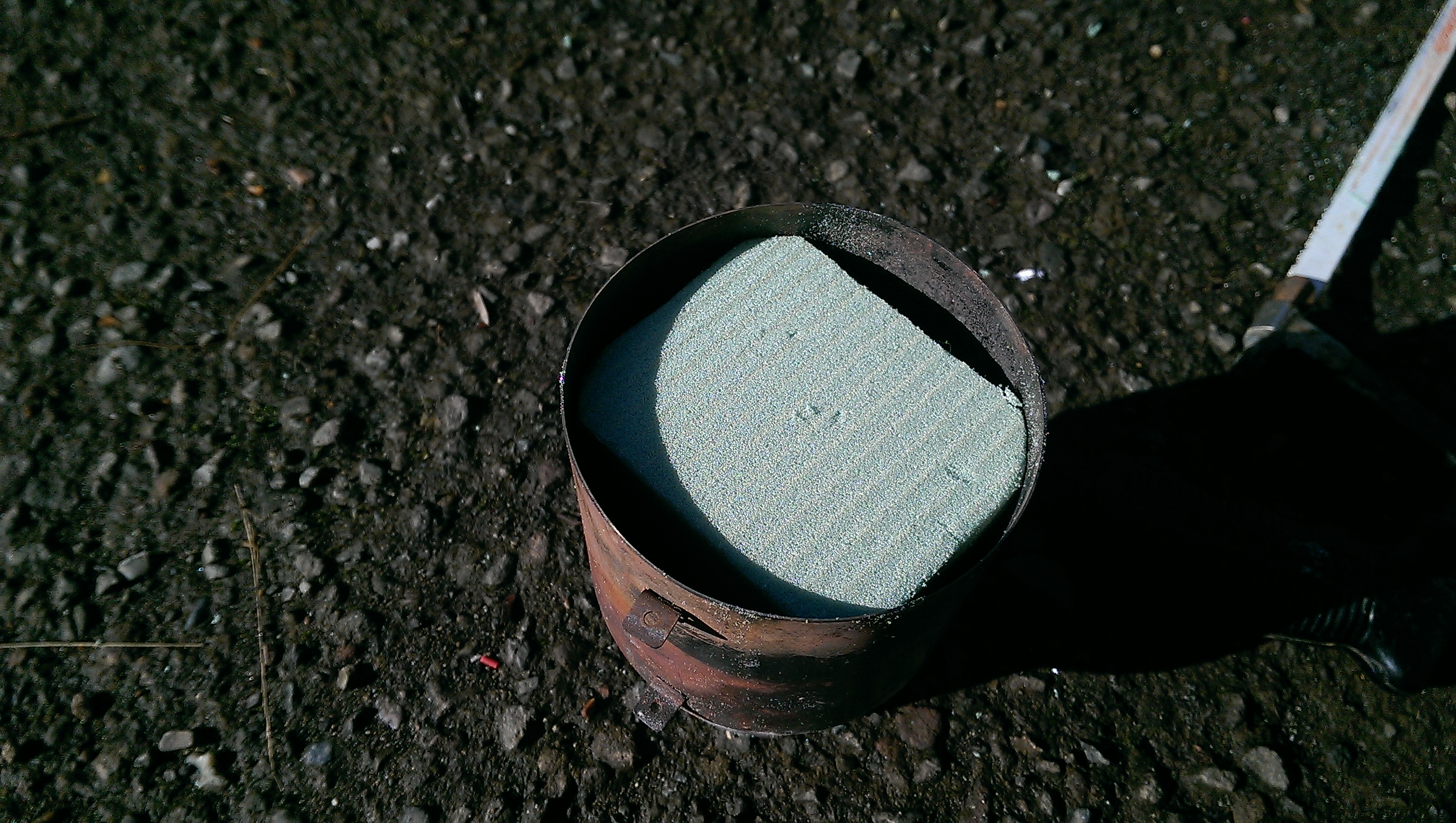

found a fun substance to try this time. Went to the dollar store again to get some little tuppers for doping trays that can seal ammonia in. Had in mind something like homogenous solid or regular enough on the individual particles, that a sugar wash might glue them. Had tapiocca prills in mind. Found green blocks of floral foam. label says "caution: flammable. Keep away from open flames"... googling, I believe they are phenolic foam, a delightfully regular, small pore, easily shaped and cheap materia. Available were one large ish block, four smaller blocks, rings or cones of which I purchased the first two.
All said and done, I have spent less than 50$ with various, and at times unneeded, dopants included. Bread cheap, cooker free, various bits n charcoal and aluminum foil for cooker <10$.
The goal for today is to try and make something actually usefull instead of testing different forms.
holy flying pyrex :) that was a crazy vid. Still wish people would seal the carbon from air while trying this...

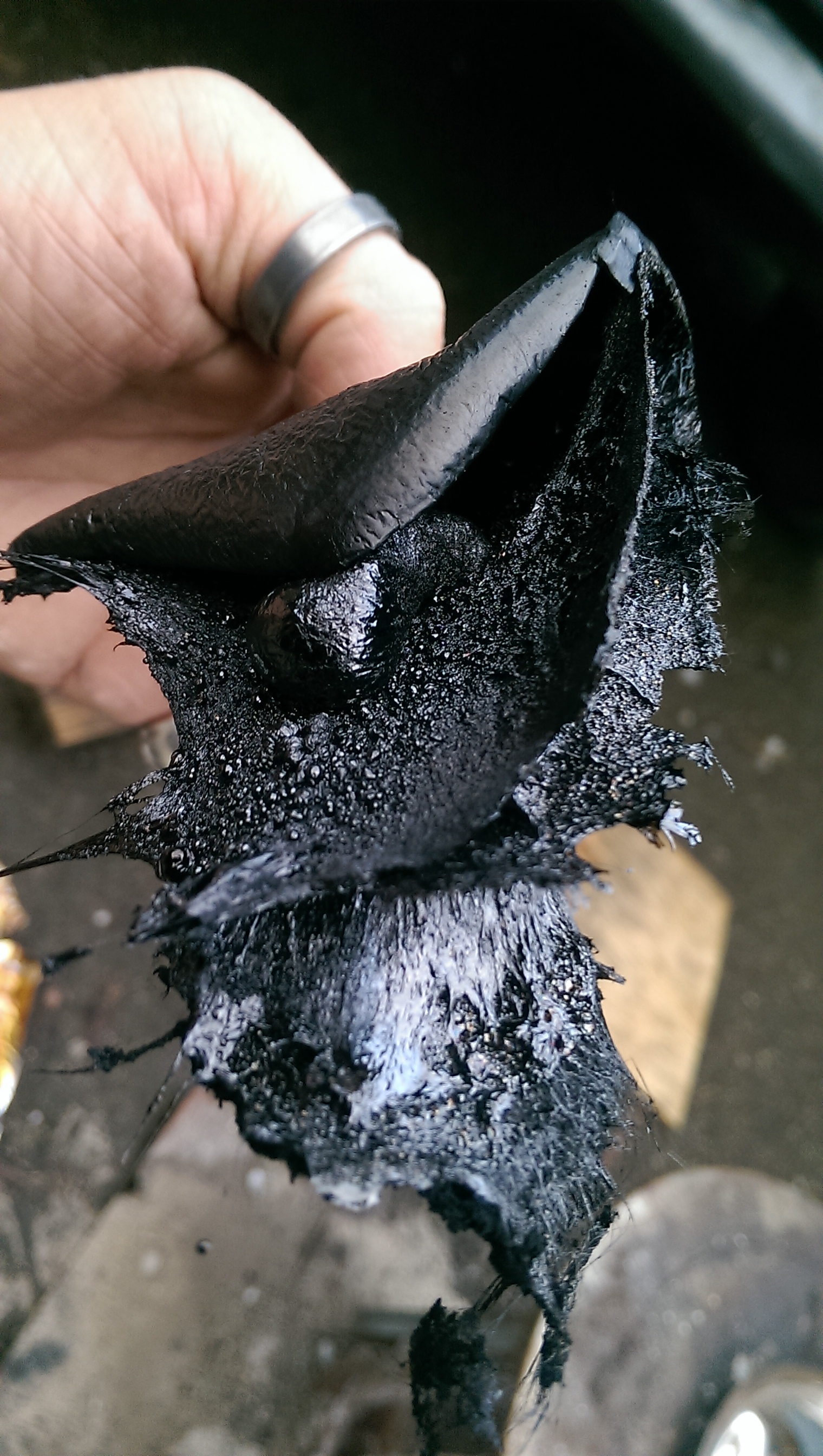

Crazy stinky fumes going on. It was quite dense and yellowish. Just stayed up wind. Fume caught fire for a bit, then seems to have subsided. Hope to be past major burn-off at the 1 hr mark now. Shooting for two like before.
Ahhh dissapointment, I know ye well. As it turns out,... my hopes of greatness were dashed. The stuff went from a block that barely fit in my container to about 1/50th of that. Bummer. My guess is that it got too hot too fast and 2hr may be too long. Reading a couple papers about phenolic foam indicated they use REALLY gradual temp increases, 20℃/hr, not possible for me in this setup. Going up as far as 900℃ like that, then 100℃/hr to max temp of 1,400℃.( the max temp checked, min was around 350℃). But still it reflects a slow transition.
On the bright side it is porous and wettable, so doping is a possibility.

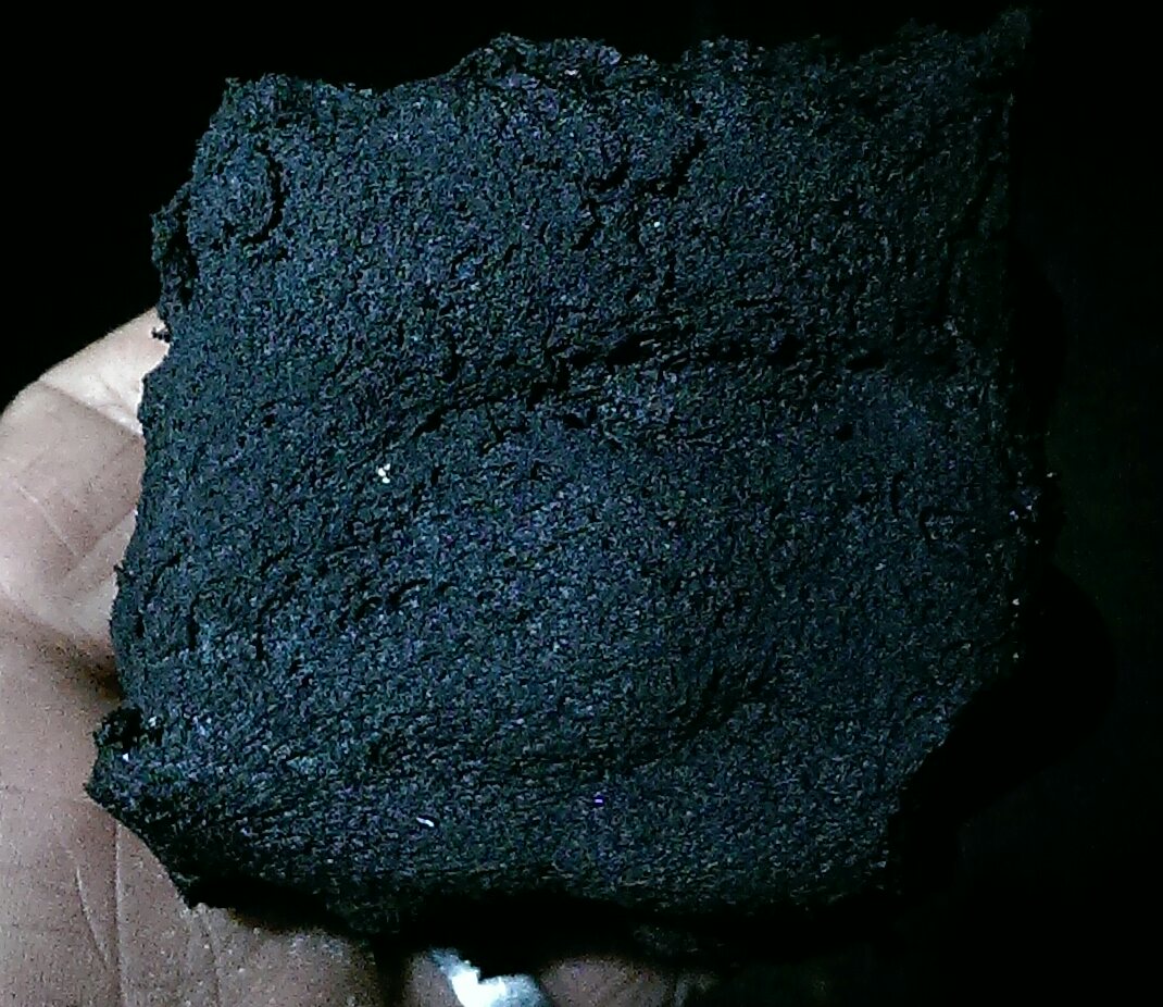

IMAG8391.jpg - 1.7MB IMAG8392.jpg - 1.7MB IMAG8409.jpg - 1.1MB
1) as bought, 2) stuffed in, 3) remains
There was a paper divider which the mass stuck to. It is quite fiberous where it stuck to the walls and paper. Side note, cotton covered in sugar water seems sturdy. This was on the other side of the paper divide. Cotton wrapped around stainless tube, covered in sugar water/sugar. wont come off the tube easily.

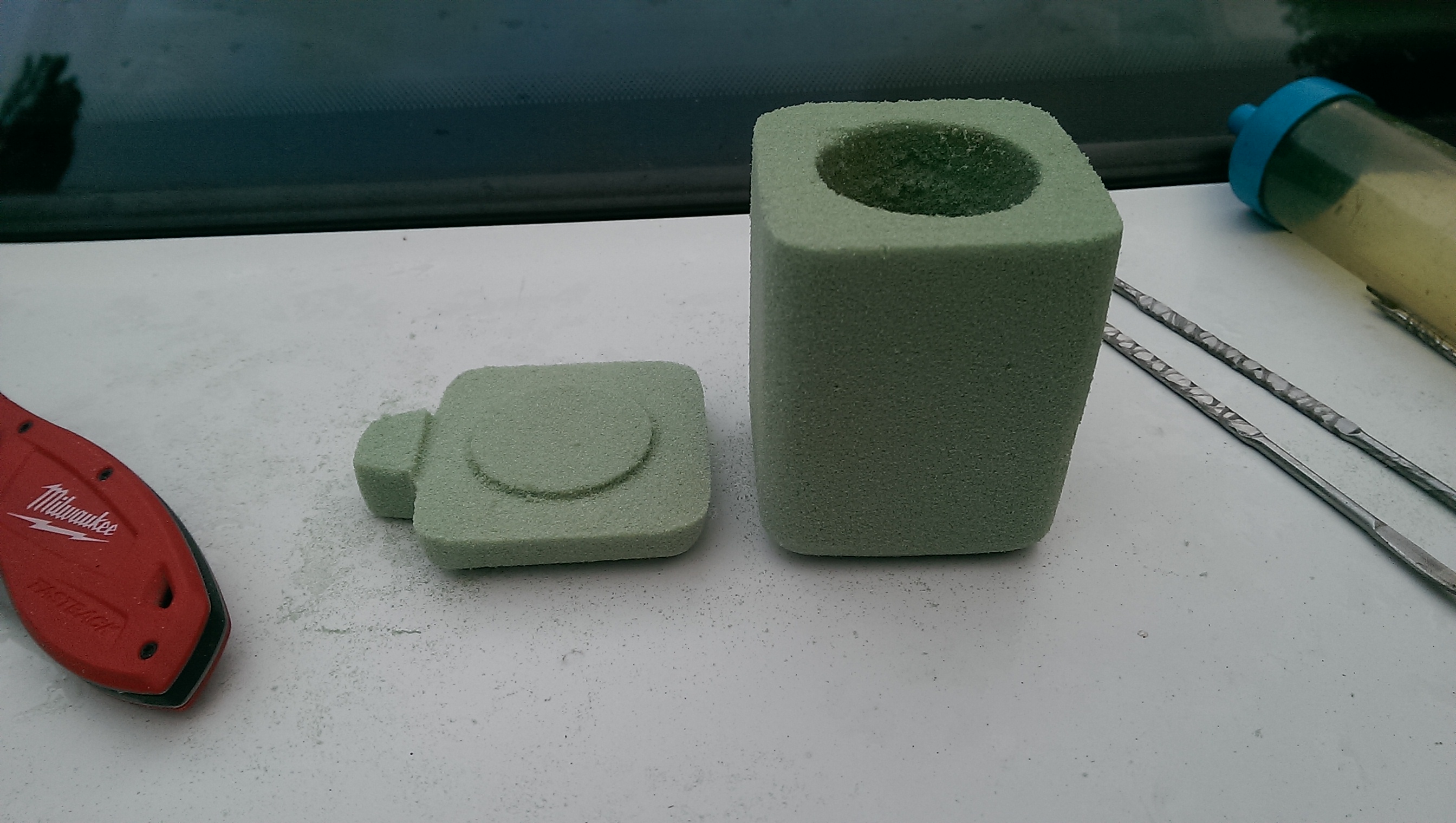

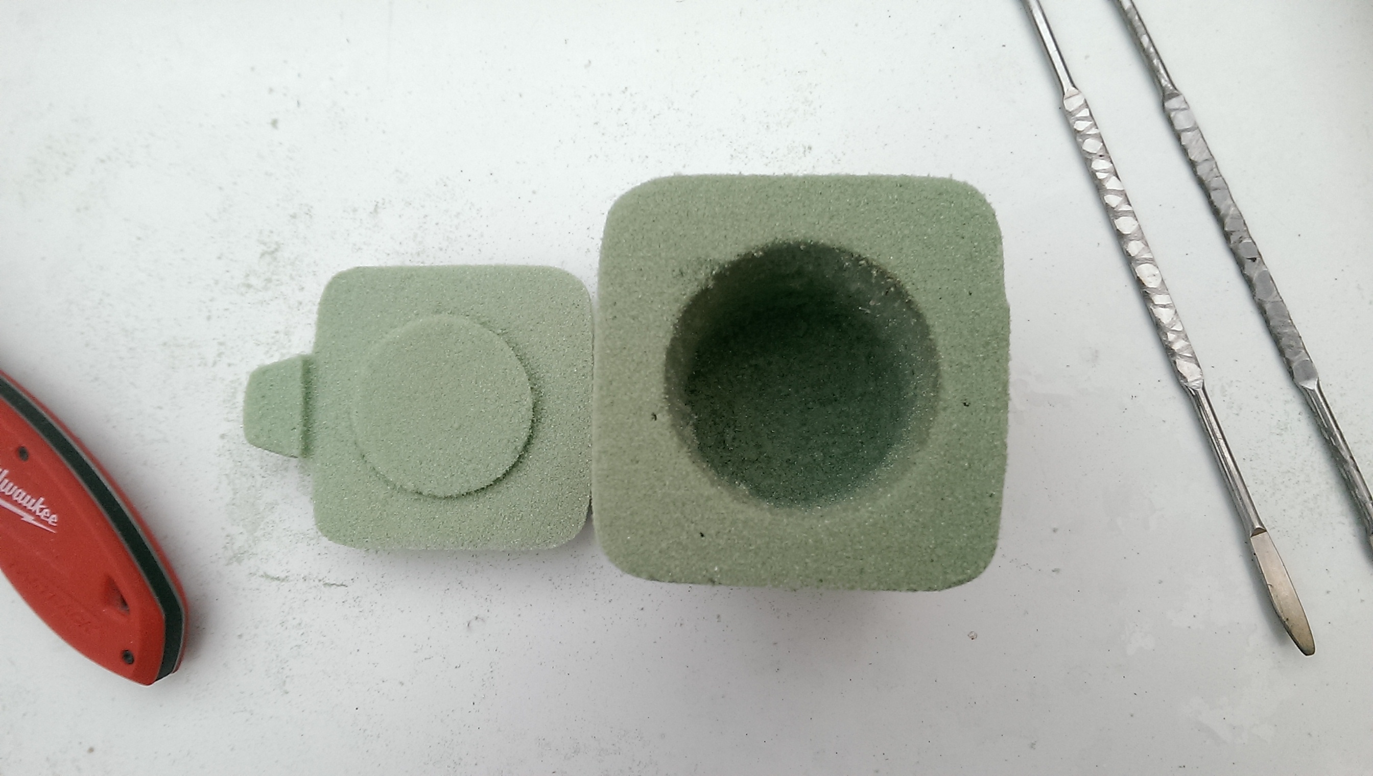

Spent the time to carve a nice crucible and lid in preparation for a sucessful outcome. Set back to trying samples with reinforcement to see how to modify it to save my effort. Something to give structure but not close all the pores. Dissolved cellulose maybe?
IMAG8402.jpg - 914kB IMAG8403.jpg - 862kB
Foam test II: another as purchased small block aranged differently. some wire mesh was added like a hammock across opening that keeps the SS cup about 4" above the coals instead of dirrectly on. Coals are dying out some anyway, as the rain starts again. It was also wrapped in foil inside the cup with a bottom spacer.
The crucible I hope to save just fits in the tupper so a dosing is possible. Blue copper/ammonia complex is waiting to eat cotton balls, but I have major doubts I will get an acid wash too deep in the pores. So may just ppt cellulose on outer edges. It may also attack the resin. Unknown as of yet. Small bits will be tested if I can. Running low on charcoal and time.
___________
1 hr residence of second foam block ~4" above coals = no physical changes apparent. Still green and new looking, but the odor isnt plesant. I added the last of my charcoal, lowered the cradle some and set the SS cup against side of cooker leaning on the cradle. So it is closer, like 2-2.5" above coals. Maybe 3" considering the spacer, between foam and coals.
Looks like a narrow window between nothing changing and failure.
Another hour and perhaps 30-45 min elapsed at the lower position. Was raining so left it past the timer. Nada, no change again. Green and new looking. Last of coals burning out and time to put stuff away.
I find this quite frustrating. Most papers on reinforcing phenolic resin foam obviously do it in production, not after the fact. Seems like a usefull product if it would carbonize like bread. First attempt at schweizer's reagent has littile visible effect on cotton or paper towells, nice blue though. Material for second attempt is settling after first rinse. See if it does any better with a stronger sollution in terms of copper present.
Could just be a dead end for my equipment as I still need to find the sweet spot temp wise even if I do manage to strengthen the stuff. Low temp decomp of additive, prior to foam failure is required. That will be some stinky science to undertake. papers suggest phenolic foam may be stable to 200℃ so a long roasting around 150 with starch is an option. Prob need that just to drive off the water that put it there. Could also just lead to a condensed wad of crud as they shrink together. Fast and cheap is the goal here, not mind numbingly time consuming and frustrating. Then again, if something this consistant and available can be mastered, it will make a nice refactory. (Maybe just use poundcake and forget this mess)

The green stuff is called 'Oasis' and is used in flower-arranging.
A bit of googling and it seems that 'Oasis' is a 'phenolic foam' which can be a bit of a mix of stuff.

Phenols are awfully stable. Could be a lot of the structure just de-polymerizes and gets emitted as vaporized phenol.
This is a guess.
However making phenol by potassium fusion at around 300C used to be a common organic chemistry class lab assignment, so the stuff really holds together at high temperatures.
Don't know what vaporized phenol smells like, but if memory serves phenol can corrode flesh without causing much pain, so be careful.
The MSDS for this stuff doesn't look too bad, but they're not really addressing destructive distillation.
BTW: You have impressive foam carving skills. On first glance at that picture i thought, "Where did she buy THAT?"

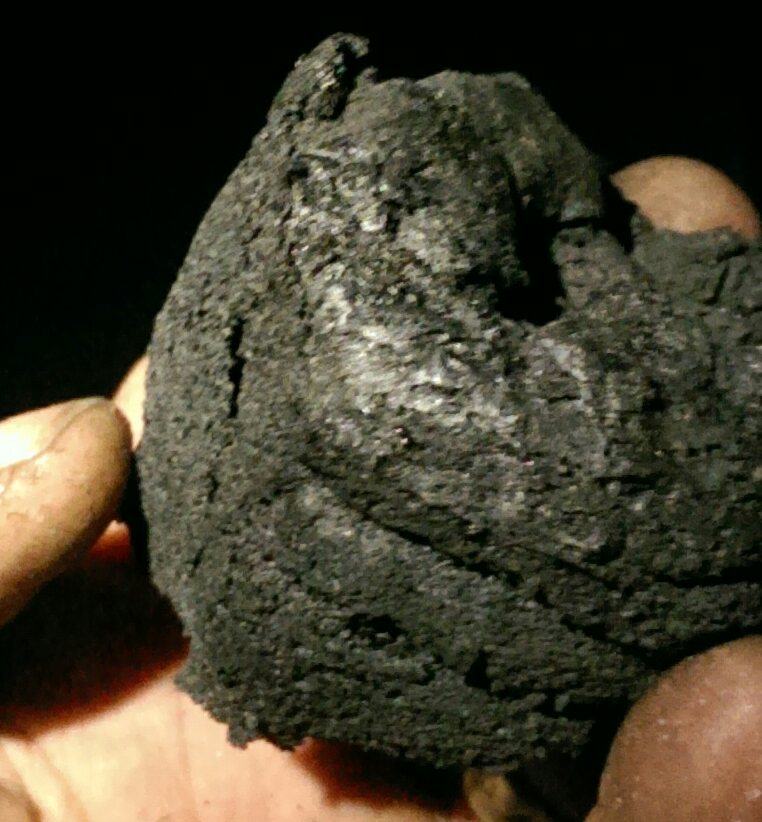

Yes sir, I have a nice size beard. But of course no ofence was taken. Not much time today, I did get charcoal and a cheap angel food cake.

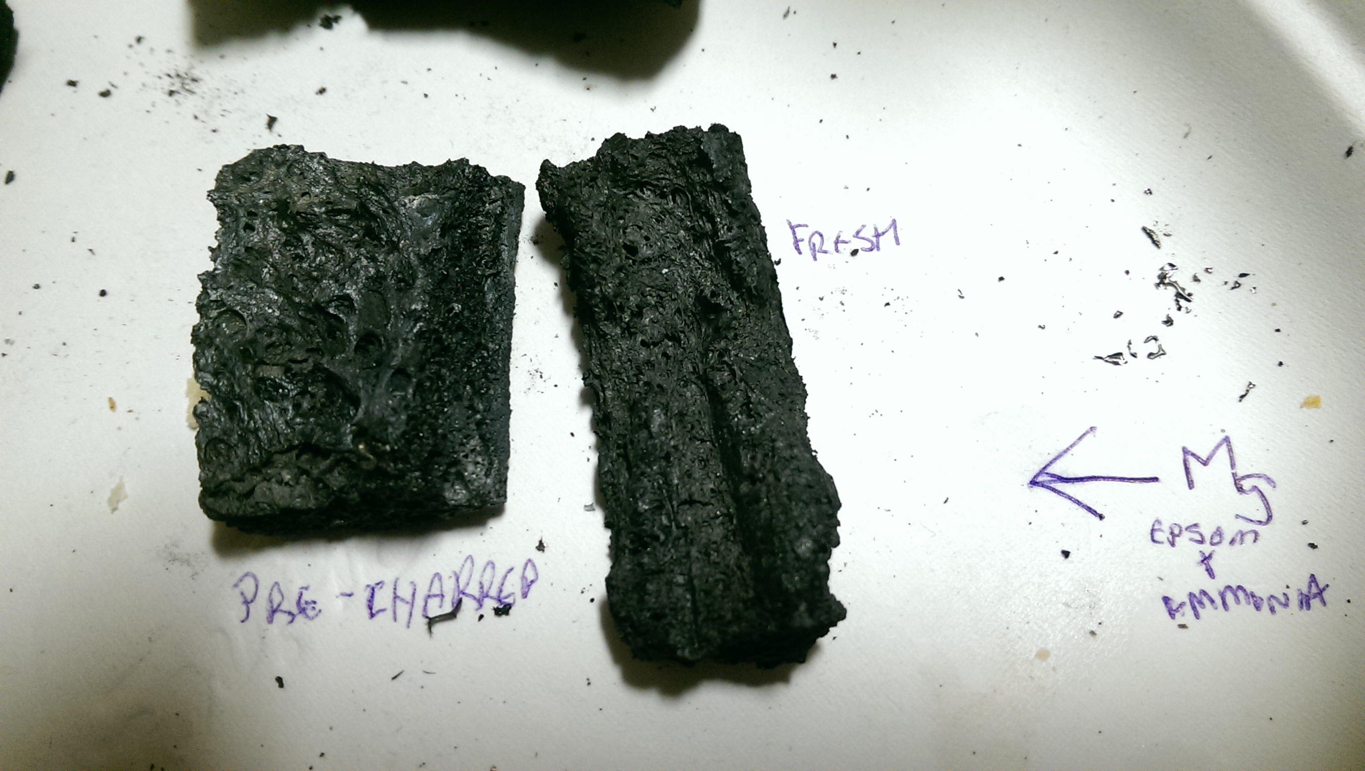

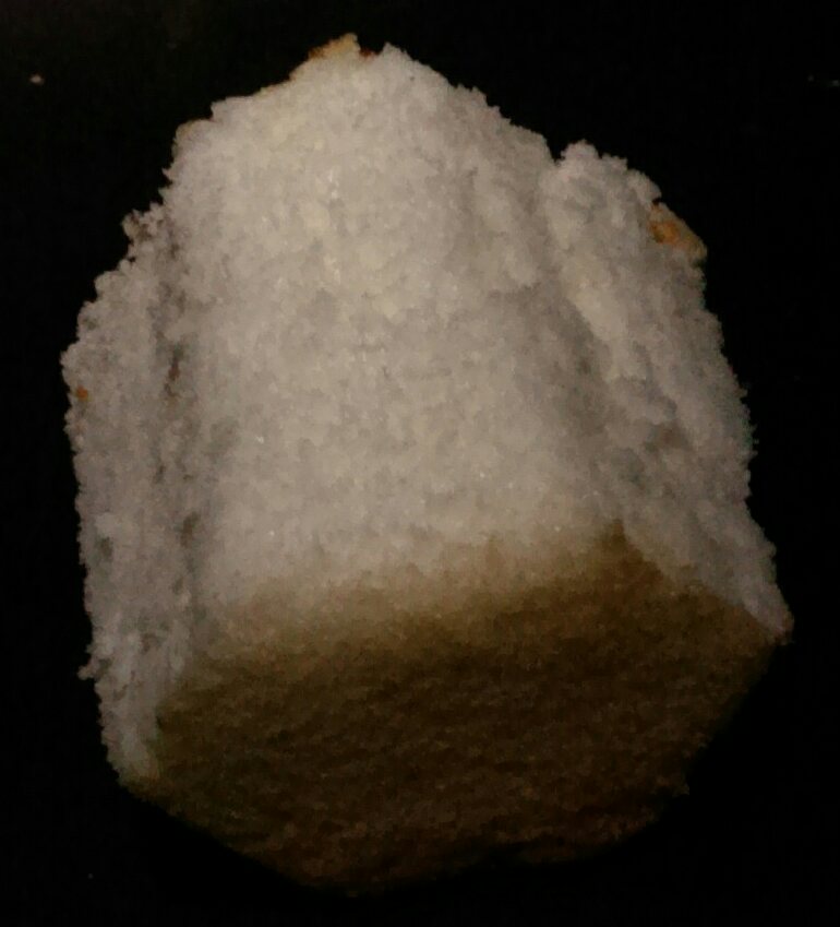

Today's charcoal was the lump mesquite natural kind. Just chared wood bits of various size. Harder to estimate fuel use and heat and still its pretty easy to eyeball a comfortable hot but not blazing temp. For any one keeping track I bet single press lump stuff would be easier to record.
The first run was 2hr usual but had a slower start as the cup went in right when the fire started, no preheat. Results were actually quite strong where it didn't stress crack under strain. Kinda spawling off shallow flakes were noticed.

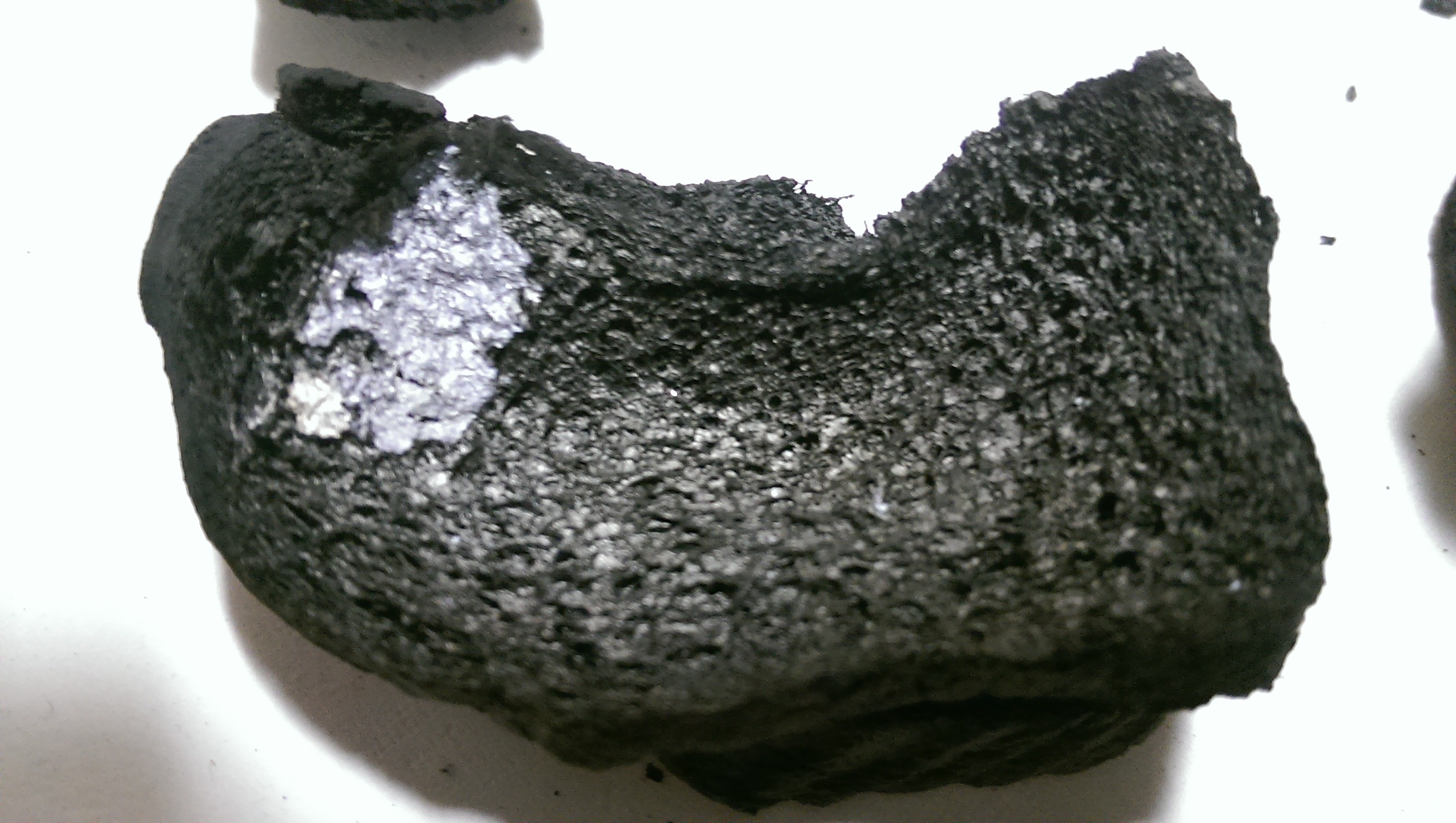

angelfood 1b.jpg - 59kB angelfood 1c.jpg - 181kB angelfood 1d fractures.jpg - 103kB
The second run, I considered why not for a shorter duration. Wanted to take it down to one hour and see if I could still get stiff carbon without breaking, but went for the safer half hour. If it were only partially carbonized then maybe a 10-15min break might ease strain. But it was already carbonized, with less cracks on first inspection. Have not had a chance to cut either yet or any other testing.
angelfood 2_1.jpg - 224kB IMAG8443.jpg - 1002kB
Pretty regular, shrinks a noticable amount. Not too bad. More work will have to wait. Cooking a chunk of bolete stem, check tomorrow.
IMAG8447.jpg - 2.1MB IMAG8448.jpg - 1.9MB
1) two hour angel food top, one half hour bottom
2) close up of knot of bolete stem above the half hour angel food cake
So the fungus bit makes it aparent that nature is far better at this than a baker. I have one in mind to fell

Cotton fiber chars right up nicely. Iv'e been busy with work and fam, had to settle for reading this last week. Had no phosphoric acid, so bought ospho corrosion stopper. 45% phosphoric acid + dichromate, the green stuff. Also bought concentrated sulfuric drain opener( remembering the sugar demo from middle school)... It does not play nice with fungal tissue, leaves a liquid suspension instead of preserving any form.
I did manage to fell that massive bolete, froze the cap and stem separately. Trying to find a way to freeze dry the some'bitch. But it will take a large pressure cooker to take the cap whole, and my vac is weak. Gonna ha e to keep that in the freezer untill arangements are made.
Super time crunch right now, check back in later with other thoughts, tests and results not listed.
it was noted that you said wool. I drew a correlation to cotton as also being thin and dainty material. yet it carbonizes nicely.

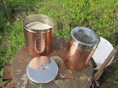

Lidl have finally decided to stock a stainless steel carbohydrate pyrolysis kit with 2 reactors for €8.99 (just need to drill holes in the lid).
They also sell the raw chemical feedstock (bread!)
tins.JPG - 92kB treated.JPG - 72kB
The jar on the left has about 6 slices of a Bimbo bread analogue in it, the smaller one on the right has 2 slices soaked in a Zn(NO3)2 solution.
smoke.JPG - 78kB
Simply stuffed both tins into a charcoal fire.
Overloaded i know, as the tiny barbie is way too small for both tins.
flames.JPG - 94kB
After about 30 mins the smoke coming out of the tins caught fire and burned for around another 15 mins.
after.JPG - 93kB
The result of the untreated bread is pretty much as expected - ceramic-sounding bent carbon tiles.
Oddly the resistance is in the 1~2 kilo-ohm range per cm.
On the first go it was at 20 ohms. Damned flukes !
The zinc nitrate treated bread gives a much finer and powdery carbon.
Bashed it up and added HCl to dissolve out the zinc.
Currently filtering/washing a lot to remove the HCl and zinc chloride.

Every time I read about this, I'm surprised that the product is such a poor conductor of electricity. Does the bread still bend if you pyrolyze stale bread?

Every batch of toast I tried to fint in several things and mods at once. After each run, I'd sum up observations and plan again. Plenty of "ideas" were basically garbage, because of impratical methods, numerous steps, poorly behaving materials and all mamer of issues. You don't want to spend all the time and 14 steps to get to nothing... But if no one does a 14 step optimization we will never know if there is a pot-o-gold at the end of the rainbow. There is NO gauranteed paycheck/prize/material there unless you a) find one through experimentation b) poorly copy some one elses hard work.
I have plenty of ideas, now waiting on ancilary equipment/chems to be made. I also tried a bunch of diff materials to get a feel for the process. Can only plan a little farther than you can see. Not everyone has the time or space to set up distillation equipment etc. Required from serious experiments. Amlost no one has a cop out excuse for putting an already owned food material in a commonly used food wrapping in an existing piece of machinery in an already functional setting. ( horrible sentance, I know, but functional in a sense). buck up, aga's got a point. This has been super fun, despair not.

It's not strictly relevant to the thread but trying to measure the "resistance" of a carbon foam like these by stabbing the two probes from an ohm meter into it just isn't going to work properly.
The contact resistance will dominate the reading.
You need to use something like this
https://en.wikipedia.org/wiki/Four-terminal_sensing
