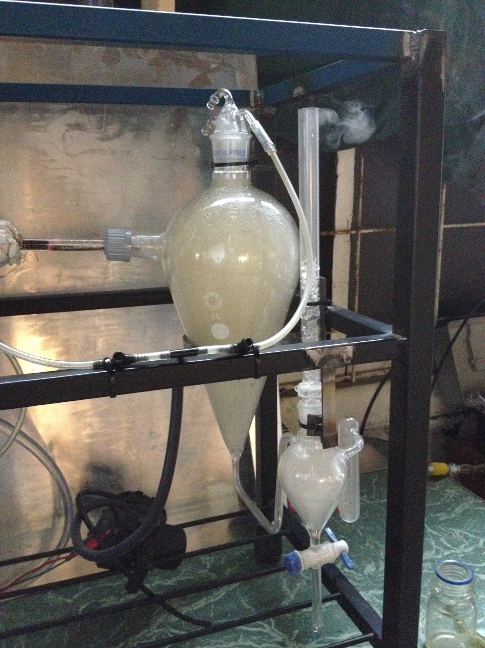

The reactor tube runs into the converted 2L sep. funnel which admits air via the custom condenser fitting.
I'm a little confused here: are you admitting air into the 2L sep funnel absorber as well as ahead of the reactor?
This shot shows where the ammonia air mixture is fed into the reaction zone, the nice red glow is transmitted up the quartz.
Clearly you are admitting air here ahead of the reactor. I assume this is the slightly pressurized source from the compressor?

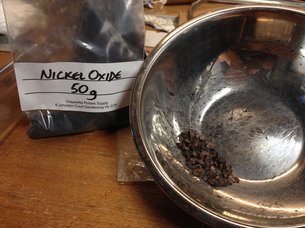

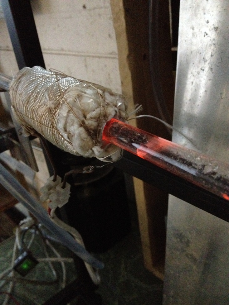

New Catalyst
Do you have any idea if some of the ammonia is able to pass the reactor unreacted? That would result in acid containing dissolved ammonia nitrate.
In the preliminary trials I did with the catalyst on glass fiber, the support melted and there was little surface area to react with and ammonia started coming over past the reaction zone. White fumes appeared as the acid and base began to react.
This happened again today as I had made some modifications to the set up.

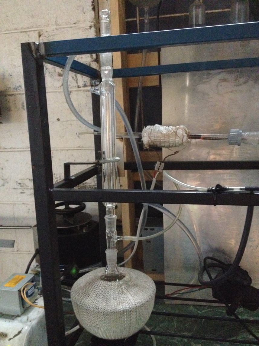

I dried the ammonia/air mixture with a reflux condenser this time and noticed there was more glow coming from the reactor and then things started to change. The oxidation chamber lost colour and there was no condensation forming. I lifted the condenser coil out and whiffed the emanating fumes lightly - ammonia. The catalyst had died.
I shut everything down and cleaned out the reactor; the support had a slightly glazed look and a greyish colour. There was oxide residue on the walls and I used some conc. HCL to remove it. What was telling and confusing was the smell of sulfide. Sulfur had killed the catalyst but where did it come from? It gave me the chance to try another variation I had in mind.
Pilot Ni.JPG - 316kB
Broken bath tile support and nickle oxide.
Pilot Ni Reactor sml.JPG - 209kB
Not only did the NiO work, it worked well. The reaction zone glowed much hotter and pulsed hotter with the higher flow rates from the air/ ammonia generator. I'd bet that this would self sustain once it has got to this temperature. Will try next run.
PilotReflux.JPG - 373kB
This is the condenser to dry the ammonia/air stream.
The pulsing glow happens due to the concentrated ammonia solution in the condenser falling back into the flask as drops, the cold concentrated solution emits gas as it hits the hot solution of urea.
The dried air/ammonia "burns" hotter than with the water rich vapour I was using. 1- it meant the high temperatures could have caused contaminants in the expanded clay balls to react with the catalyst or fuse with the catalyst, killing it.
2- it makes more concentrated acid without the introduction of water into the stream.
PilotConcentratedAcidFumesSml.JPG - 474kB
Concentrated nitric fumes like crazy in moist air. The oxidation chamber was filled with acid mist this time. Concentrated acid fumes can be seen leaving the absorption tower. I now understand the need for multiple towers used in industry.
I ran out of time to titrate the product, but it took more Bi-Carb to neutralise a similar quantity of the last batch, and the tower solution gave a more pronounced reaction with bicarb despite far less operating time.

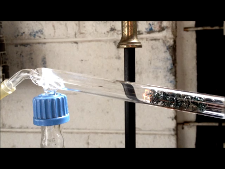

I am really surprised that copper works as a catalyst . I thought we need only Pt to oxidize ammonia.i found a link that shows copper as a catalyst . it also has videos.Link :http://www.digipac.ca/chemical/mtom/contents/chapter3/fritzh...http://www.digipac.ca/chemical/mtom/contents/chapter3/fritzh...[Edited on 9-11-2016 by ecos]
And it works too well and over-oxidises the ammonia to N2 and H2O if you recall my original assessment.
CopperNH3oxidation.png - 165kB
copper glows alright- just no discernable production of NO or NO2.
