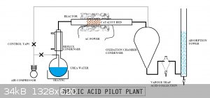

[*] posted on 30-12-2016 at 14:59
Schematic diagram
Is there a risk of explosion inside the glassware?
NH3 + O2 + catalyst may be used as rocket propellant.
I guess if there was pure ammonia and pure oxygen it's a potential risk. I'm fairly sure that ammonia in air and diluted with CO2 is highly unlikely to ever ignite back upstream.
I think I said earlier that I'd draw up a schematic.
OstwaldStyle NA Process.png - 34kB
[Edited on 30-12-2016 by Chemetix]
[*] posted on 30-12-2016 at 16:00
Nice! Thanks for this. I'm loving the simplicity.
Wiki says that the explosive limits in air are 15-28% NH3. The somewhat heated (I presume) air/NH3 mix coming out of the NH3 generator is diluted with CO2 and water vapor. Are there any scenarios where explosion is a risk that you are aware of at this time?
Chemetix
Posts: 376
Registered: 23-9-2016
Location: Oztrayleeyah
[*] posted on 30-12-2016 at 17:52
You know, I tried to see how you could blow up the system and I don't think it's easy. If you managed to fill the biggest volume with air ammonia, and somehow managed to ignite it, it burns so slowly without a catalyst, so the worst that could happen is you pop the top on the sep funnel. I saw a wisp of blueish flame try to creep back from the copper oxidised reaction once, but it stopped suddenly. I read somewhere that ammonia is difficult to sustain combustion even under perfect conditions.
Wiki confirms this:
"The combustion of ammonia in air is very difficult in the absence of a catalyst (such as platinum gauze or warm chromium(III) oxide), because the temperature of the flame is usually lower than the ignition temperature of the ammonia–air mixture. The flammable range of ammonia in air is 16–25%.[22]"
As far as a typical fuel air mixture goes, this one seems fairly tame.
And by the way- Ostwald got his process, Haber got his process, then there's Solvay, Weldon, Burton, Raschig, Andrussow....to name a few. Does this constitute a unique process by industrial standards? Do I get to name it?
[Edited on 31-12-2016 by Chemetix]
