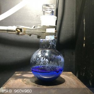

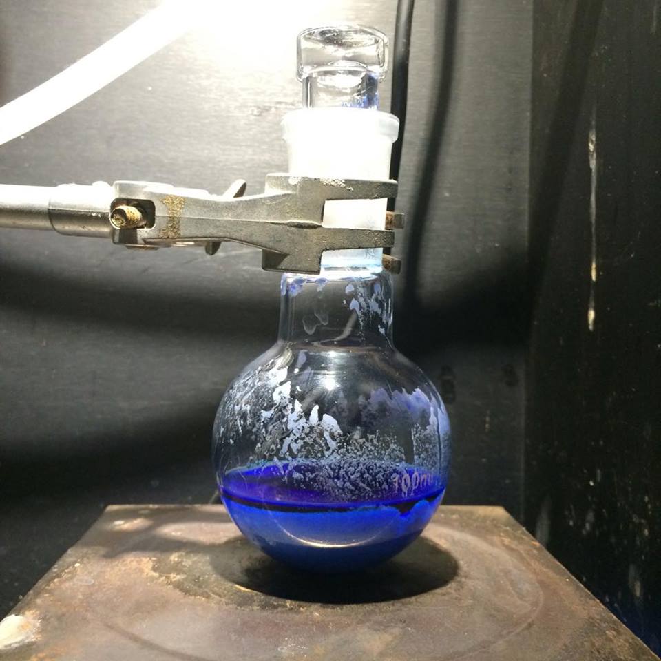

with heating and stirring the cobalt II chloride slowly dissolves and the solution takes straight a violet purple-blue colour. This means that the geometry of the molecule change from octahedral to tetrahedral
after we make second solution of 2 ml of pyridine (0,025 mol) in 5 ml of ethanol and we put this in the first solution we see that the colour not change (violet-purple-blue colour)
After 10 seconds a solid start to precipitate
The colour changes from pink to purple indicating that the geometry of the cobalt two complex change from octahedral (bigger 10 Dq ->pink-rose-red colour) to tetrahedral (smaller 10Dq ->violet-blue colour )

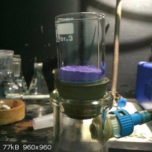

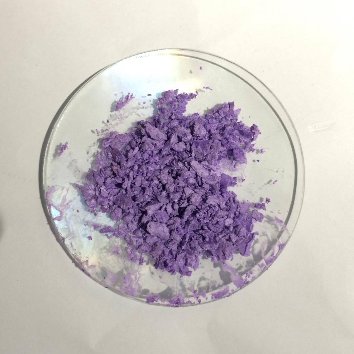

Last step after filtering we wash the crystals first with one portion of ethanol to wash away any extra pyridine . Let the crystals dry in air and dispose the pyridine containing waste properly !!!

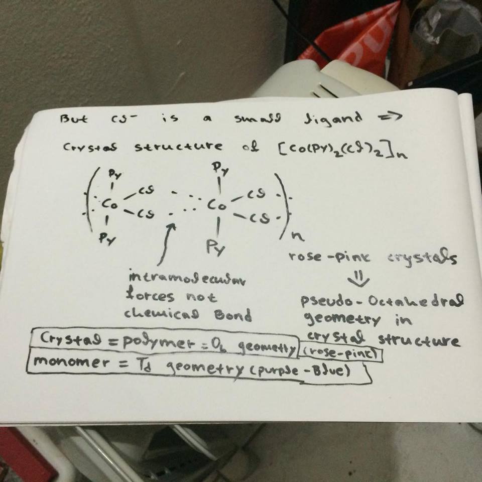

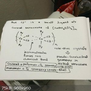

So our crystal in the end is kind of rose indicating octahedral geometry . But our compound in many solvents show a blue purple colour indicating tetrahedral geometry in the solvents (for example DCM) . So this happens because our compound when it is solvated it make particles of size of a molecule only and this has tetrahedral geometry and so a blue pruple colour.From the other side the crystal is a polymer of course and has a pinkish rose colour witch indicates octahedral geometry. This happens because in the crystal polymer the tetrahedral changes form and the chlorines become bridges joining two cobalts together forming a poly pseudo octahedral crystal structure that has a pinkish colour. To become more understandable what I am saying the last picture I uploaded show the structure of the coordination polymer .

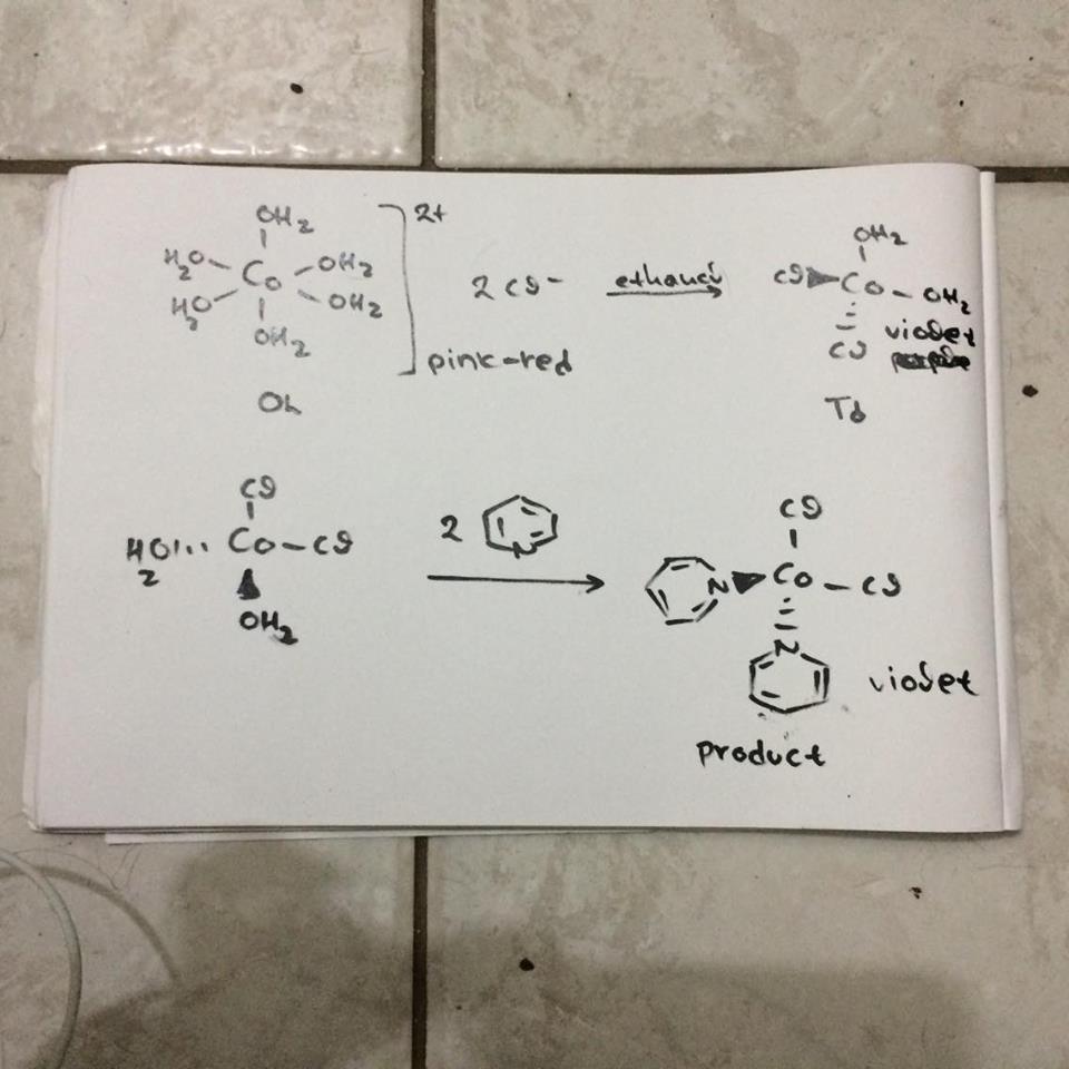

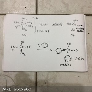

Reaction mechanisms (Sorry for handwriting and not using chemdraw and avogadro... )

Co bis pyridine bis chloride.jpg - 74kB

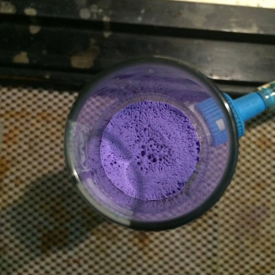

reaction mixture after reaction [Co(Cl)2(py)2].jpg - 85kB

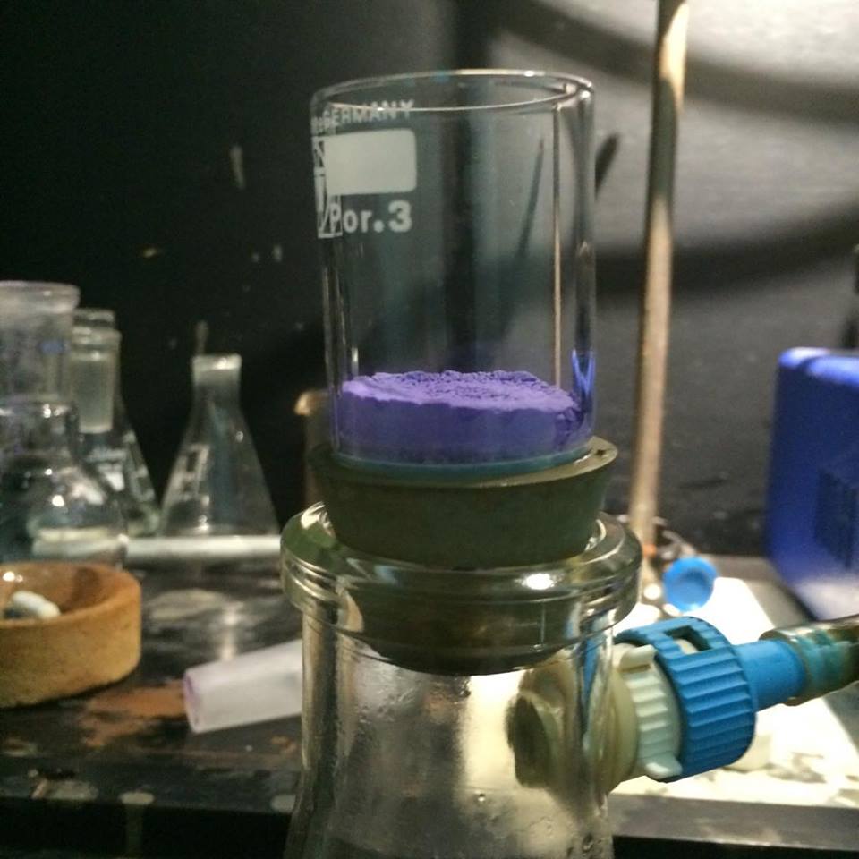

Co(Cl)2(py)2 filter 1.jpg - 77kB Co(Cl)2(py)2 filter 2.jpg - 87kB

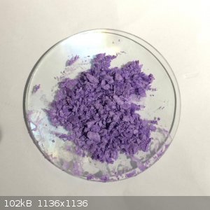

16197087_10154352102871909_1348046967_o.jpg - 102kB

crystal structure of [Co (py)2 (Cl)2].jpg - 75kB
