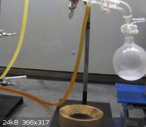

[*] posted on 8-10-2017 at 16:04
picture test
reduced size for vulture.jpg - 24kB
This works! Used Paint to reduce size of a picture that wouldn't post before resizing.

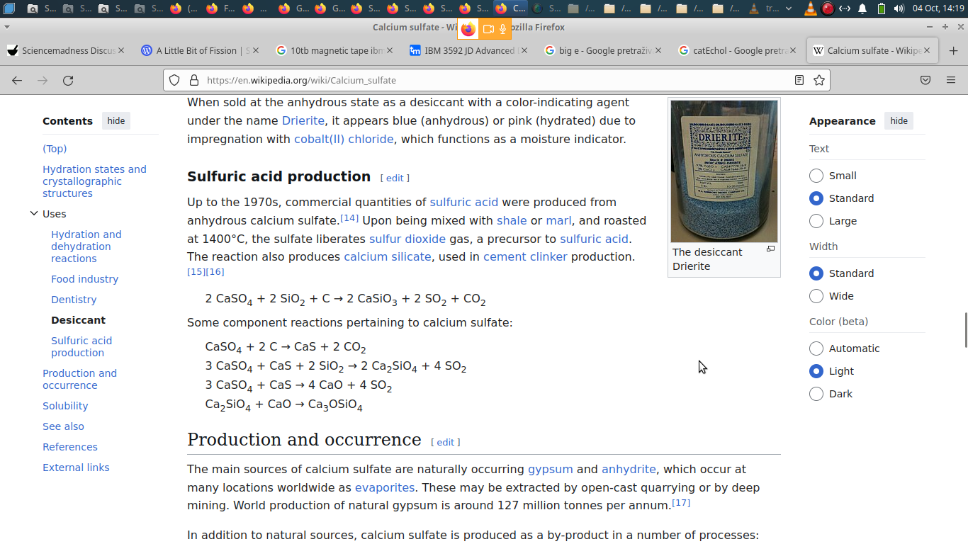

[*] posted on 4-10-2024 at 04:21
Look
Screenshot_2024-10-04_14-20-54.png - 305kBScreenshot_2024-10-04_14-19-58.png - 295kB

Quote: Originally posted by Random
Look
Yeah, so you'd end up with a partially or completely eaten RBF. Given the price and availability of quartz RBF, I will avoid that :p
But it can be attempted in a metal can, I suppose (I have powdered glass I could use for that). No temperature is given, though. [EDIT: Correction: 1400 °C, that way too high for my blow torches anyway. The pyrolysis of sodium bisulphate is complete at 850 °C. This is caused apparently by Na₂SO₄ being a weak base.]
